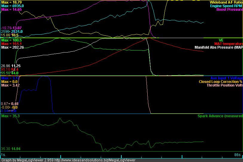

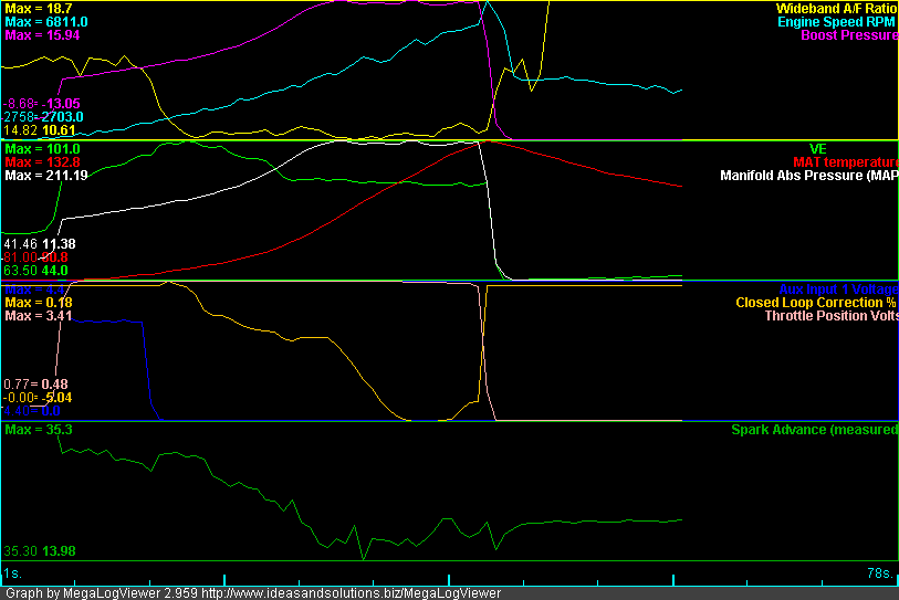

Here are three logs from yesterday. These are all with the new coils. The last one is at the higher boost level and I have AFR Tracking on.
New coils, 15 psi, no AFR Tracking
New coils, 16 psi, AFR Tracking

CajunKenny;1588013 said:
I am monitoring timing; but, haven't hooked up the control part yet. Soon though!
... when the breakup happened, the only sign of it... was a dip in rpm.
I'm not one to push the envelope; but, I love to be preventative. I wouldn't try to "cheat" by adjusting base timing; but, would certainly make adjustments to avoid detonation
. What I really need is a standalone!
Do you think the breakup is related to timing or were you just checking to see where it was at?
LOL kidding kidding...
The ignition break up is more likely fuel related and NOT base timing related.
There was a thread months back of BIC figuring out how to overcome ignition break up at 17psi on the 1jz builds.
http://www.supramania.com/forums/sh...s-and-standalone-EMS-s&highlight=BIC+ignition
After looking at the thread, I see that since you went COP too, there's not many reasons for the ignition break up.
I haven't gone the COP route so i don't have positive answers how the ignition is supposed to work, but my understanding is that fresher coils are the king pin on adding more pressure.
-Dave
EDIT:
I'm definitely not guru enough for this stuff but looking at the charts, if you compare where you let off throttle, you'll see consistent patterns where AF meter perks up before you let off and it leans out accordingly.
Intake temp starts at 60-74*f and jumps to 135*f averaged, is that right?
New coils and consistent chart patterns, i haven't a clue besides guessing your fuel may be the issue.
Lets gets more knowledgeable ppl to chime in!

Well, if you look at the last log, you can see the dip in rpm and compared to the other logs it gets jumpy in the same spot everytime. I don't know what else it could be; but, my ears are certainly perked to ideas! ;)
This rpm jitter in that spot doesn't happen so much at 12 psi and under.
One thing I have learned is that even back to back logs/pulls yield different results so it could've been a fluke. I doubt it though... If it continues, I'm going to rebuild one of my spare CPS's and install that.
