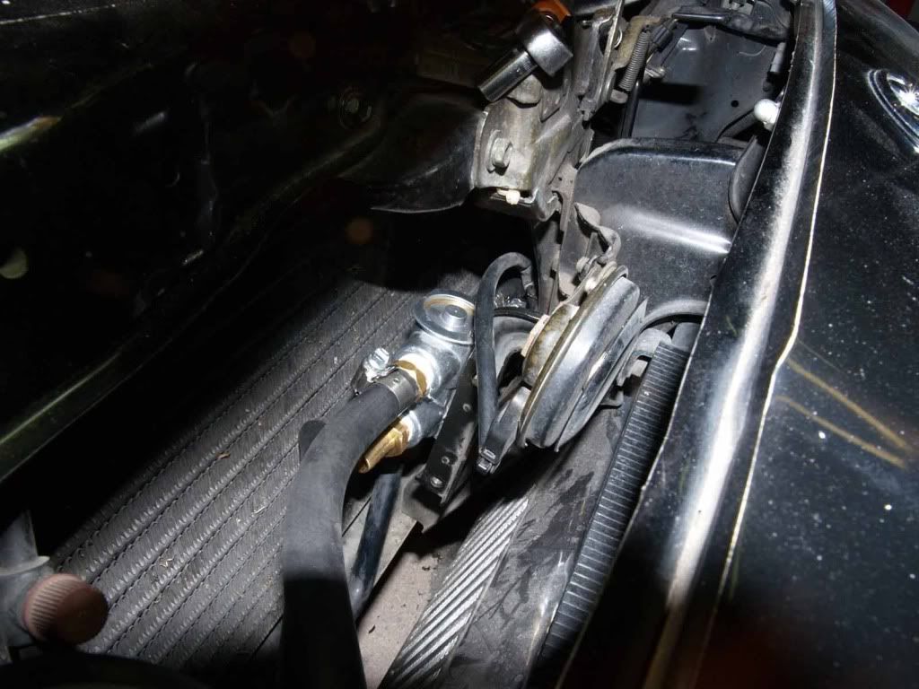

My oil cooler arrived today. So, with the other parts that arrived this week I'm able to get started mounting the cooler. Note the Oil Thermostat, Oil Cooler, and two 180* AN fittings.
Here's the first bracket. It's secured with blue loctite! :)
Here's the second brace. This one will attach to one of the Intercooler Braces.
And here she is mounted...

Thanks guys! The cooler is a 16 row and the dimensions are 11x4.75x2. It does hang a little low for my liking; but, should be ok. There's a little bit more room for a wider core there; but, then you'd be fighting fitment of the fittings.
All and all, as long as a rock doesn't puncture it.....I'm happy with it. :)

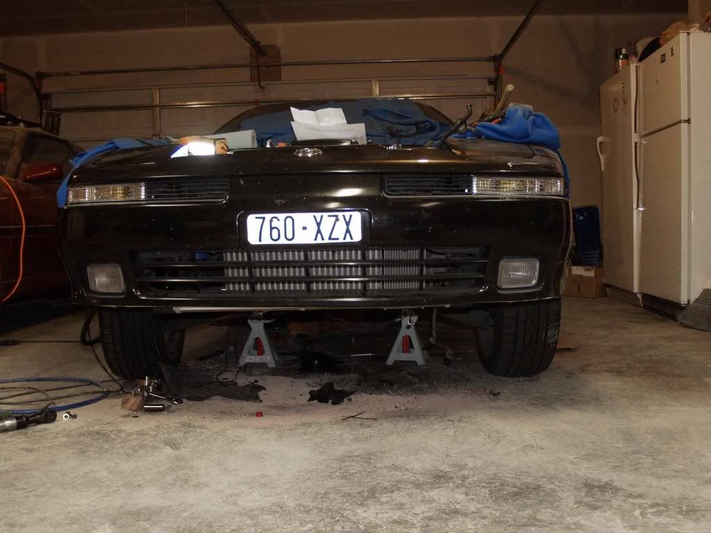

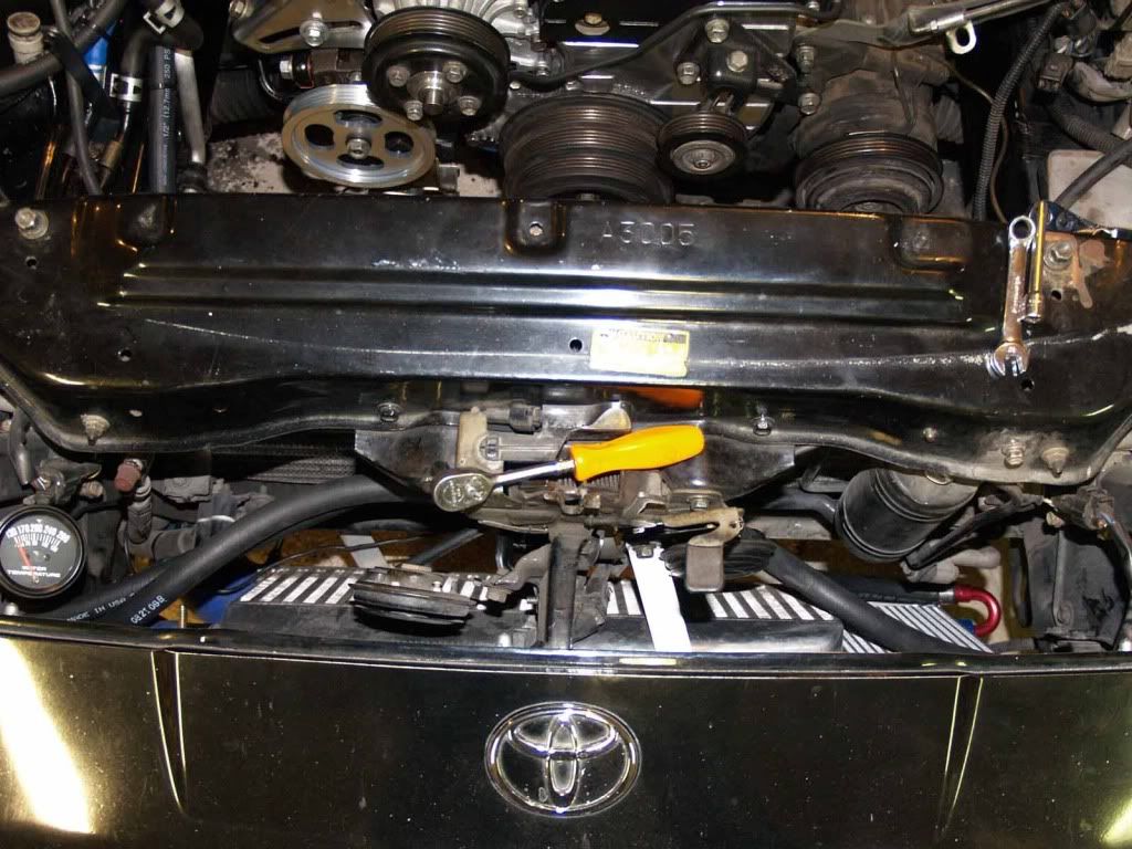

Kenny, that looks great. I love the fitment. Any chance you have a pic of front from further back? I'd like to see how noticeable it is.

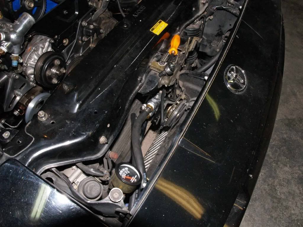

Here's a pic for you Ron. Remember...this is without a lip and you can't see it. What you'll likely notice are the little neon tube brackets. The oil cooler doesn't hang any lower that my intercooler. Once a lip is in place it'll be even more protected.

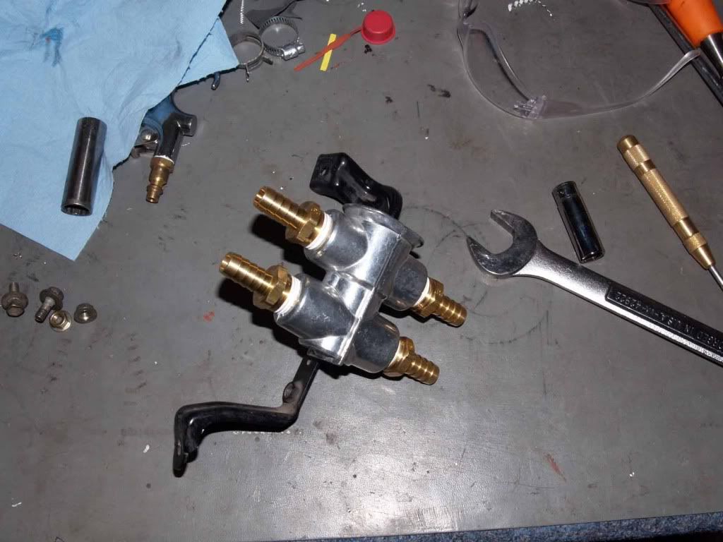

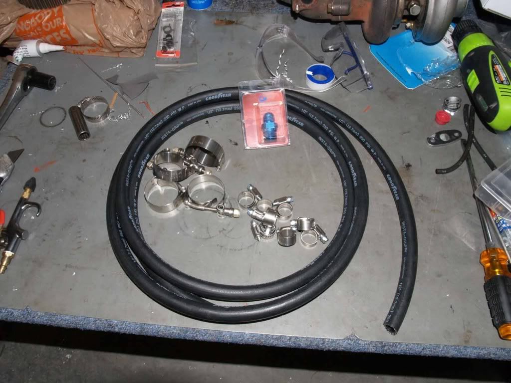

Friday after work I stopped by a local Hydraulic and picked up some goodies.
I then modified the stock oil cooler bracket to accommodate the oil thermostat. This worked out quite well.

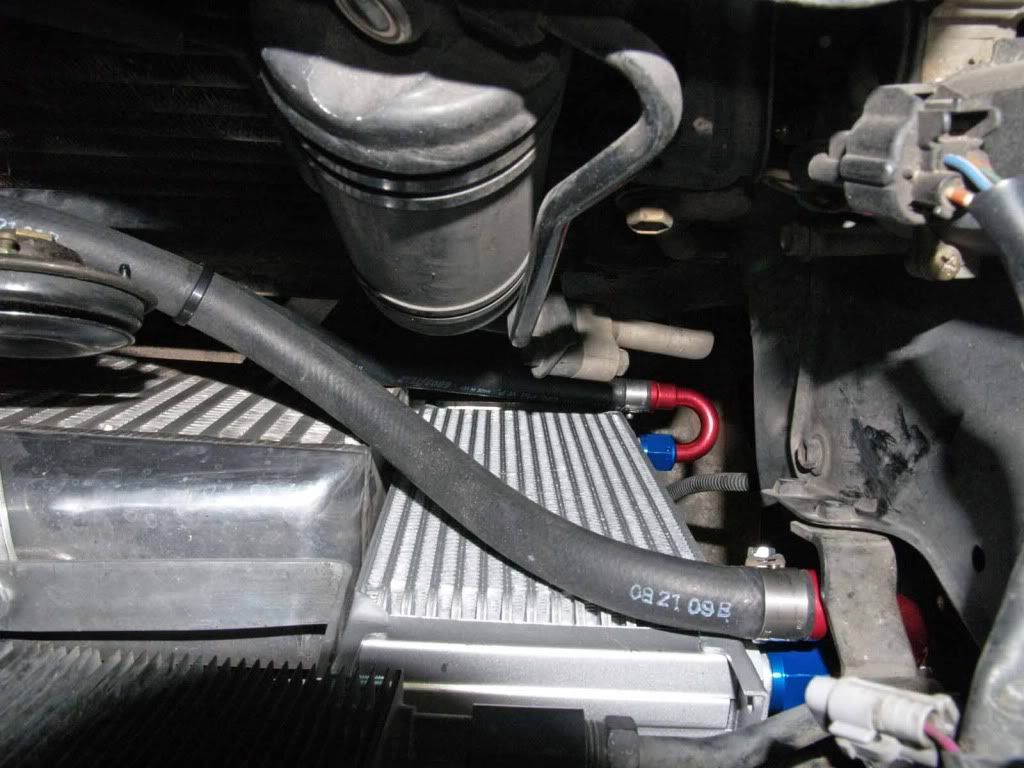

With the additional parts, I was able to start routing hose...
And here's the oil thermostat mounted with the modified stock bracket.
And I mis-calculated the number of 1/2" hose clamps needed so I had to stop here. Only two more hoses to attach. Woo Hoo... :)
Thanks Kenny. I just wanted to see how it looked compared to the stock. I think it looks great. :) Btw, what is the size of your IC? Also what is the rating of the hydraulic hose you picked up?

I don't know the IC dimensions. It's the Spearco style one from Driftmotion. It is small enough that the stock oil cooler doesn't have to be relocated.
The hose...yeah...it's rated for 250 PSI; but, only 190* nominal operating temp. They assured me that it'll handle more. I'm sure it will; but, at the first signs of hardening, I'm going to switch it out. We'll see...

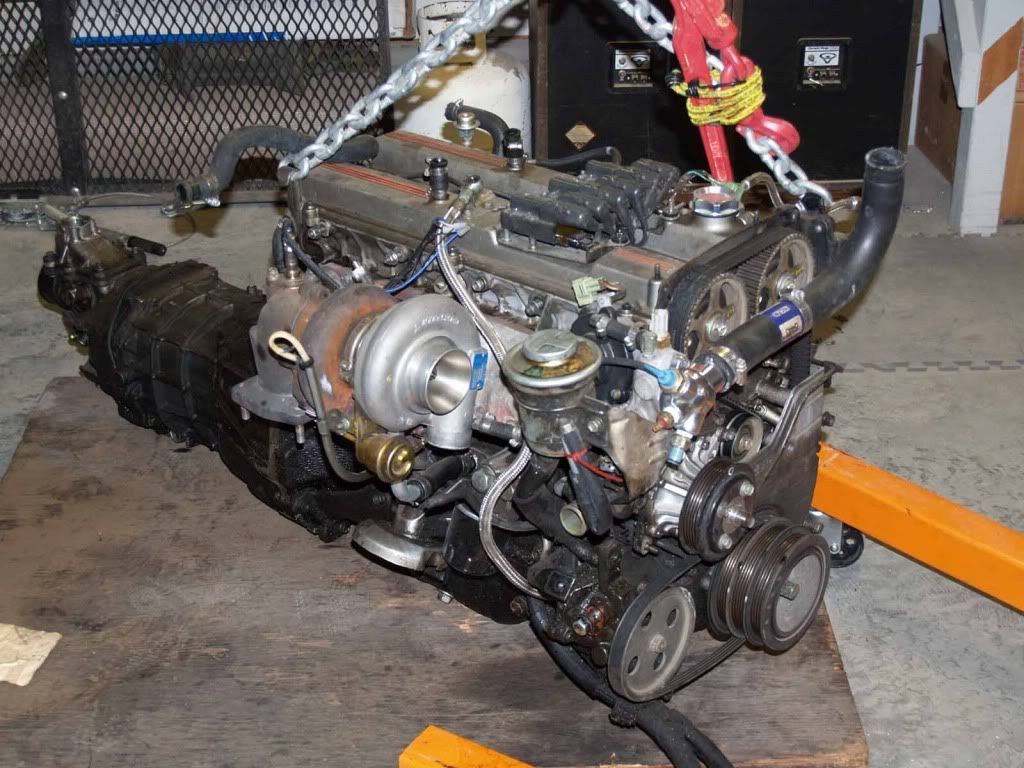

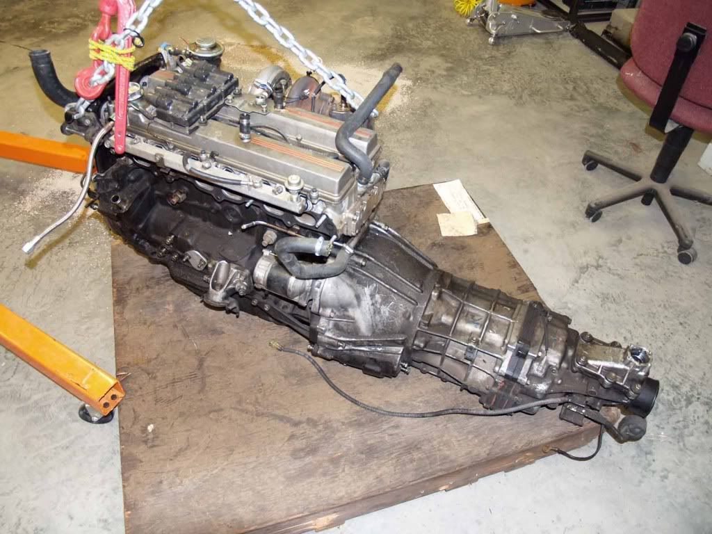

No, that was a chain binder that I used to level the engine. Basically, it was my "Ghetto" leveler because I'm too cheap to go buy a real one! :D

An update on my hose situation. After conferring with some of my race buddies and through recommendations here on SM, I am NOT going to run the hose I recently purchased. Tonight I am ordering some hose from Summit that is rated for 300*. That should be here by the end of the week!

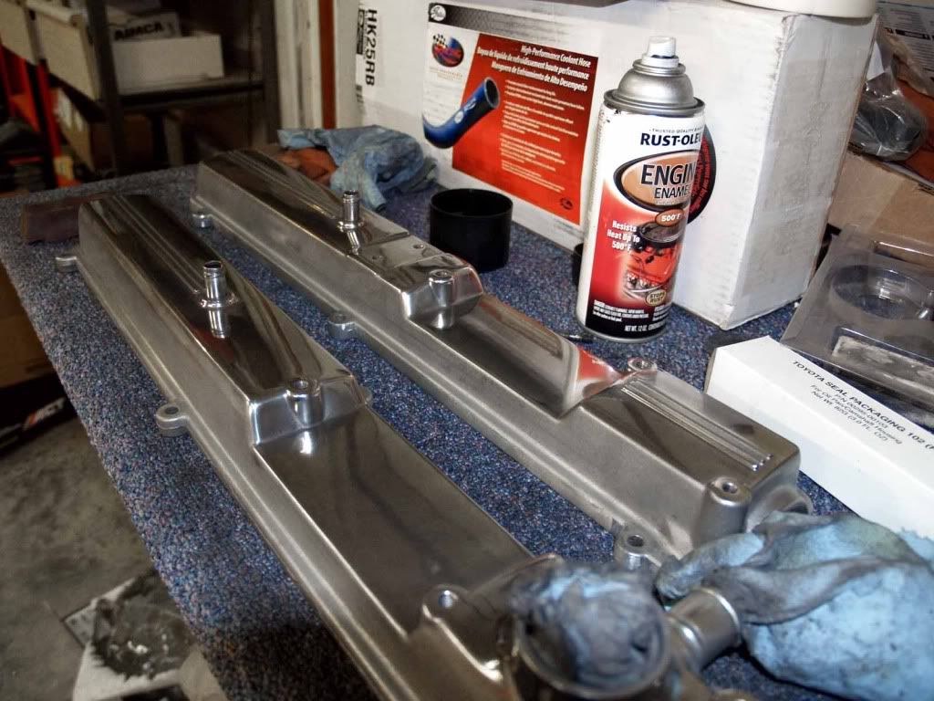

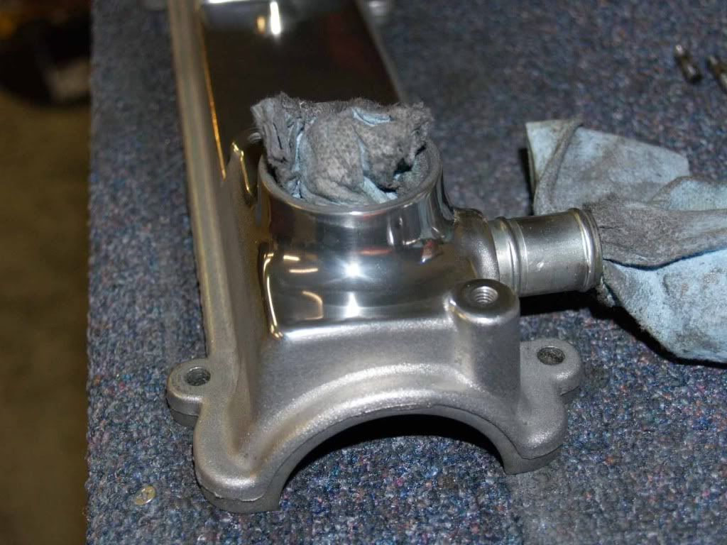

Now, I try not to post too often without including a pic or two. So...here is a couple of shots of my valve covers. I am almost done polishing the tops. The sides and ribs will get painted flat black. They should turn out pretty nice!
