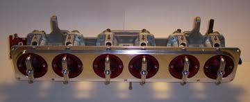

I'm fixing to dyno the 5/6MGE versions.
I'm building a manifold for the 7MGEs to test next.
For the Nissan L series
You can see the built-in ports for nitrous-oxide. I'm corresponding with Nitrous Express to test this. I have 3.0 build in progress right now and the 6Ms share the 7M bottom end. I just haven't done the cam, valve, and intake charge studies for the 7MGE head. It will coordinate time-wise, though.
If you've read any of my threads here you know to rip me a new fuckin' hole. I will make improvements and implement suggestions so I dare you........
N/A and spray ftw

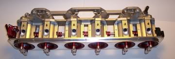

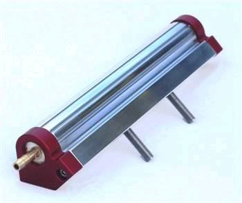

They are getting the plenum parts ready. I will update you when I get them. Here's their 4 cylinder image-
vacuum log is here
http://www.extrudabody.com/Products/Accessories.html
I want to run tps load values. It is much simpler. Maf and map are for dorks. I mean turbos. I'm just being mean. There is ffim plenum manifold if you are handicapped. I'm building a turbo manifold with new tech on volumes. ITBs will make a big difference. Stock will have twice as fast throttle response just due to the closeness of the butterflies compared to stock's remoteness.

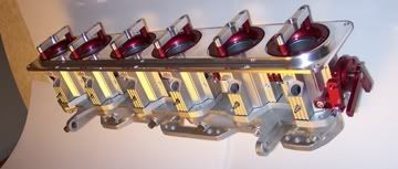

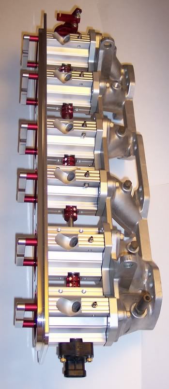

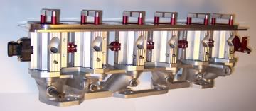

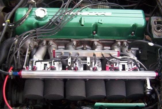

"I'd love to try ITB's like that on a GTE, but i guess space restriction is our downfall "
Not so. The manifold and ITBs are so short. The manifold runners are individually cut and spaced to suit individual needs on my manifolds. They can angle up, curve using bends instead of straight tube. Just imagine it. If you can see it in your minds eye I'll come get it.
