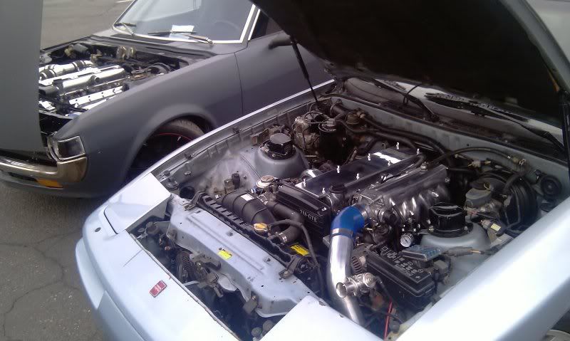

If there was enough interested, I'd start making the 7M FFIM again that I have pictured in my vendor section that keeps the alternator and compressor and I believe it looks quite nice!
