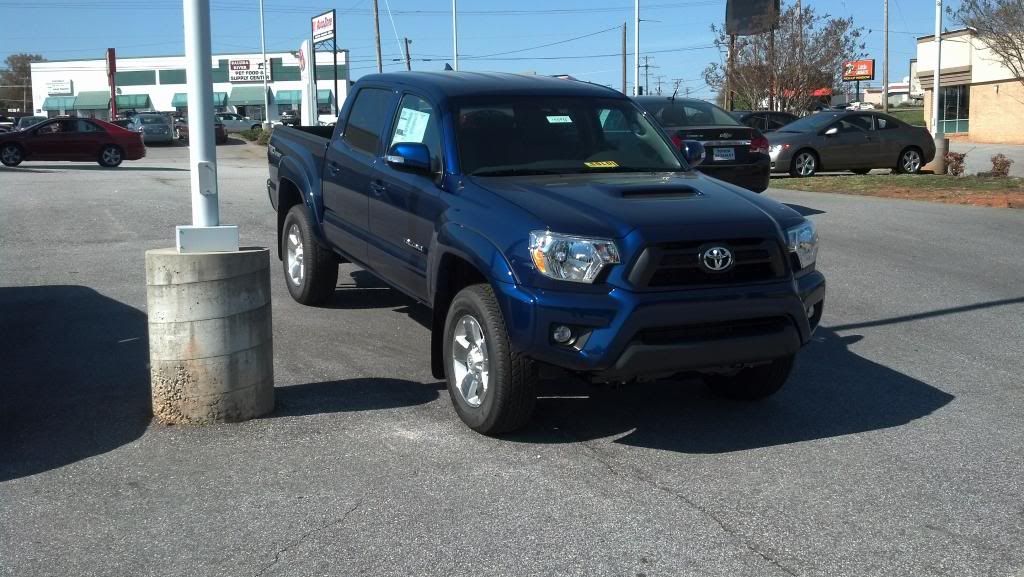

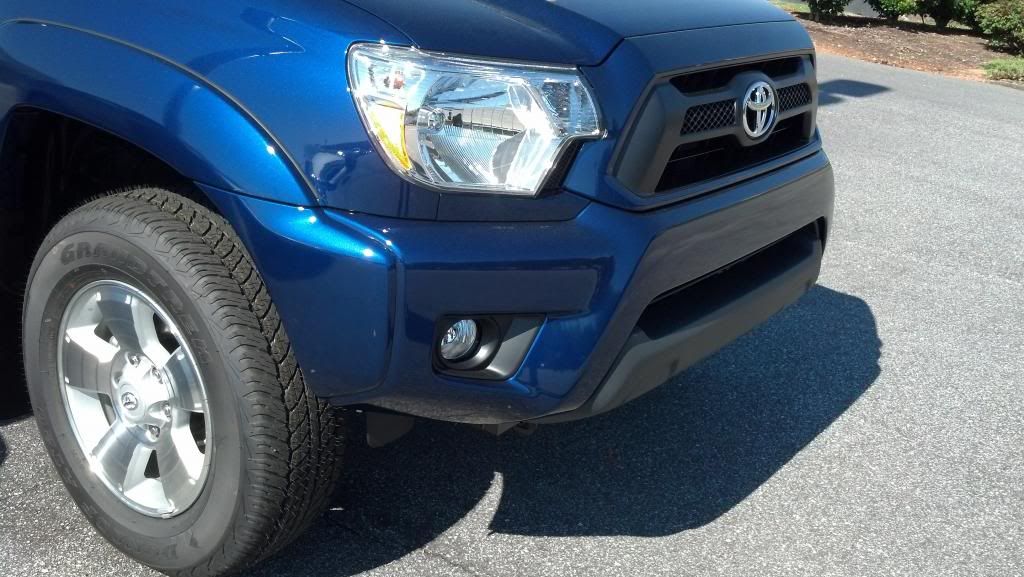

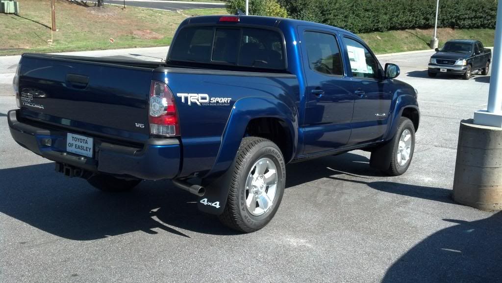

after selling my 88 sr5 pickup AKA the blue beast i had the need to replace it..
meet the reincarnation of the blue beast :)
2014 tacoma TRD SPORT 6 speed manual with Supercharger :D she has 7 miles on her and i had to order it and wait a month for it to be built.
