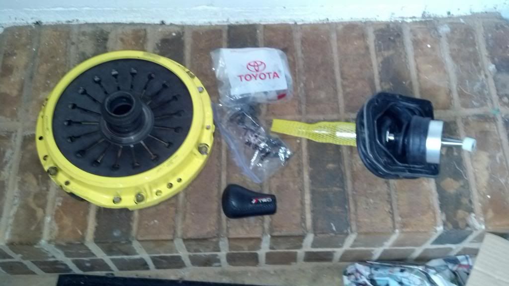

Let us know how the yellows feel, I was just looking at buying a set. I want full subframe bushings and control arm bushings so I can swap over all my new suspension stuff at one shot.

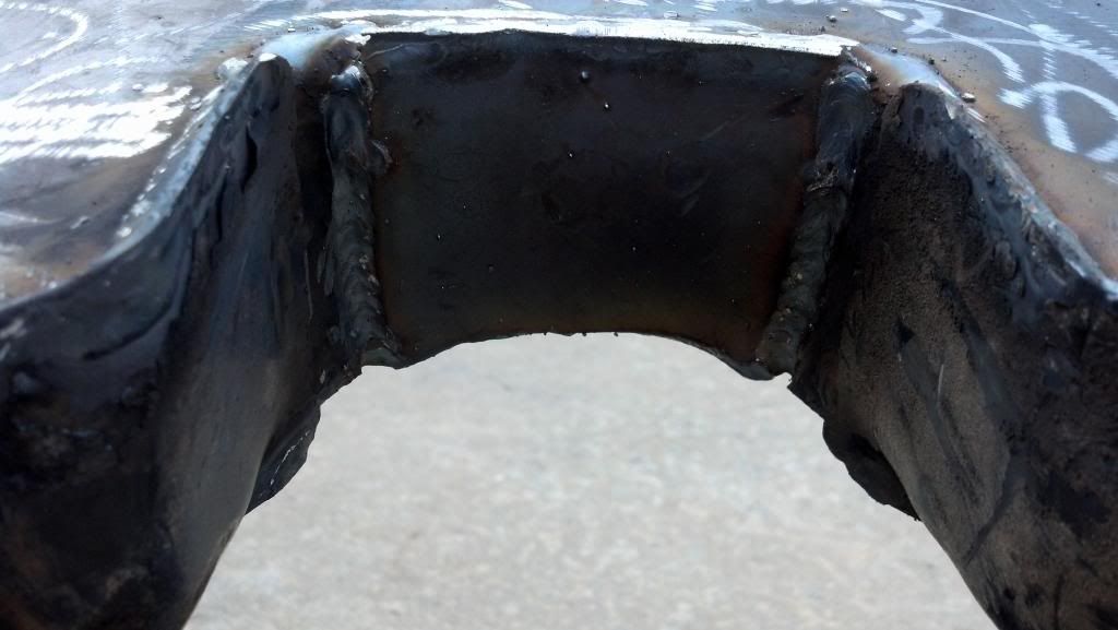

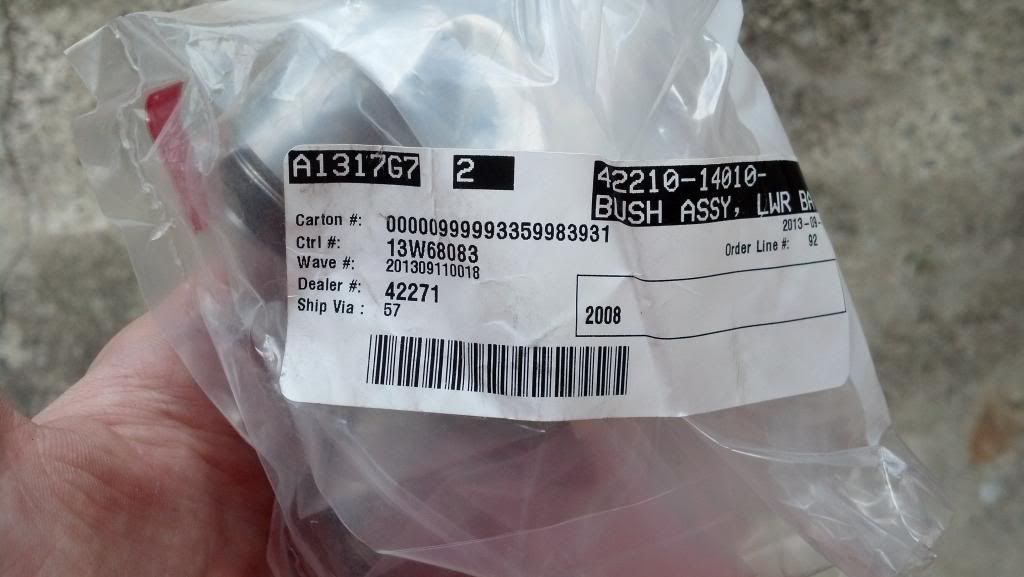

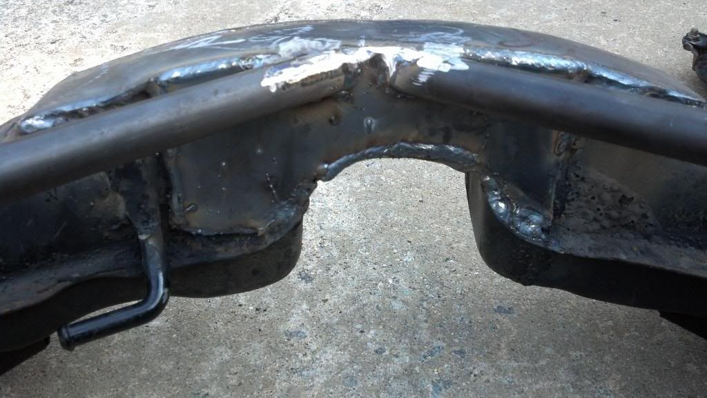

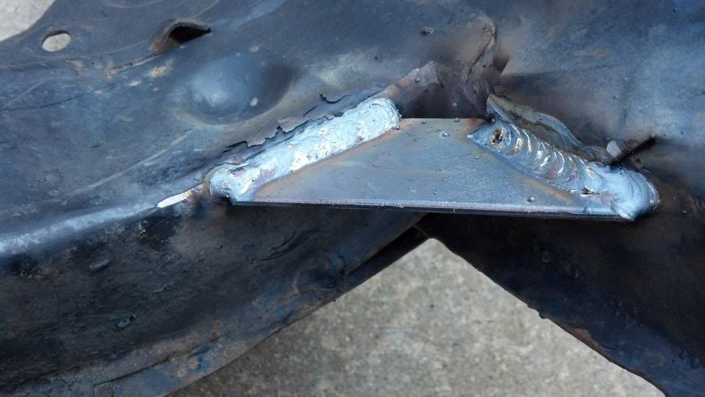

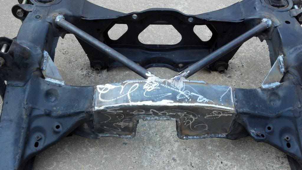

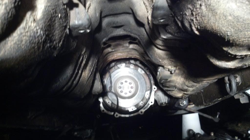

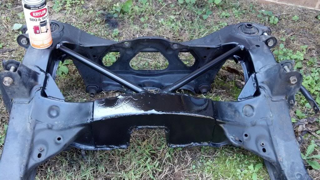

That was my goal but they will be shipped next week but my vacation ends wedsday. :/ so subframe goes back in with only the new ES bushings and sephirical bearing. And i was suprised that the ES kit had a poly replacement for the sephrical o_O word to wise save money and dont by th bearing lol. And rear subframe was reinforced and built r154 is being installed saturday with extreme PP and full face disk. I had some burn marks on flywheel but ill just sand it with wood and 120 grit before install. Then after all the suspension and drive train is installed its time for alignment. Then after that ita time to fix turbo drain leak and manifold leak and make new wg dump tube. ( questionable boost creep problem)

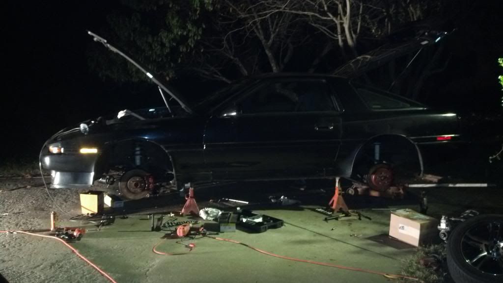

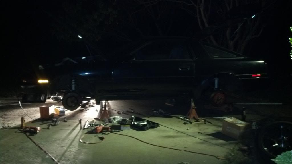

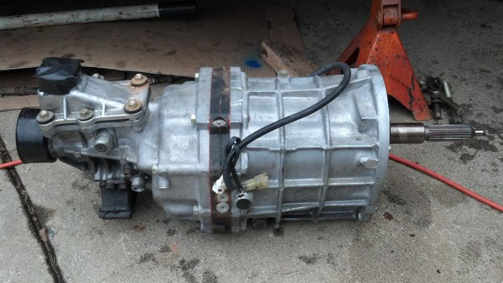

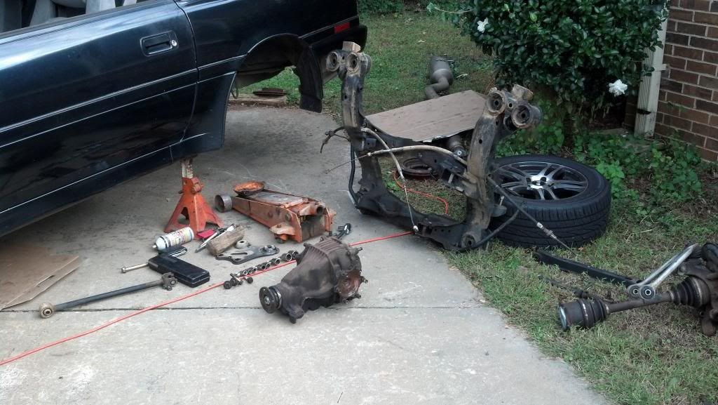

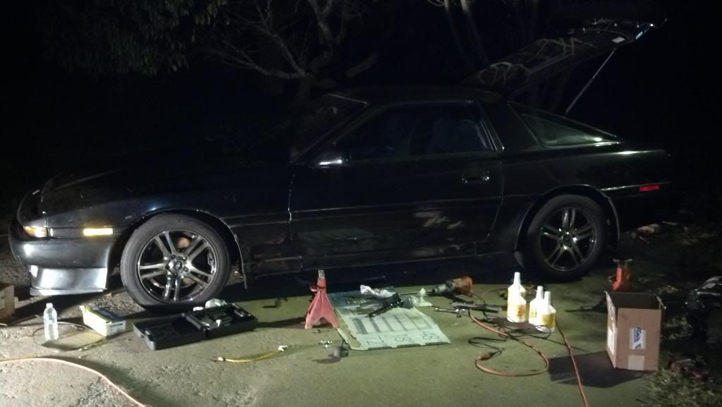

Been on a time crunch. So I have very few pictures besides what I have sent you Diego and last night I stayed up working on it til 6 am. Its all done besides exhaust. I installed and Assembled rear subframe, trans,ssv3,all of the front suspension, and the starter lol. Put fluid in trans. Now to find a alignment shop open on Sunday

Thanks man. im really sorry i didnt take pictures but it was a major time crunch. i have a few ill post that i did get.

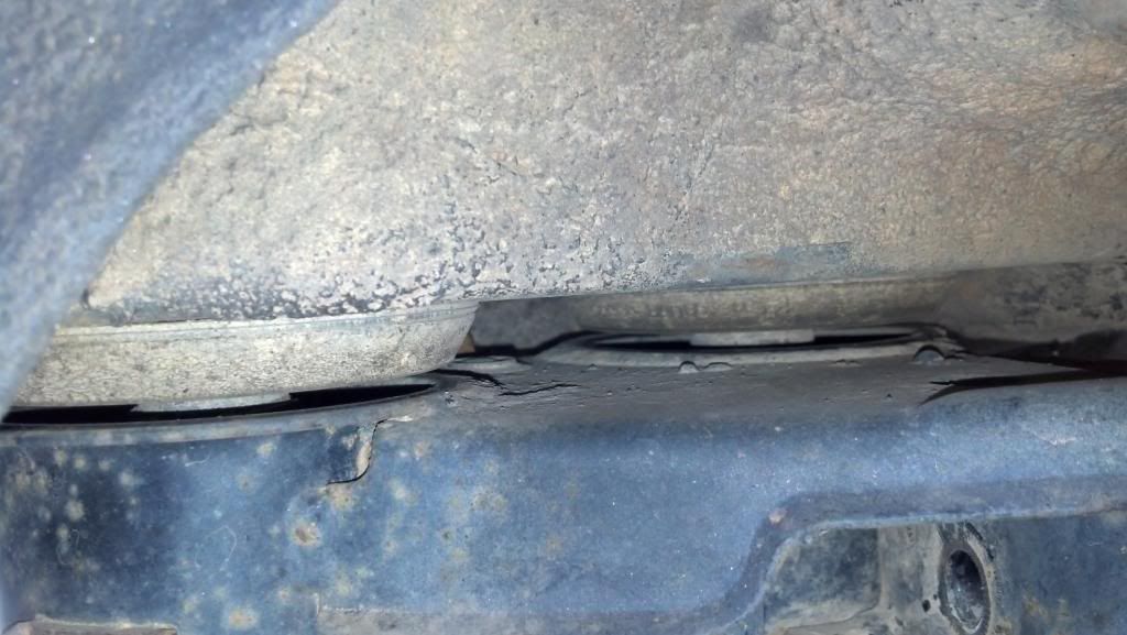

And right now i have a old dude and his son setting up the alignment. i need to make sure to call them and get the front camber to -1 but anyways ill have picutures of the damage

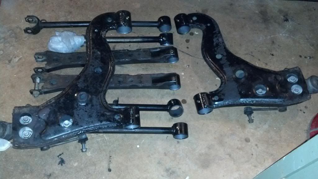

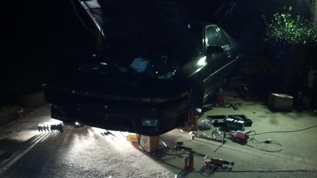

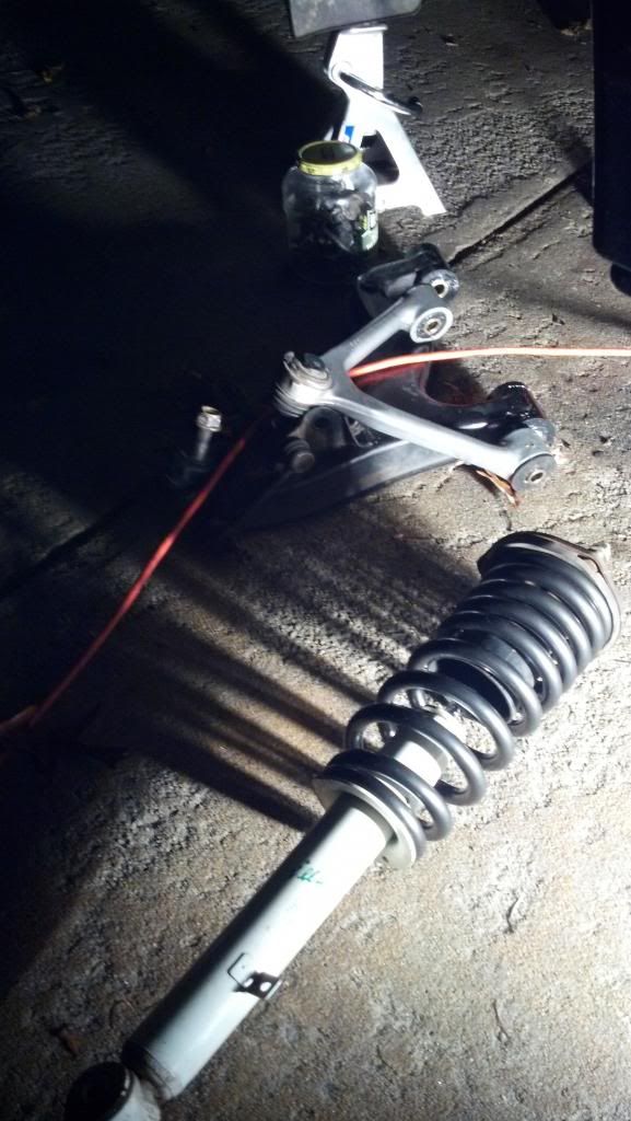

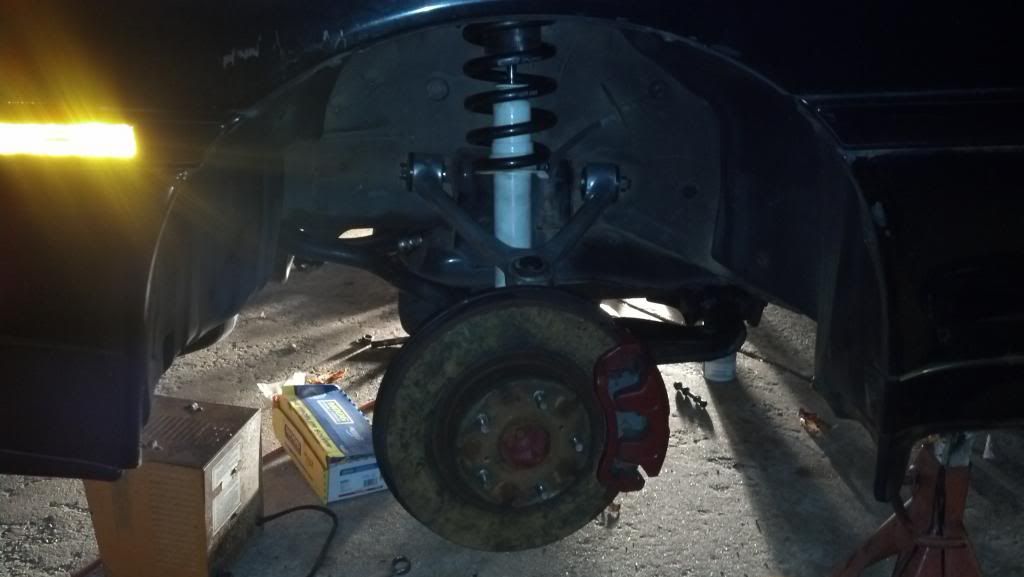

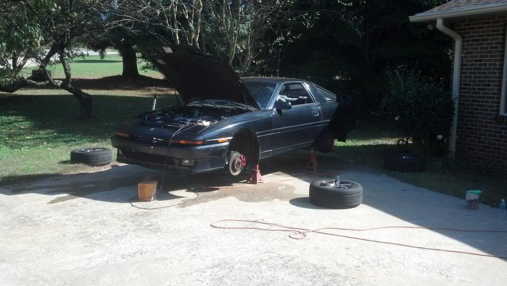

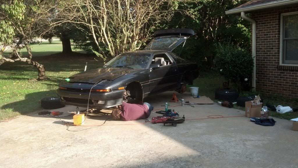

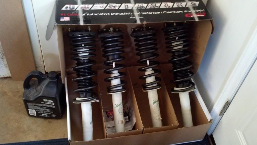

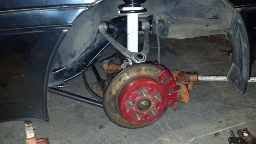

there is alot missing as far as pictures go. i didnt take any pictures during the spring changes.
i swapped stock springs for eibachs. used the infamous widowmaker rental tool from autozone

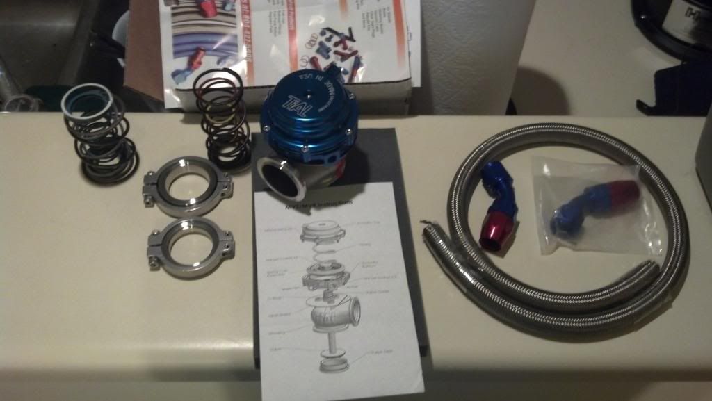

and a impact gun. took all of an hour to do all four. also ordered -10 line for turbo drain and
russell 45* ends because the cxracing ones have finally started to leak. and i also ordered a
Tial 44mm MVR because i cant seem to stop my CREEP problem :/ so the ebay one has to go.

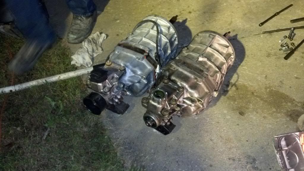

marlin crawled trans from sm.com member :)

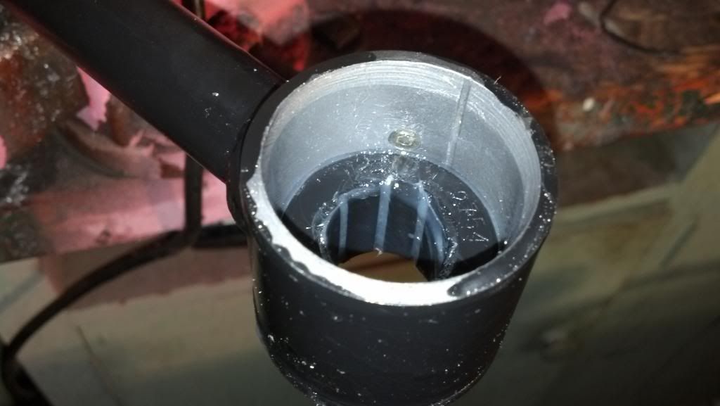

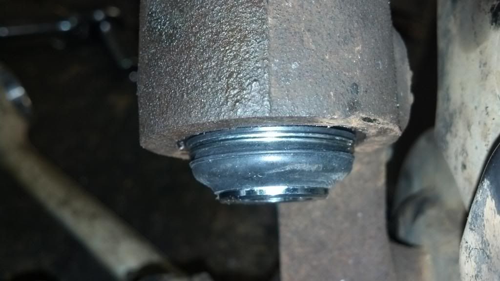

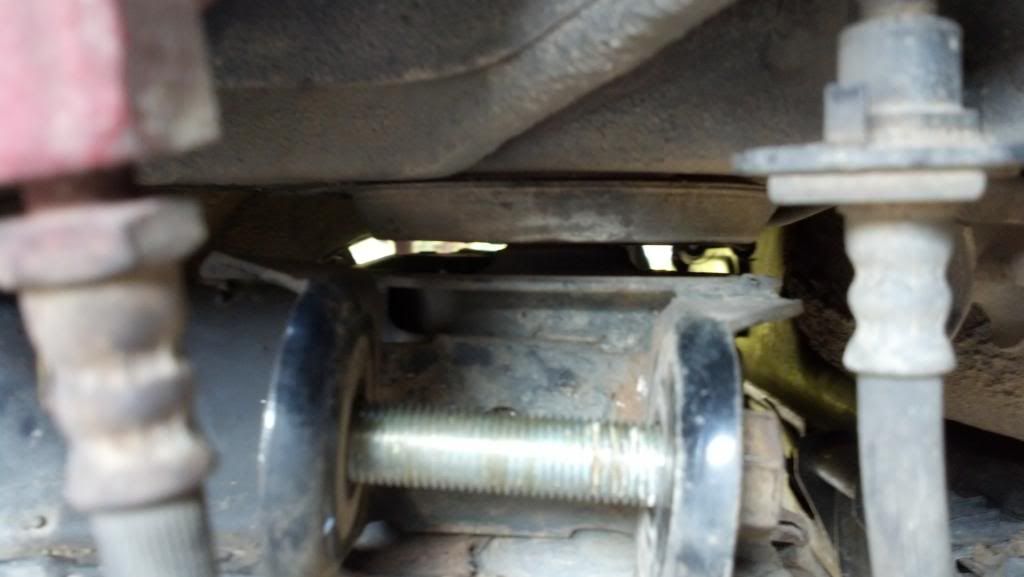

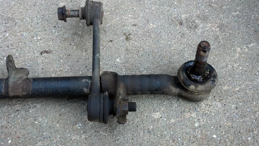

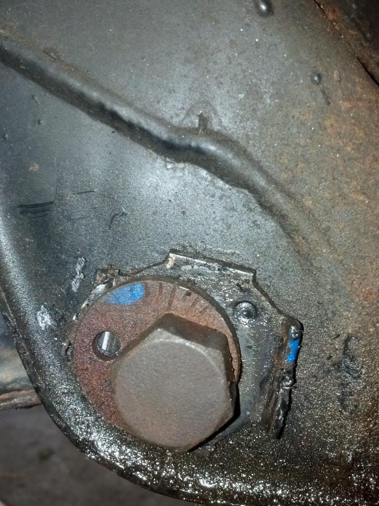

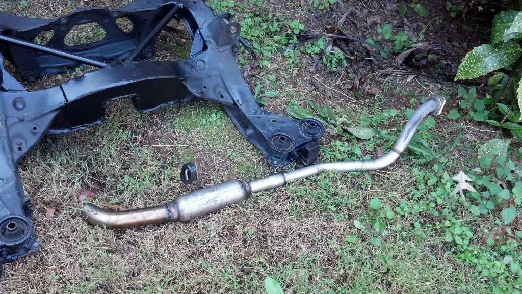

bushing time
added zerks fittings
zerking off :p
DONE!!
then an alignment shop fucked up this and my vaction to work on supra :(
