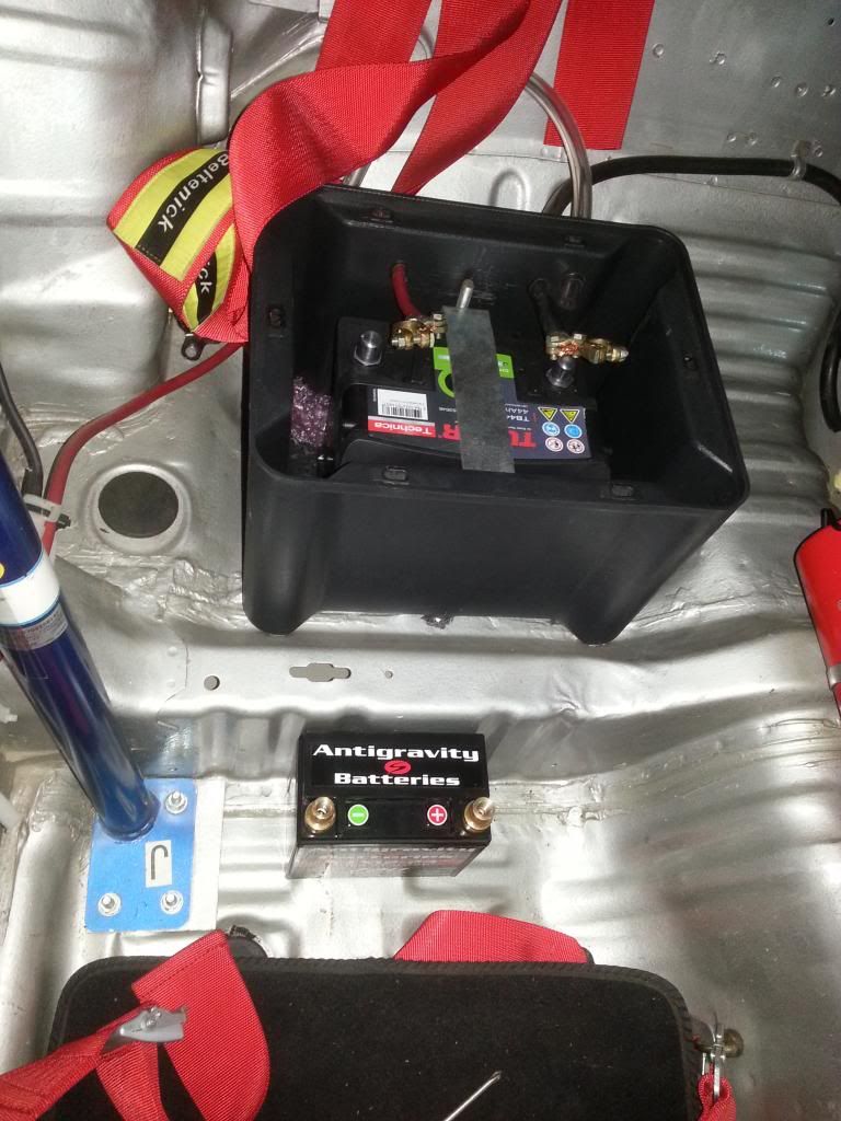

I found the solution
yes the battery will be behin the pasenger buckett but it will be a race battery brand Odyssey, small , light and no need a sealed box so it can be fitted at any location and they are saying that they are good for AEM cars! jejeje
josbeat
Jul 31, 2010
483
spain
Van;1988541 said:
I have found BRAILE batteries the most durable, lightest and reasonably priced for our motors. I've had mine since 2009. Here is a link: http://www.braillebattery.com/index.php/braille/product_batteries/b2015
and its going well for daily drive? start the 3.0 l turbo engine well ??
a company send me today this , the Varley Red Top 30 11 kg http://www.varleyredtop.com/products_batteries.htm
11 kg but they say well for alternator charging and to star engines over 3.500 cc engines
but I was thinking to fit the Oddysey pc680 7 kg
dont know what to do

I ll go foward and try out the lithium battery
Braille UK dosnt answer my emails, the shipping cost to bring one from there in USA is ridiculous so I will test other options

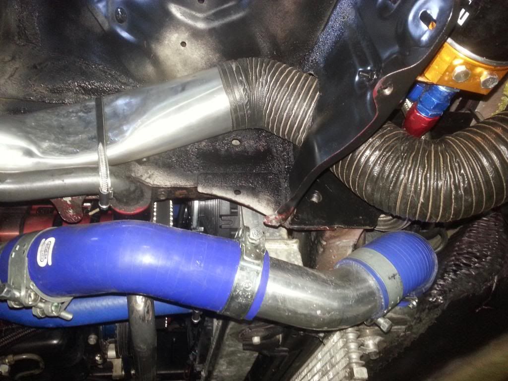

front brake cooling solved, like the Corvette c5 or c6 system used.

on the right side we need to move the wiper water bottle, but it is a oportunity to move it to other place and to use an small one.

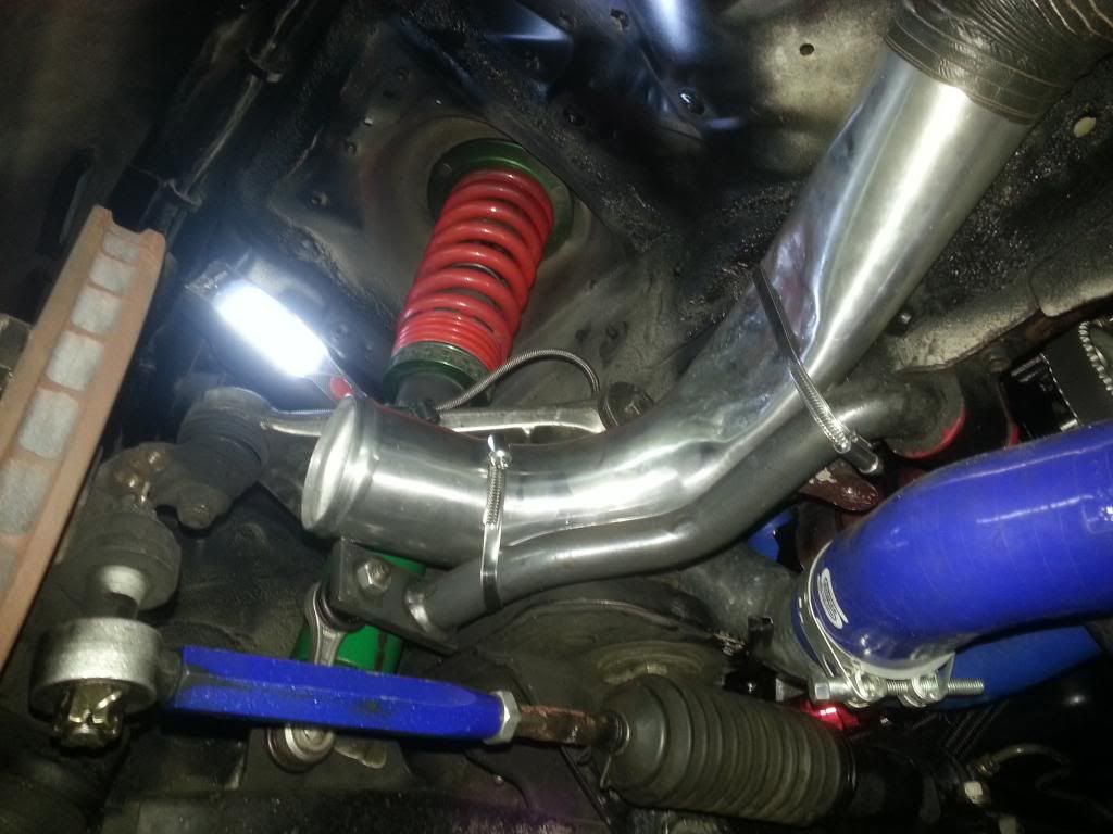

new exhaust , lighter and smaller
other photo is the next proyect , wheel air arch exit .

Apr 6, 2005
339
Alpharetta, GA
The front fender rear exit is a great idea, as there is substantial high pressure zone in the rear or the fender that'll contribute to some degree of frontal downforce resistance. Will be interesting to see what your final solution is.

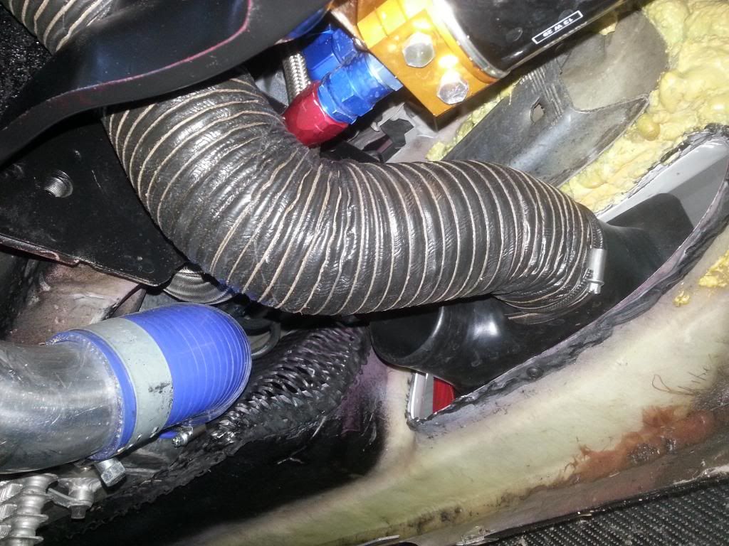

I think it wil be nice you`ll see
At the back with a corvette air duct and channeling like this.
at the moment I will use one of the front brake duct hole to feed extra cool air to the filter
