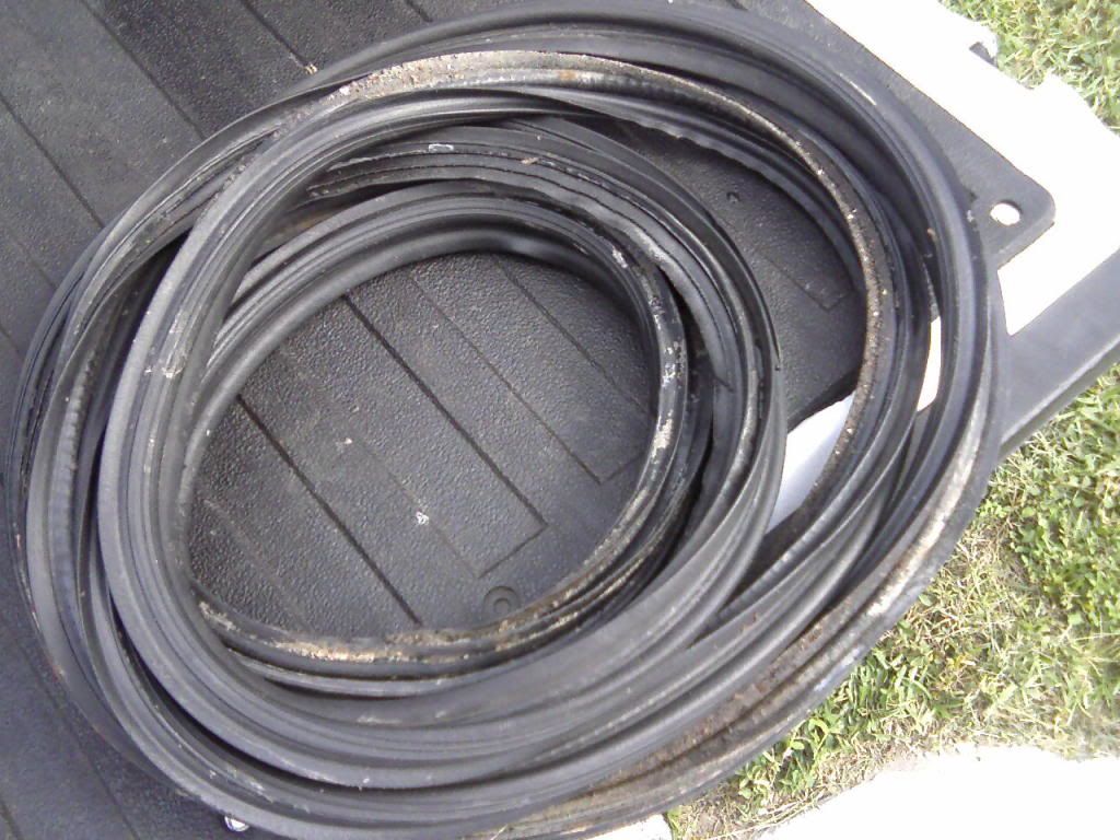

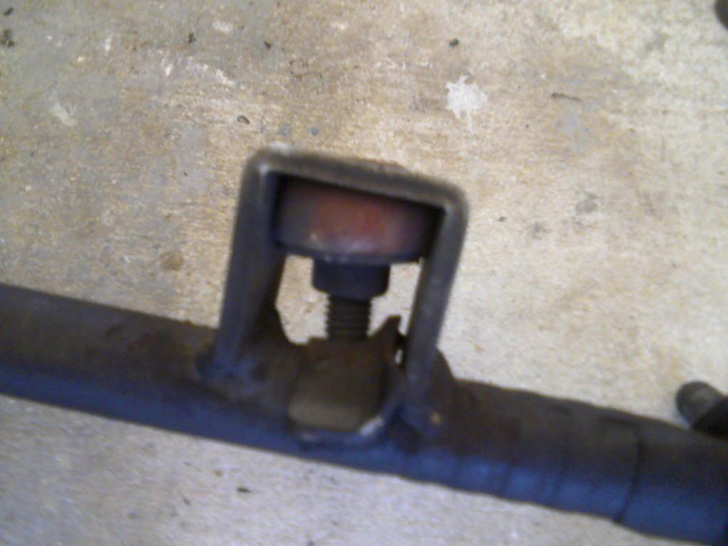

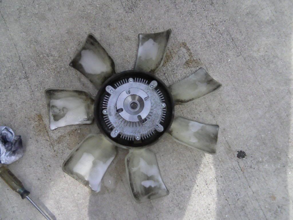

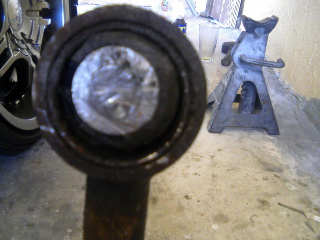

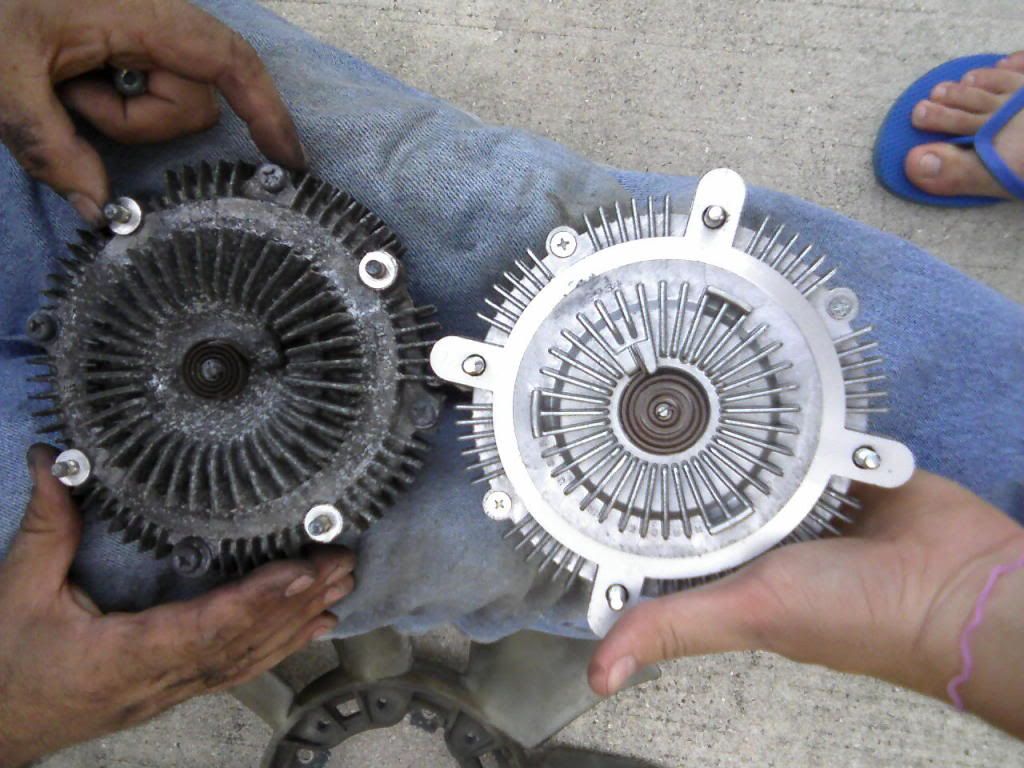

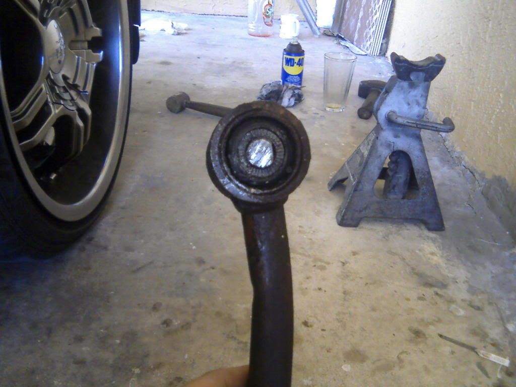

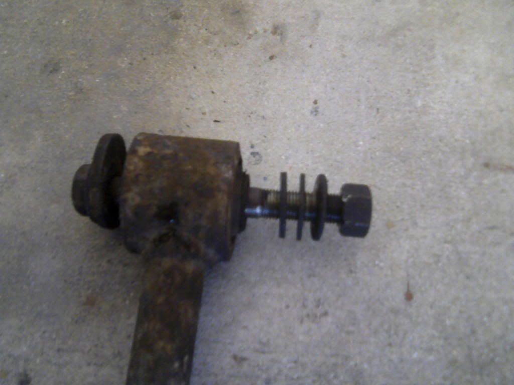

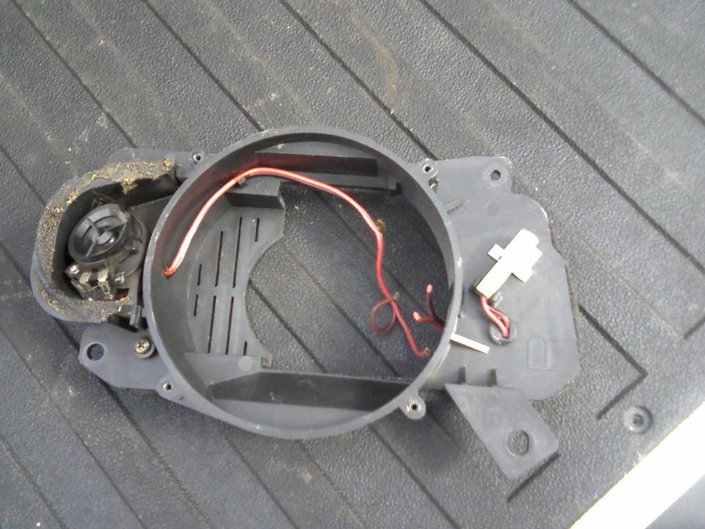

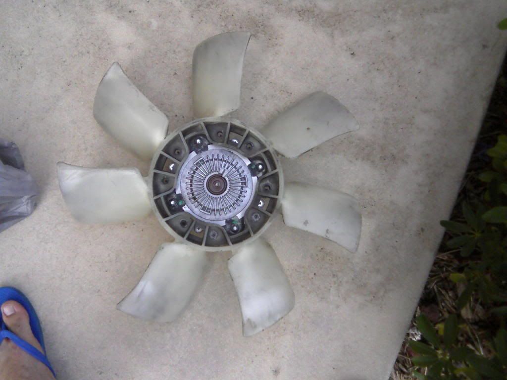

Well long time since i updated, few weeks ago i noticed my upper radiator hose was like sucked up i took the cap off and noticed the radiator wasnt topped off, had to add about 3 cups of antifreeze i thought everything was okay until i noticed the upper hose wasnt holding pressure very well. I had the cooling system pressure tested and there is a leak my guess is it has a BHG again... changed the thermostat, new fan clutch, even found speaker pods off a 92 and hatch seal from a 92 in mint condition, i tried to get the arms that the sway bar connects to but they were rusted and nothing got them out, i need them because the previous owner cut the original end links off and welded a different one on that ended up just breaking and one of the arms is bent so im still looking for those.
Old and New fan clutch
speaker pod :D

The endlink that the previous owner did. bent and broken :/

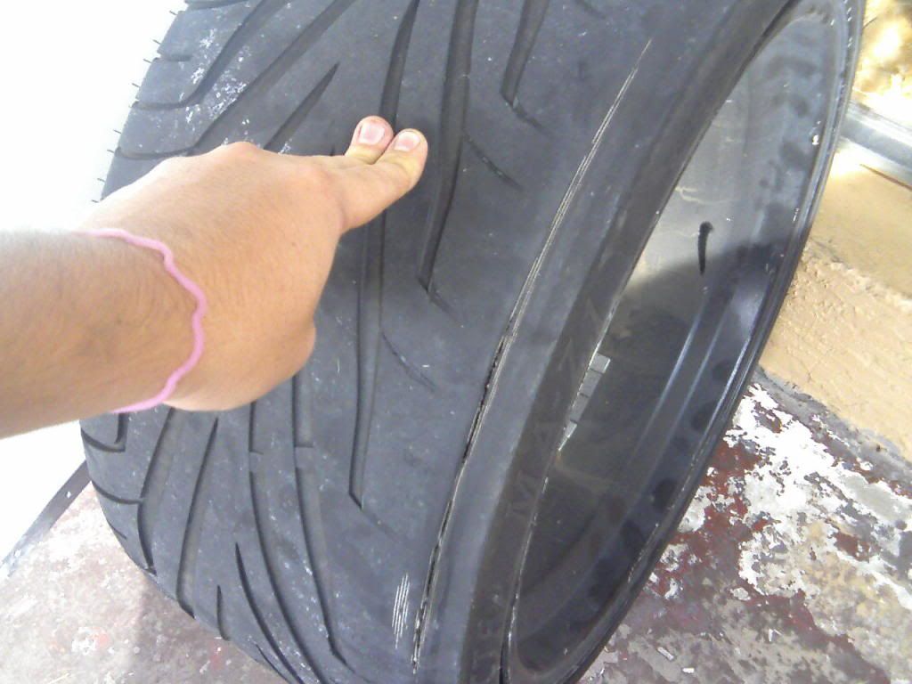

reason i need new arms :/ camber omnomnomnom not putting new tires till i fix this D:

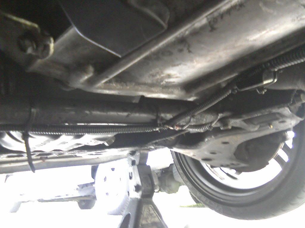

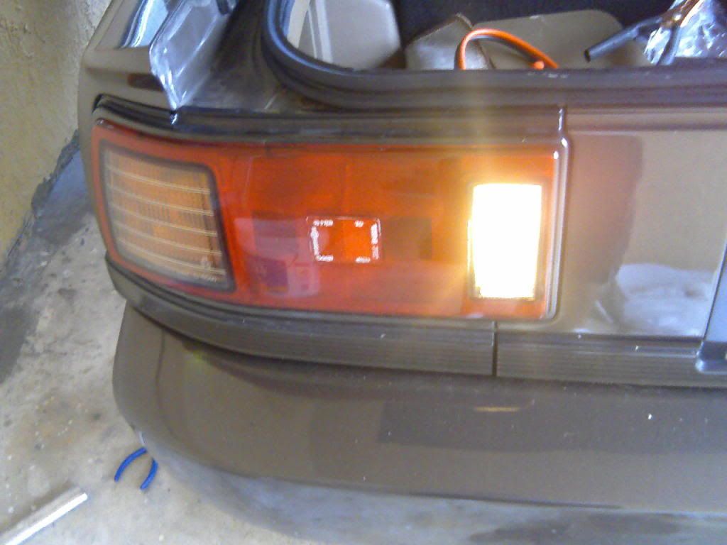

I also finally extended the reverse light becuase i have the r154 :D

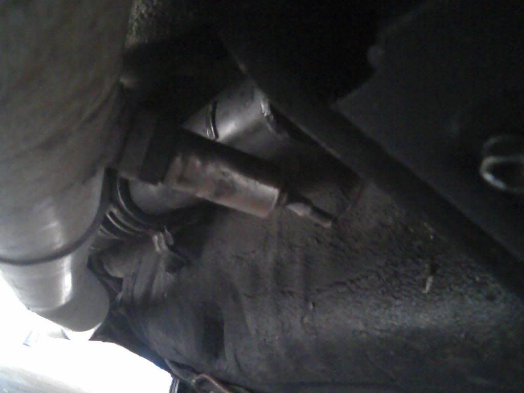

Also in a previous post, i was wondering what some wire was and i found out while trying to wire the reverse light it was for the o2 sensor i believe, but wouldnt running without an o2 sensor throw a code?

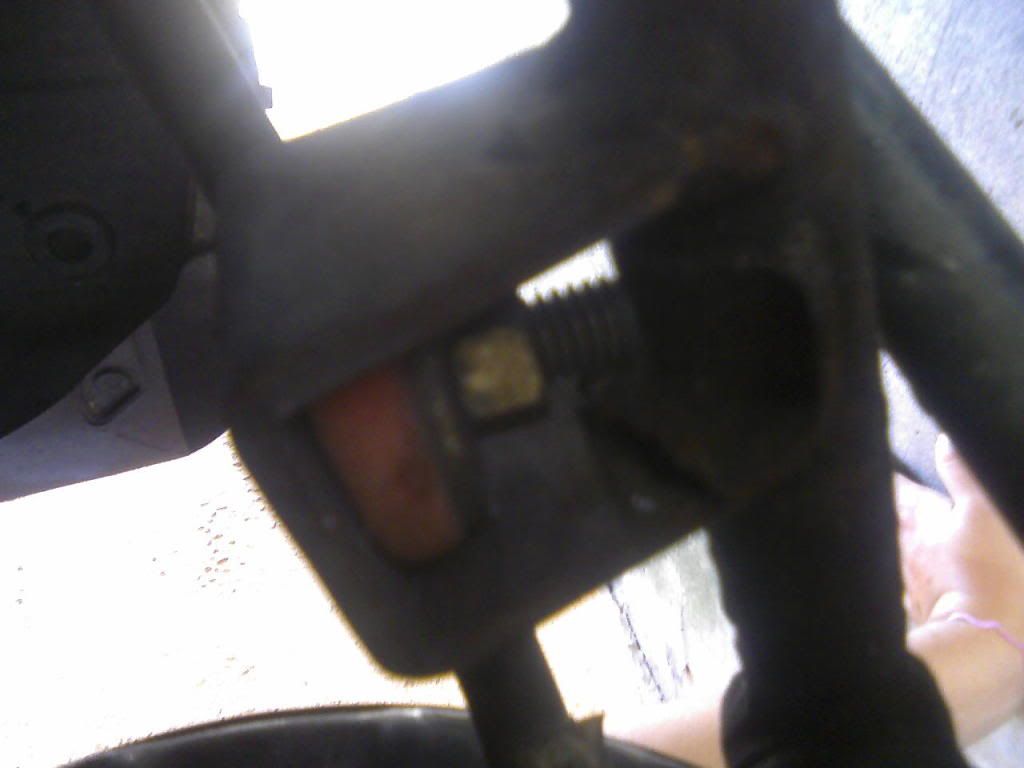

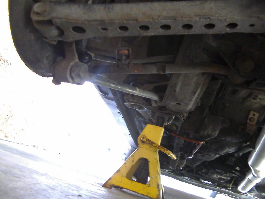

finally got new arms to swap, the right side was cake finished in a few mins then we moved onto the left side which had the bent arm. The bolt was siezed and would not budge, ended up cutting it. Now the end links are finally hooked up to the suspension technique sway bar, at first i wasnt sure if it was real but after comparing it to a stock sway bar it was much thicker and stronger, it really made a big difference.
Now i need new rear tires hopefully with this i can now bring the alignment back to spec so i will not kill the new rubber, also does anyone have good places to shop for new tires?
^ it had a ton of washers and no camber plate thing same on both sides :3d_frown:
