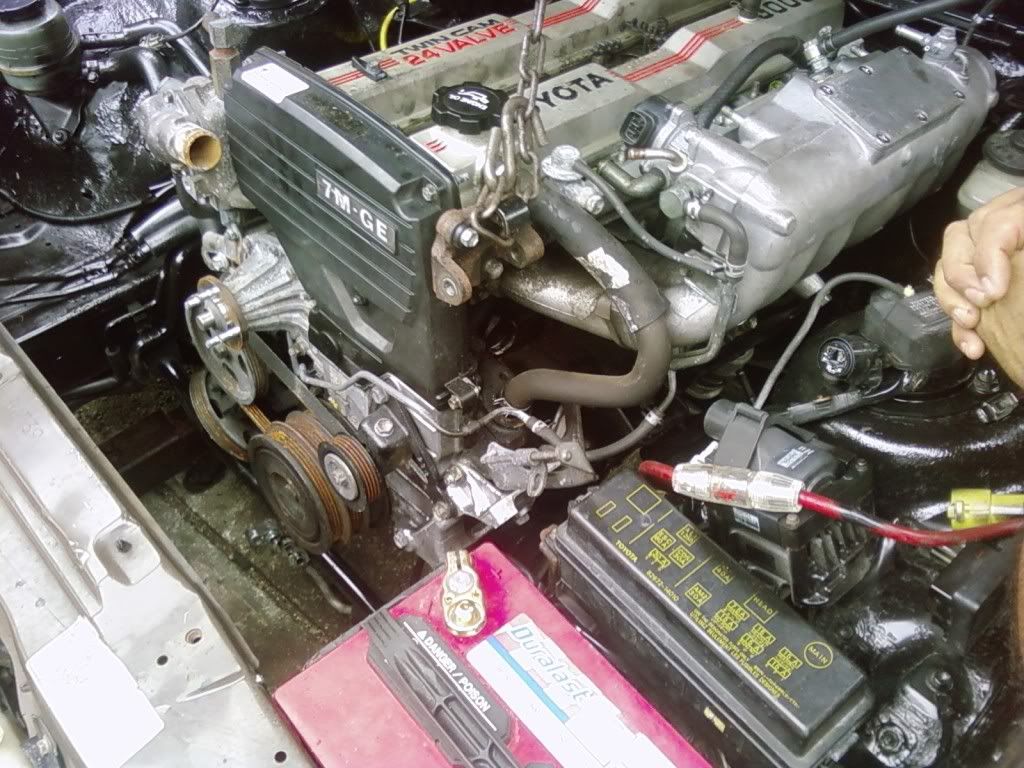

The engine sitting in the freshly painted bay, need to swap the sump from the old engine as well as the pump so it can fit, as you can see from the pic its tilted.

Just swap the oil pan from your oil engine and it will work. You will need to change the pick up as well because the sump will be toward the back now.
ty this is what im currently doing.
