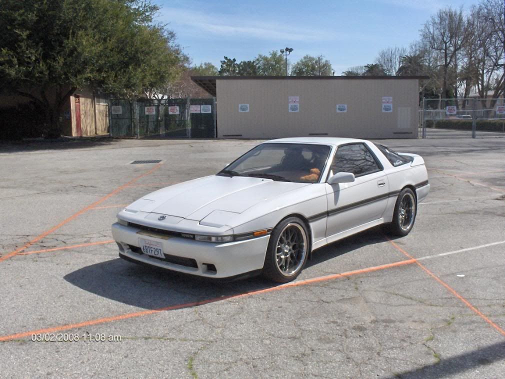

Thank you both for the information, I appreciate both your help on this. Here are the wheels i was looking @:
They make 8.5's +38 but there not concave like this.

SUPERIUM;1199155 said:
Just looking at the pics he's definitely not on h&r's, more like eibachs to me. Theres like a 1-1 1/2" difference between those 2 springs. Not everyone wants to roll their fenders and deal with rubbing issues and uneven tire wear. Some people like myself like to drive the crap out of their cars without sacrificing performance over looks so Im not going to reccommend something that Im unsure of.
This is where wheel fitment gets crazy. It is all up to what the person what to do. Which is why every time someone ask for some help I have to ask their goals and suspension set up.

well on that note, I am one of the "drifters" so to speek and i want a flush fitment with my N/A MKIV's....
I Rolled my fenders allready and just ordered some 1.5 spacers all arround...
Are they going to be flushed or close to it???
I am running the Megan racing coilovers!!!
Thanks Guy's!!!!

Yeah they'd be flush. Look at BorHor's old posts and find his old car with n/a mkiv's and i think 25mm(~1inch) spacers. It looks gooood. Yours will look betttter.
