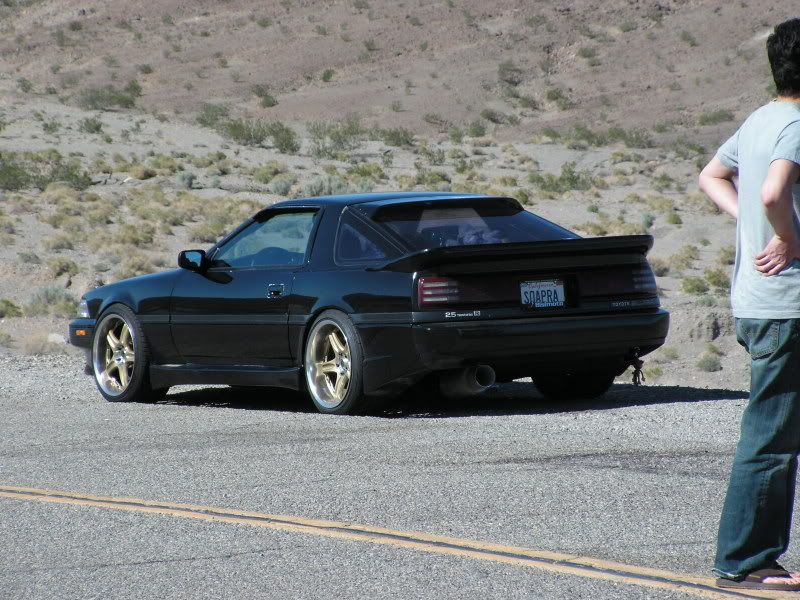

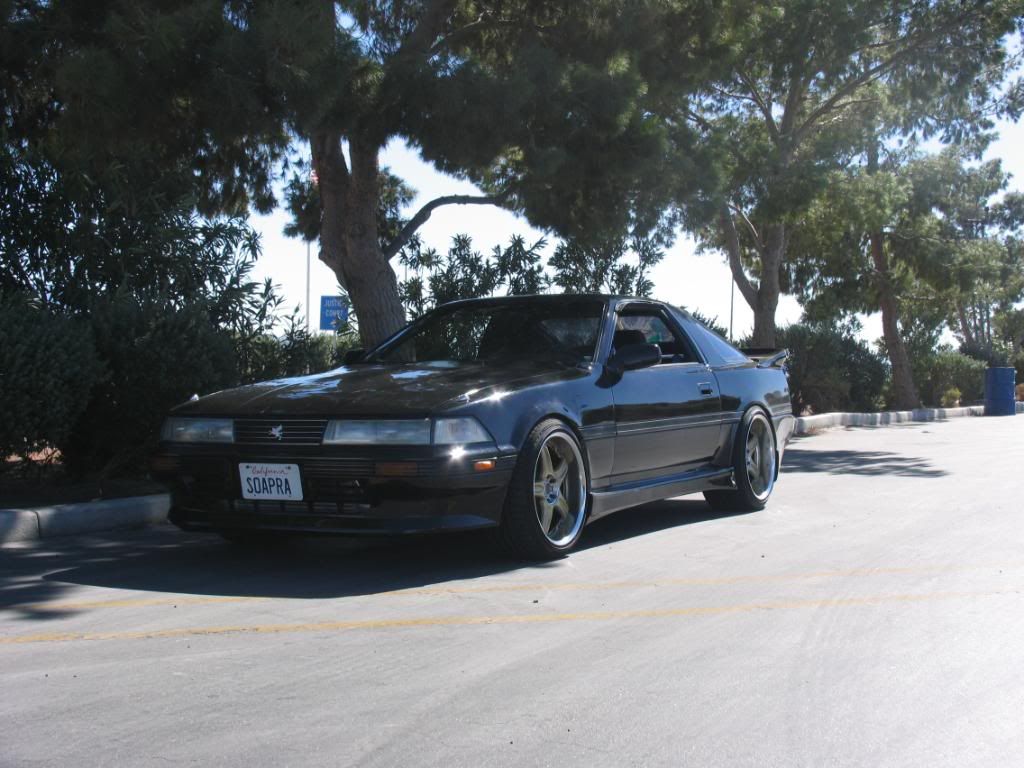

s0ulstar;799718 said:
IMHO, Jose has one of the best wheel fitment to date. the new wheels he has are awesome and the pictures posted just don't do it justice.
EDIT: i stole a couple of joe's silv pics.
For anyone wondering what the size and offset of my wheels are, well here it is:
18X10 +19 high pad fronts (still clean TT brakes)
18X11 +24 low pad rears (enough to clear coilover springs and TT rear calipers)
tires are 265 front and 275 rears. If my Soapra fenders can fit 265's, I'm sure regular A70 fenders will fit 265's. If I add the JIC upper A-arms I could do 285's in the front. My next goal is to fit 18X12's all the way around with 295's or 305's all the way around.
