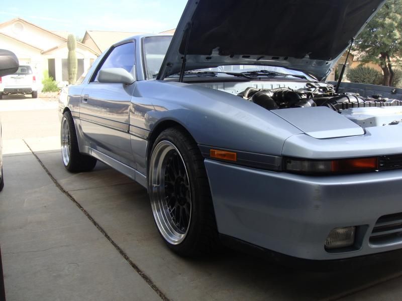

Grandavi;2035217 said:
I find that excessive without a roll/pull. XXR seems to be limited in their offsets
Here is a pic from another angle. I like the poke, it looks great in person and I prefer to not roll or pull fenders if I don't have too. If I was on coilovers I would def need a roll

My comment is basically that I had wheels that did that on a car about 30 years ago. They looked good, as do yours, but the quarter panel lip was pretty damaged from those "oh shit" bumps I hit over time. Yours look to be in excellent shape so that would worry me. other than that, they do look great.
