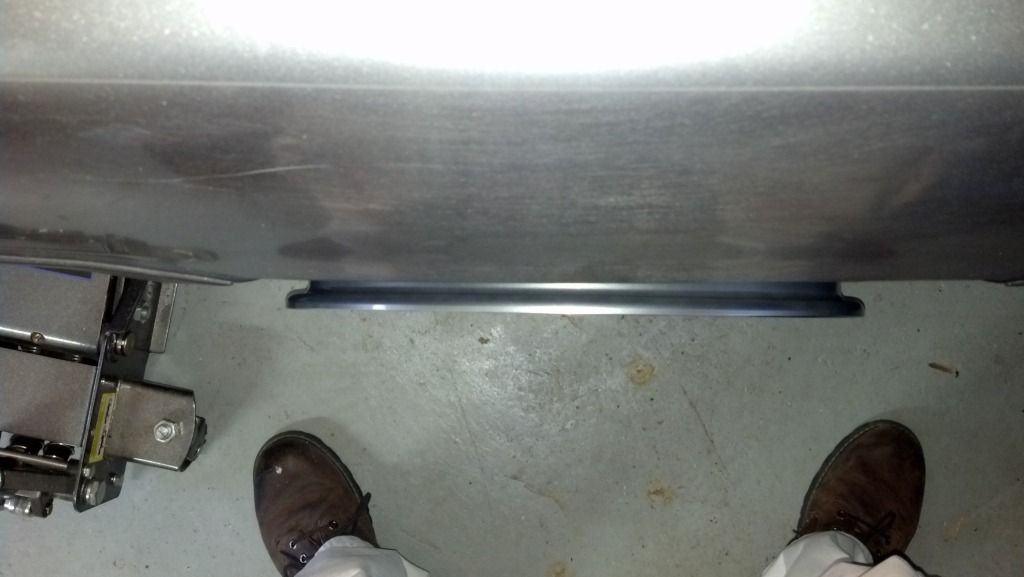

I have a hard time seeing 18x10/+25's fitting within the wells. I accidentally got shipped an 18x10/+22, and at full tilt-in camber, they still stuck out about 8mm beyond the well.
I had a 265 on it , and it was only barely stretched. A 245 might make it work.
Without the tire:

Your suspension needs to settle tho.
I run 18/10 +25 all around. I'm slammed more than most and never even come close to hitting rim to fender. With 275 rear and to big guys in the back seat I only rubber the tire up in the fender well.

I'll take your word for it, then.
But I have coilovers, so they don't settle much, and it was just as bad sitting on the tire.
