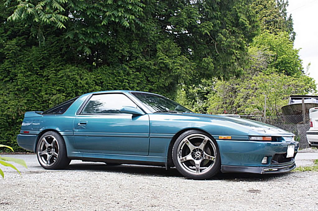

18x9 + 18 235/40/18
18x10 +22 255/35/18
H&R w/ stock struts
no rubbing at all. was going to put wider tires but sold the rims instead!

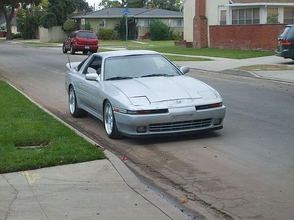

heres mine with my bbs wheels. i have yet to see any supra's with bbs's although im new here so i could be entirely wrong.
car needs lowering really badly.
17X9 ALL AROUND ET28 (offset) powdered coated.
