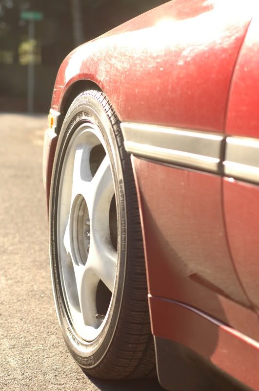

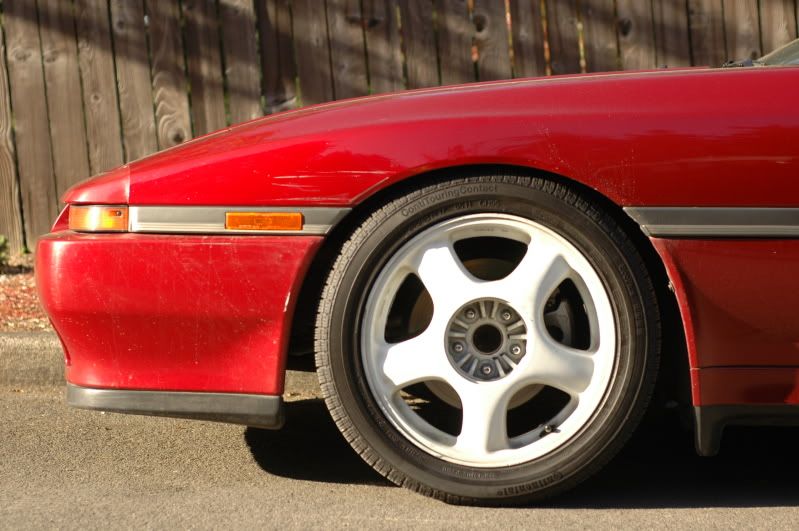

Just got my ccw lm20 in. The fronts are 18x10+20 as you see in the provided pics. Rears with be same offset but slightly wider
