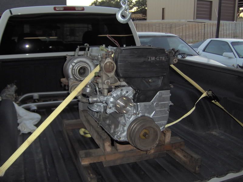

Ok, so I got my engine home::w00t::
Then, all by myself, I assembled my engine stand and lifted the engine out of my truck and attached it to the stand. I was proud of myself since this was my first time.
I then placed the old engine on the cradle Christian gave me so now it's up off the floor. Sorry no pic.
Anyway, it's home after five months!!!!!!

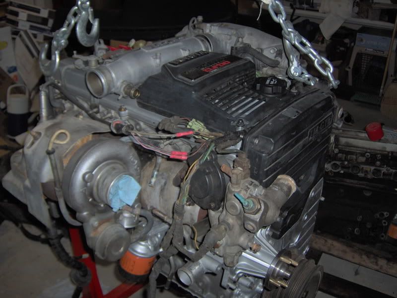

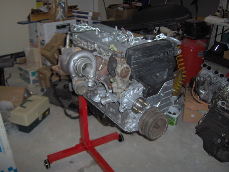

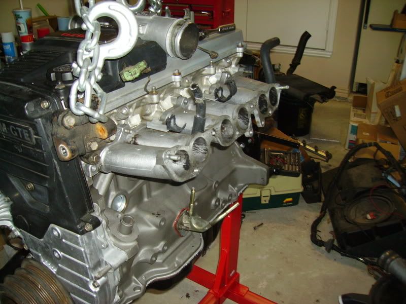

Well I was finally able to piddle with the engine today and I must say I'm so happy I could just shit! I put the heat shields on, the coilpack and wires. Also put new spark plugs in. I used Royal Purple degreaser to clean off the intake and coil pack cover and that stuff works great. If you notice I have the engine secured to the stand and also have the chain still attached to the lift. I'm so worried about it collapsing.
Here are some pics
Now I've got to figure this stuff out. Also, I have to get a throttle body for an automatic. The one that's on there is for a manual, so no lever for the kickdown cable to attach to.

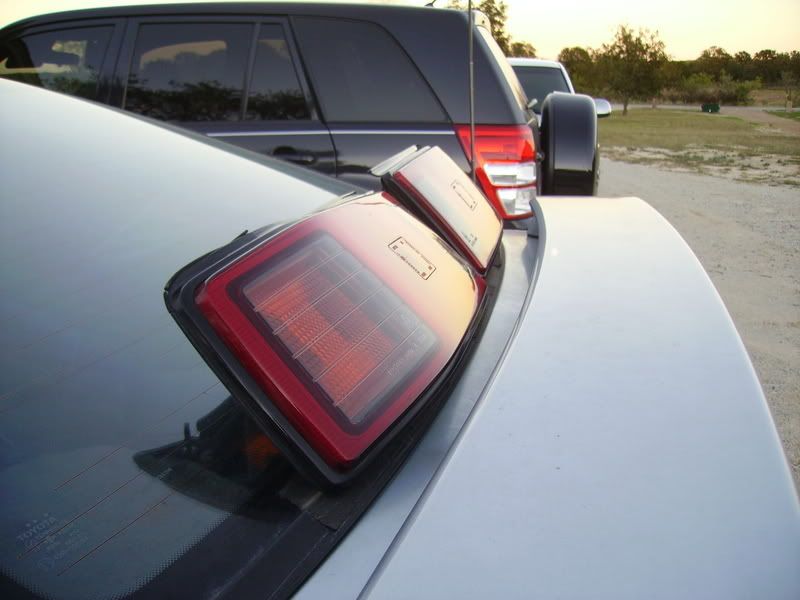

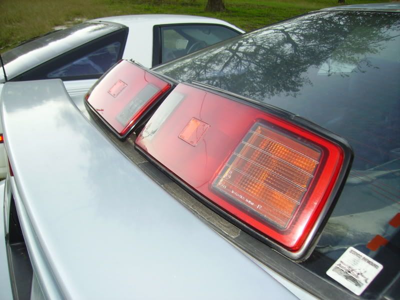

And may I add PlastX FTMFW. It made my taillights look new.

Well I accomplished a little more today. I installed the fuel rail, fuel injectors and lower intake. I then fed the wiring harness around the motor and plugged in a bunch of things. When I get that other throttle body then I'll bolt up the plenum. I need to get some vacuum lines, clamps and some more small water lines. I have to go to the mother in laws house now for dinner ( ugh :( ). I'll try to put a pic of the latest later. I have to work the next two days which sucks. That's all I need to get the motor ready to drop in. It'll be next week sometime. Then it'll be time to tear the dirty white boy down.

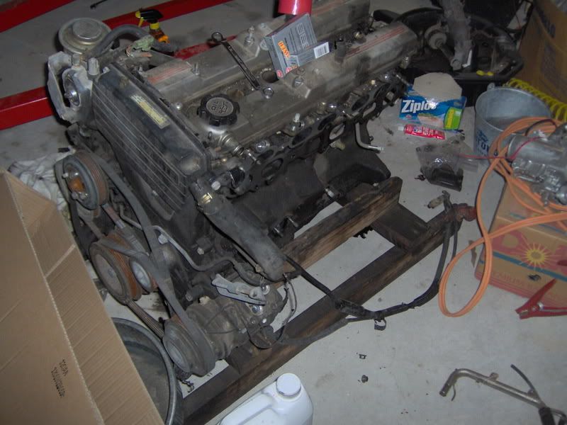

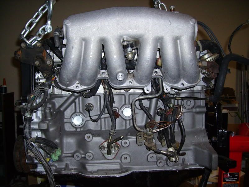

Ok, some of what I did today. The plenum is just sitting there for looks. I haven't cleaned it or changed out the throttle body yet.

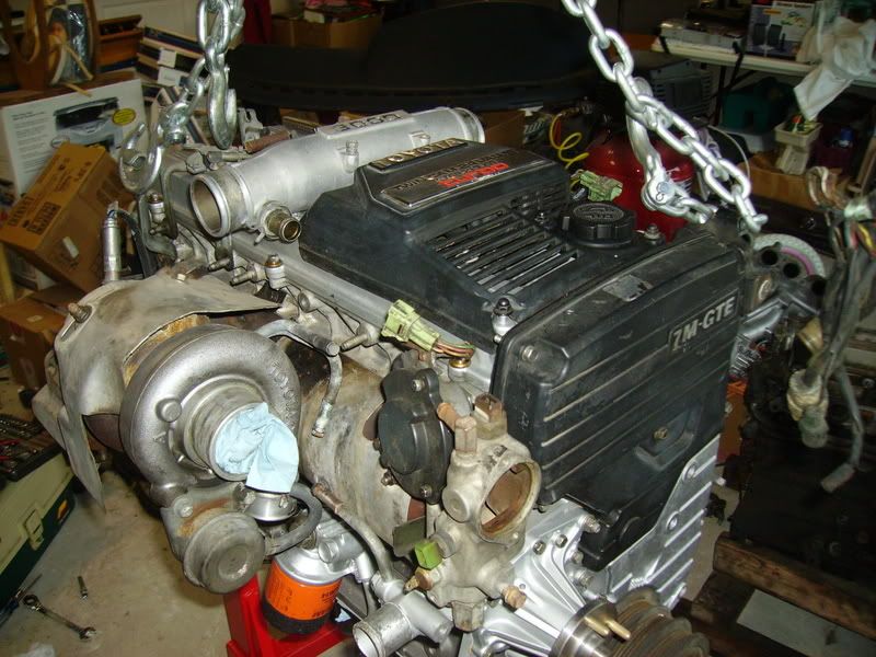

Turbo side. Notice my ghetto splicing for the O2 sensor.
Here's my donor engine. RIP. I really have no idea what, if anything, is wrong with it. Just part of the block is broke off where the tranny bolts on.

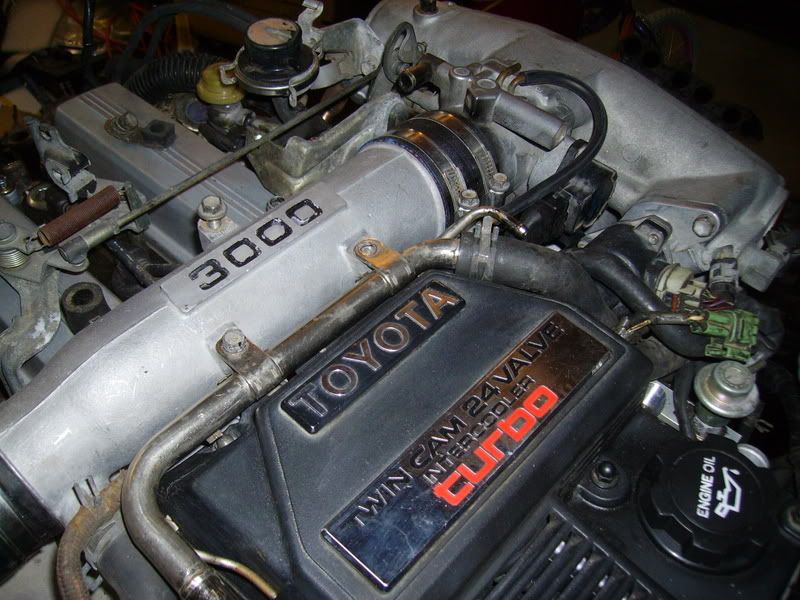

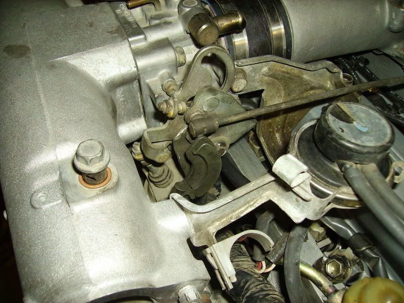

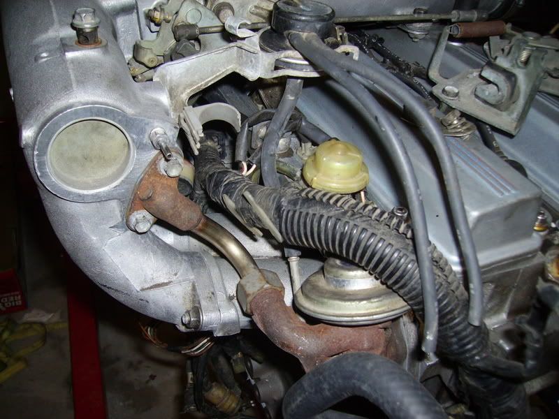

Yeah yeah yeah! My wife is on a cruise with her sister so been busy being Mr. Mom today.
So first pic is of the ghetto fabbed auto kickdown lever. It needs a little fab since that throttle arm is rubbing it.
Second, got the egr put on. Just got to figure out which hose goes where.
Third, got the 3000 pipe mounted on. One of the screw holes for that vacuum tube is stripped out :(
Fourth, I've lost the bolts for the plenum so need to find some that fit. Tomorrow while the kids are in school, I will try to finish up the vacuum lines and vsv's that go under there. My goal for the end of the week is to have all the vacuum lines sorted out and have brackets mounted for alt, ps, and a/c.
Block vent hose and turbo coolant lines on their way from Elmhurst Toyota.
