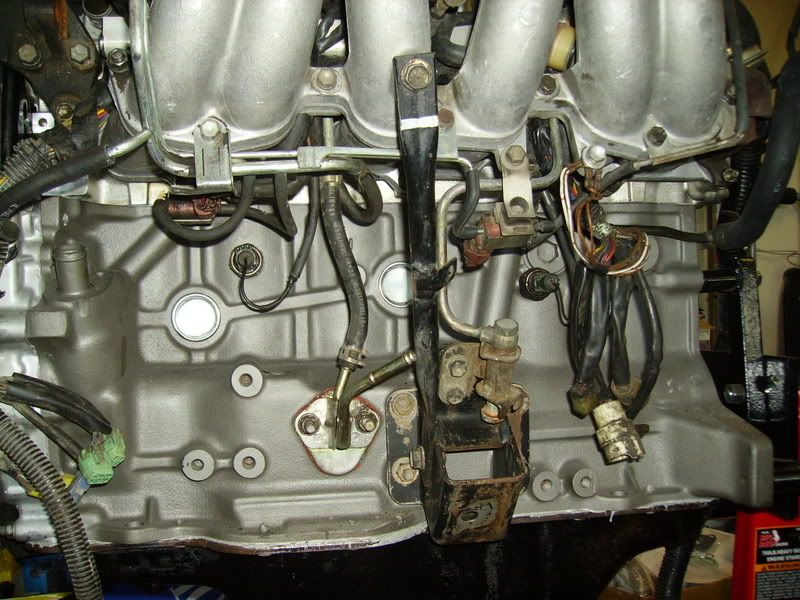

Ok, I was somewhat productive today, but I have some questions. First, Scott, I took some bolts out of an old na intake to y pipe and used them for mine, so I think I'll be ok as far as bolts are concerned.
Pic 1
I got all the vacuum lines installed and I'm not sure but that vsv on the right just doesn't seem like it belongs there but it was the only place I could find for it to fit correctly. Does everything look right to yall?

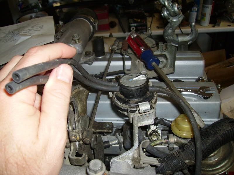

Where do these go? And why does the TSRM show only two vacuum outlets for GTE instead of three like this modulator has on it? The diagrams (I found) were not that clear on what goes where.

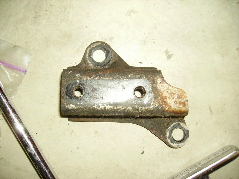

WTF is this? I found it in my little baggie labeled 'intake side motor mount and starter bolts'. Well I can't figure out where it goes and don't remember taking it off.

Mk3runner said:
hey gtsfirefighter, those two lines you were talking about go on the throttle body.
I don't see where they can go on the throttle body. The nipples (giggity) on the throttle body already have vacuum lines that are supposed to be there. I'll go look again though.

hmm, I could be wrong.. if I had my supra here I would be of more help. but all I got is a bunch of diagrams right now.
Mk3runner
Nov 19, 2006
2,033
Nor Cal
thats about it... thats all I got thats useful.. all my other ones are for only two vacuum lines and not three
keep in mind one was used to show egr delete. but try to look past that.
That first one is not a GTE. It has three vacuum nipples on the throttle body, which is GE. I've got a complete GE intake sitting in the garage so I looked. Also it is showing a fuel filter under the intake, which probably mean a Cressida engine. Thank though:icon_bigg !!!
I had two egr's laying around, one from a GE and the other GTE. I couldn't tell the difference in the actual egr valve but I'll bet I've got a GE vacuum modulator on there.

I just looked at mine.. mine only has two vacuum hoses. one going to the egr and the other going to the vacuum hard line under the intake manifold.
added: are you sure you have the correct one.. all the ones I ever seen only have two outlets and not three.
Yeah, I'm pretty sure I have the wrong one. :/

ah, kinda figured.. but he has a gte. so doesn't that mean he would need of with only two outlets.. thats why I was getting confused.
so in that case, its junkyard time.. or find someone who has one laying around.
yes, that right VSV is in the right place
wrong EGR (I'll run to storage, I'm sure I have one out there, but finding it is gonna be the tough part)
that's the bracket for the dampener on the driver's side of the engine that bolts to the frame

Hey Thanks!! After talking with Scott (ForcedTorque) I went out and looked and figured the bracket out. It will go on today.
I already planned on taking the Dremel to the water inlet. Because of the flash it looks much worse in the picture than what it does in person. Oh and thanks again for the vsv confirmation.

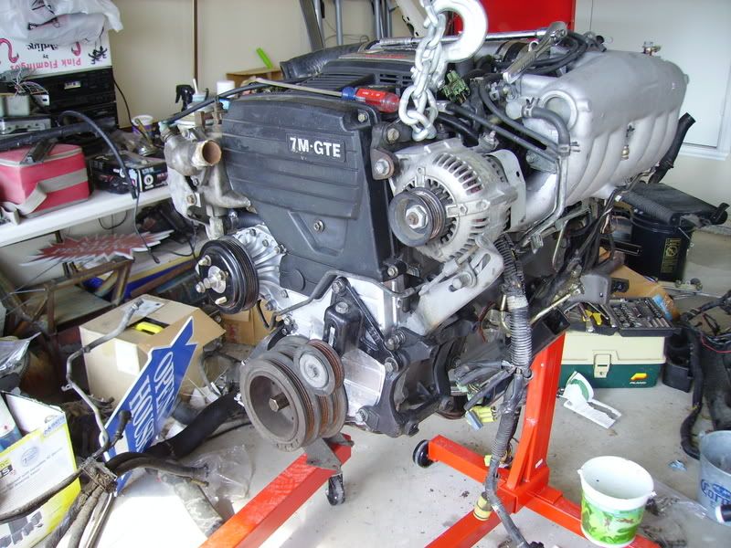

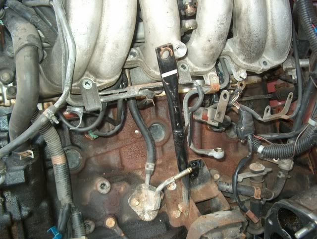

Edit-some pics. And yes I know my garage is trashed.
