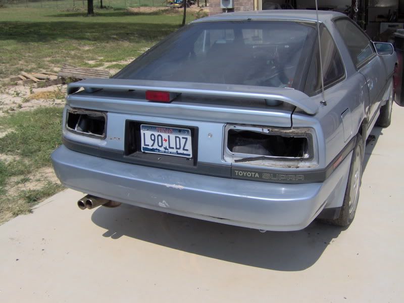

Well this morning, just so I'd feel like I accomplished something, I removed the taillights, ignitor, resistor pack and something else I forgot from the blue car. I just need to get the diff off now but will wait till it cools off a little outside first.
It really breaks my heart to tear this car apart too.

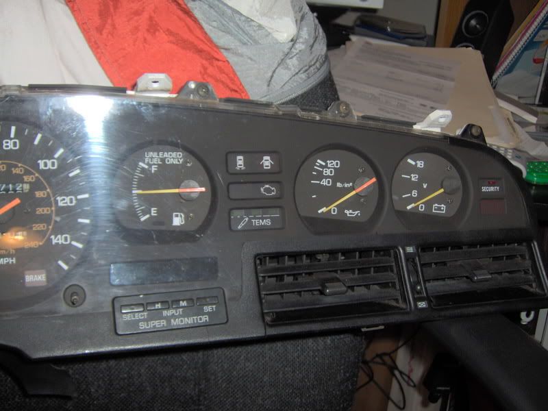

Then I took the instrument cluster from the blue car and replaced the clock with the supermonitor display and button panel. I then took the boost gauge out and put in an na voltage gauge. It's from an 89 so of course the needle is different. That might just might bug me too much though. I'm thinking when I tear the dash out to replace the harnesses, I'll take the volt gauge out of it and put in the other one so it'll all look the same. Here's a pic of after, sorry no before.
