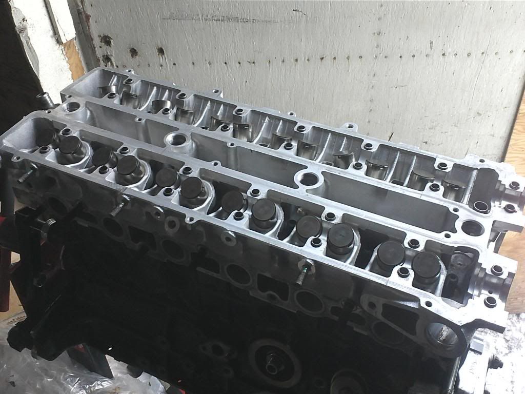

Did pick up my head from the machine shop though. I'll post pics tomorrow.

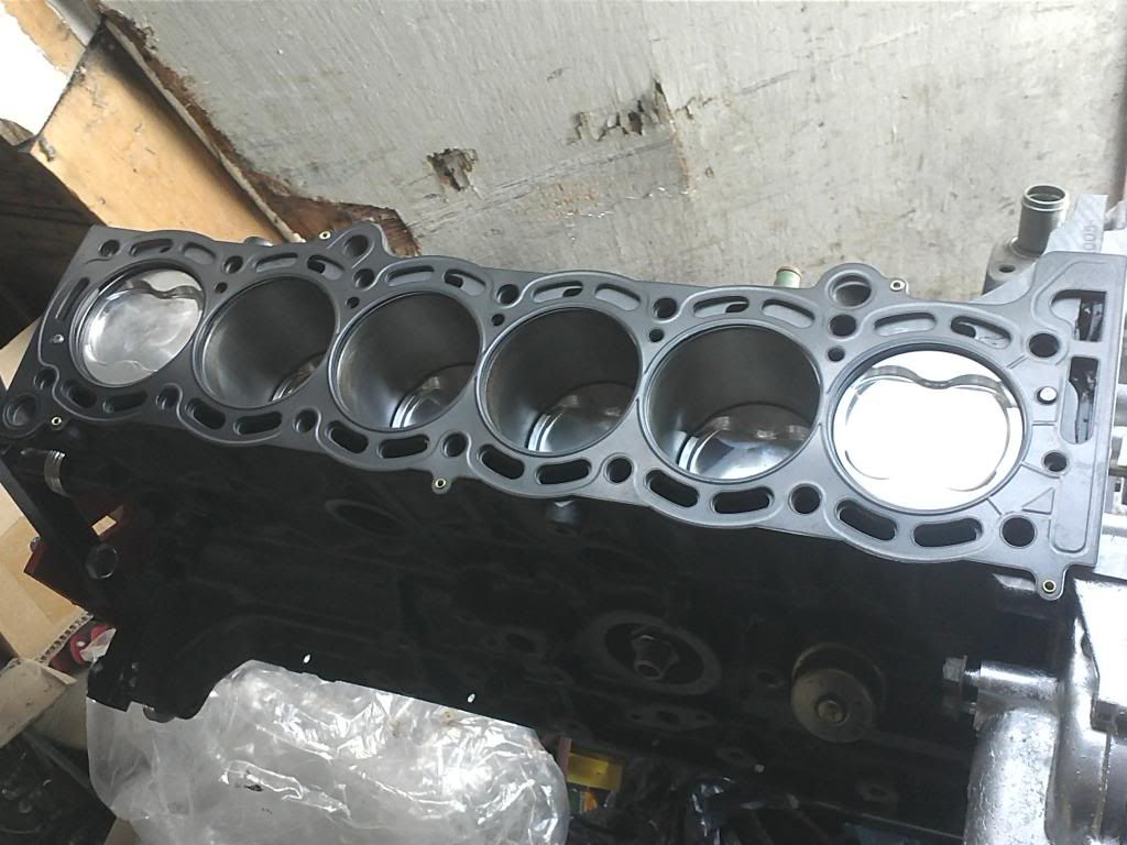

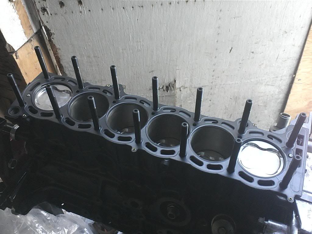

Put the pins in the block, put on Titan 1.4mm MHG.
Install ARP head studs.
Put cylinder head on block. (Almost forgot to put washers in the head before dropping it onto the studs. Yikes.)
Pro tip: assembly lubricant stored in an unheated garage at -20 degrees does not come out of the tube. I have not installed the nuts yet for this reason. I'm warming up the assembly lubricant now so that I can torque them down to 90 ft-lbs.
I figure that there will be some time where the block will "heat cycle" between -30 degrees or so and +15 a few times before I'm ready to shim the cams, so I'll re-torque them before I do that. It's not a "real" heat cycle, like operating temperature, though so I'll have to do it again after installing the motor.

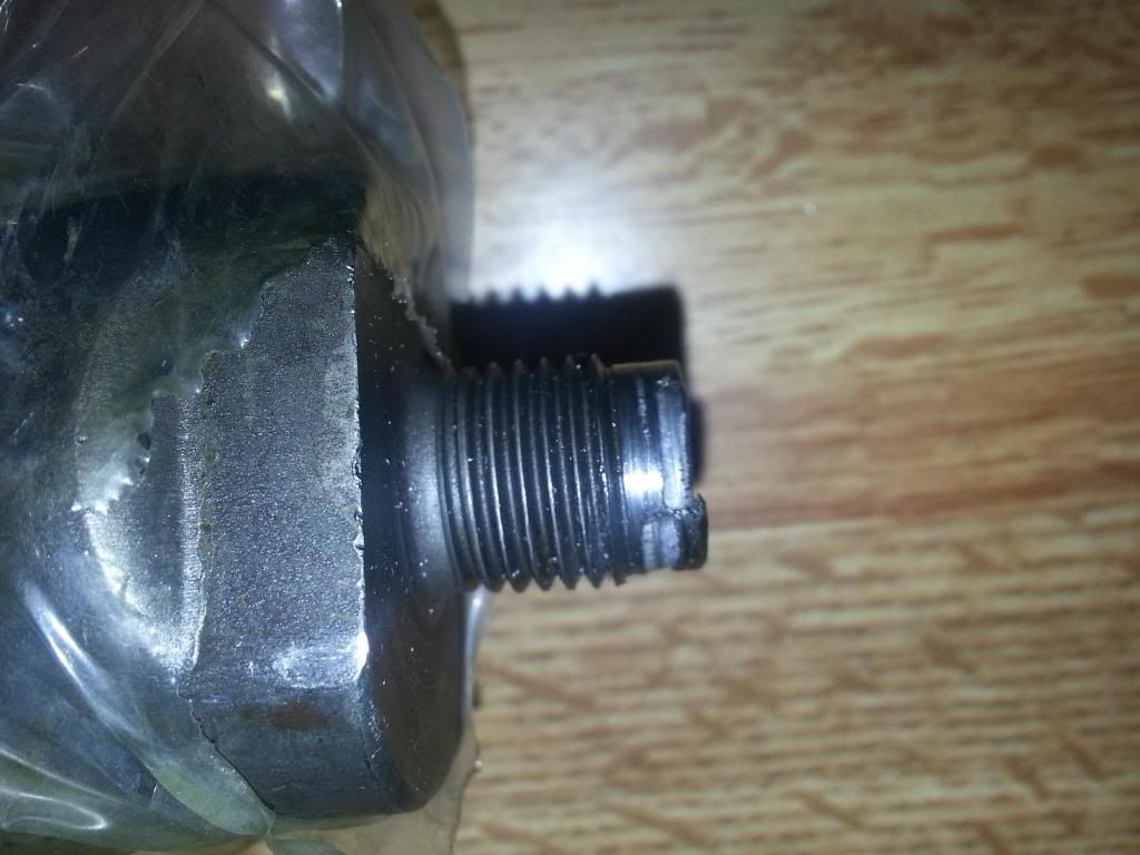

Tried to install BeechPerformance steering rack spacers and stripped the inner tie rod while torqueing...I should have realized that with less thread engagement the load on each thread would be higher than normal. Lesson Learned
