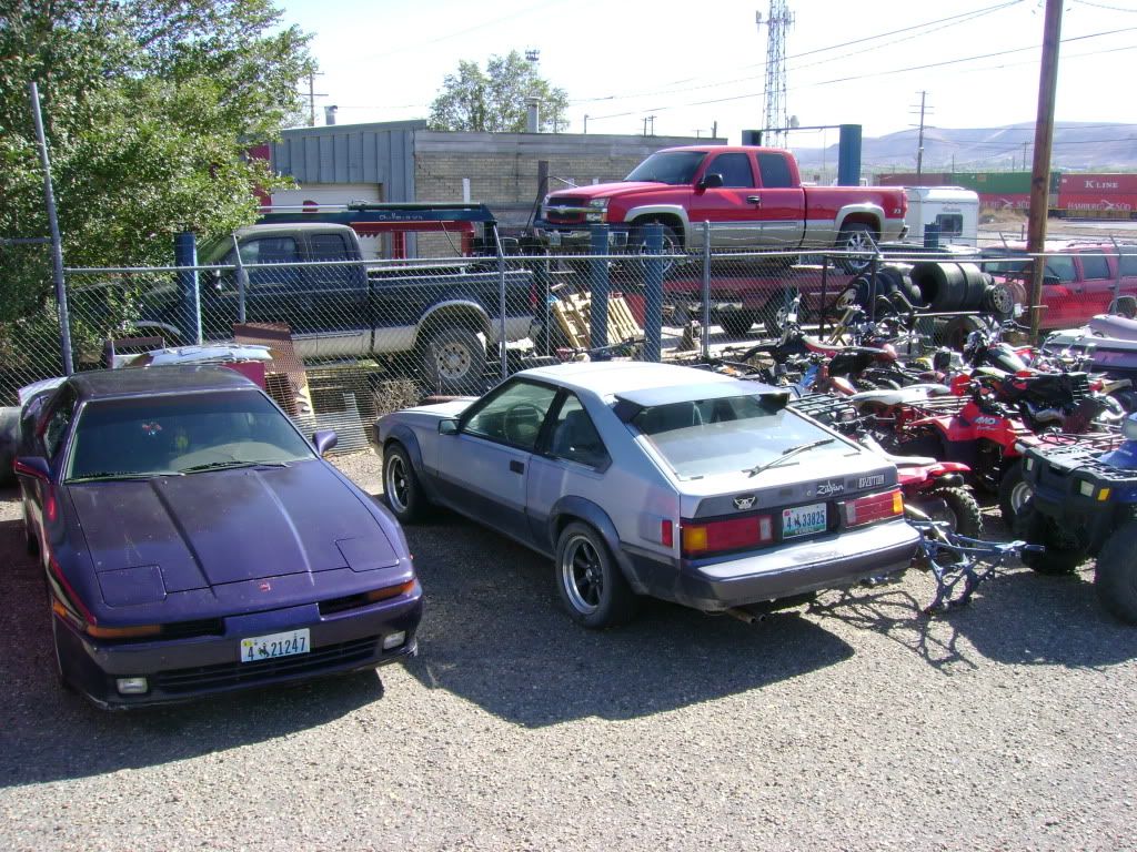

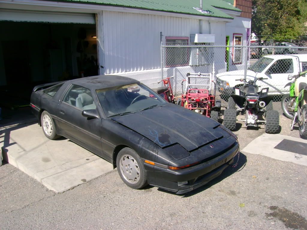

I took a picture of my 84 and 89...

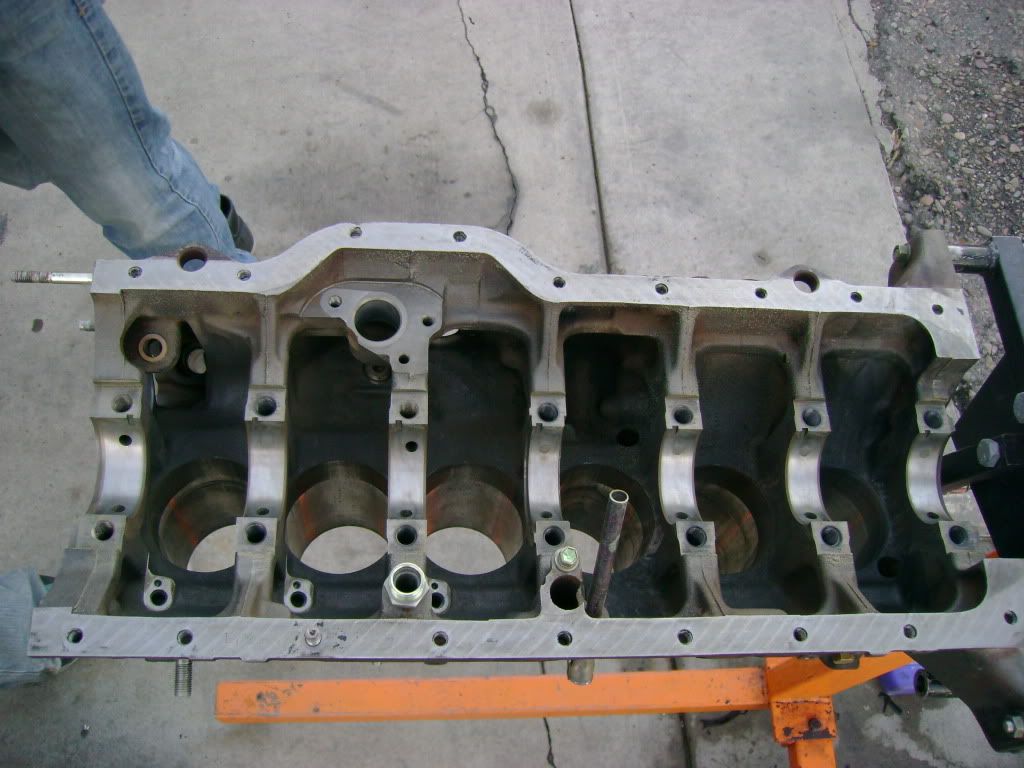

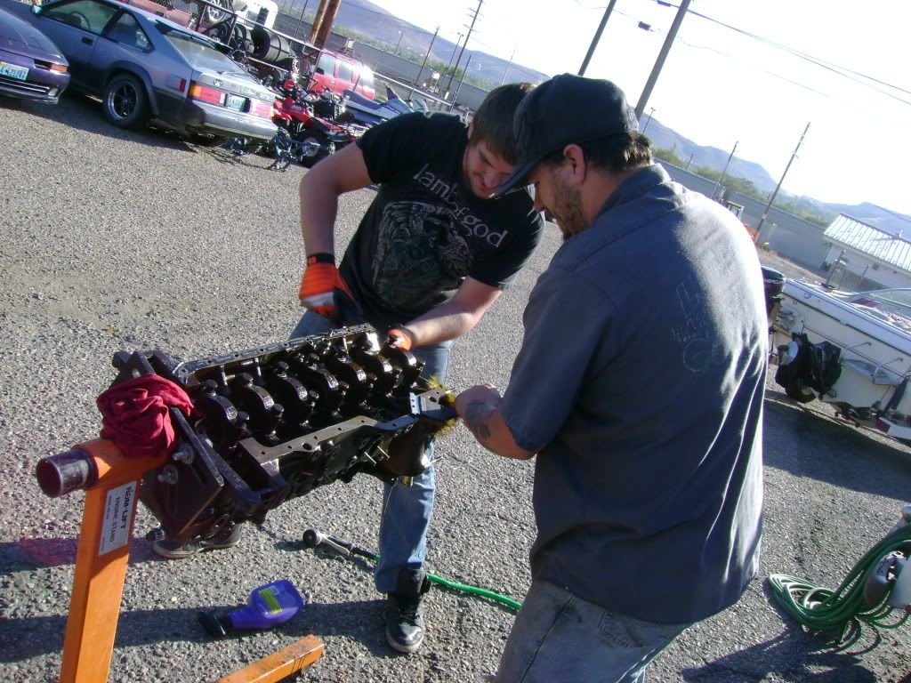

As well as did a little teardown/cleanup on the 7m that came out of the 87 I have (widebody shell, in case anyone is wondering)...

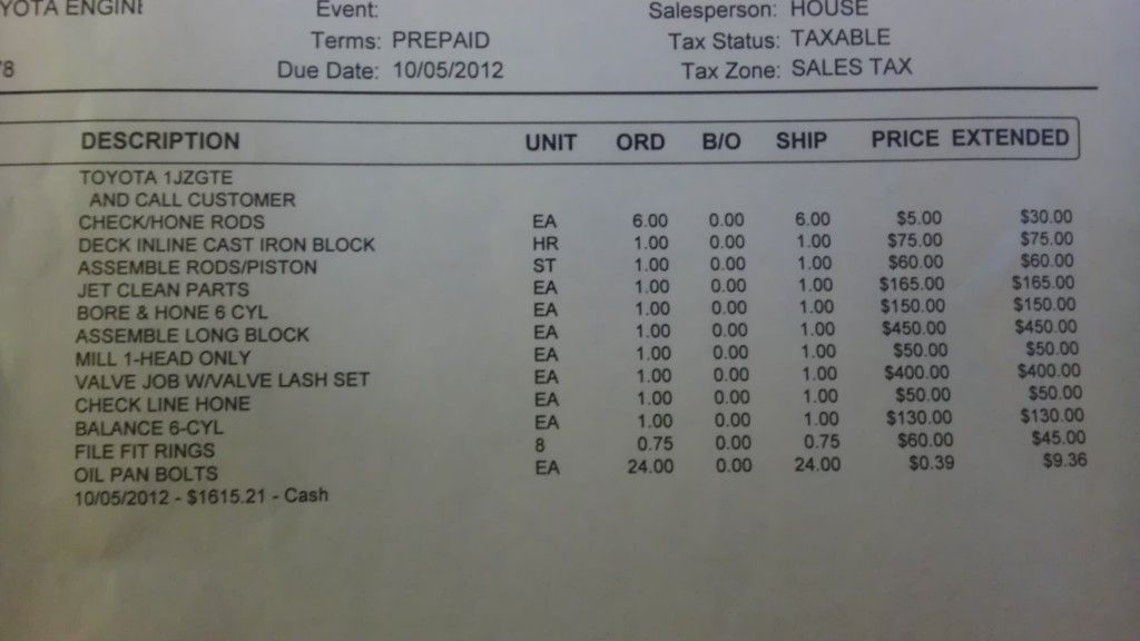

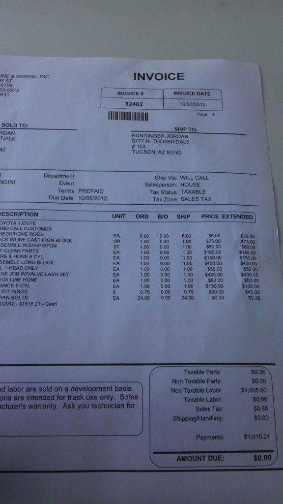

$1,600 for all of that, I expected it to be a lot more but makes it difficult to see what you had done with the list being cut off lol
Yeah they are a little pricey everyone told me that they were the best in town by far but they are on the pricey side of things but hey you get what you pay for right?

Edit: this was for a 7m btw and im furious to see your assembly was only 450. ive been robbed

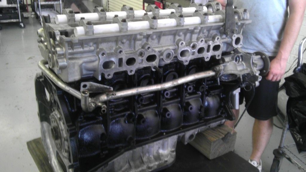

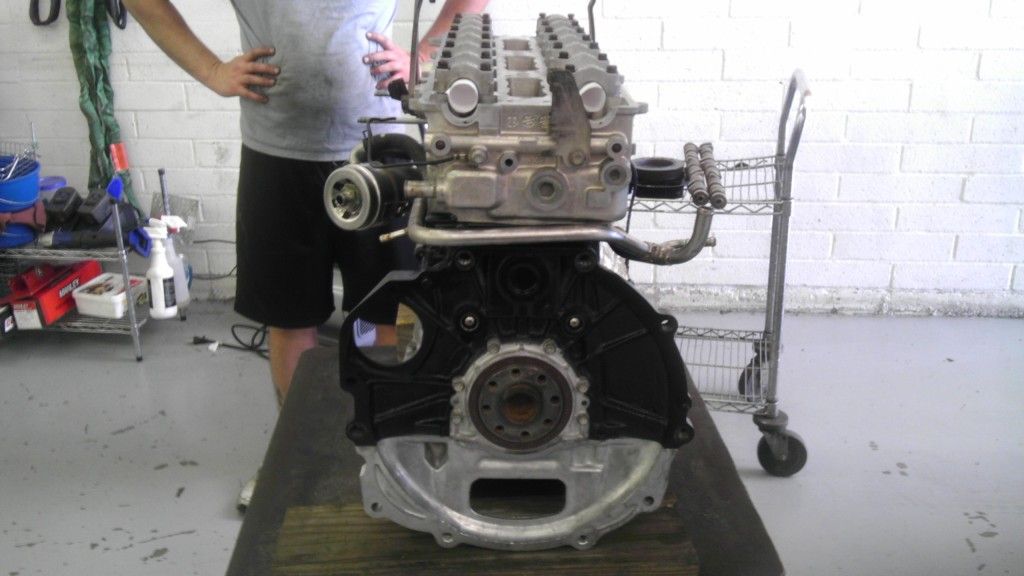

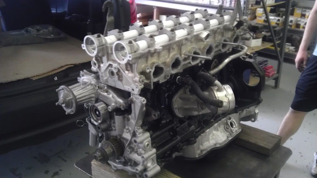

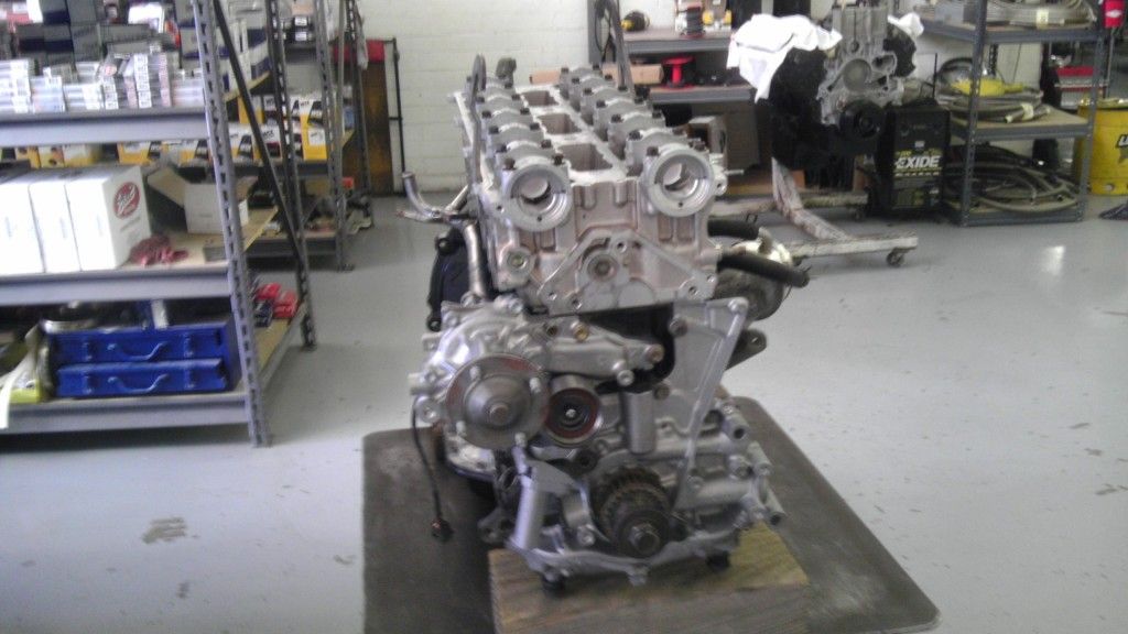

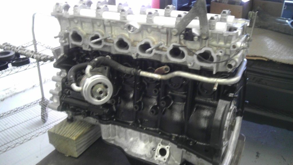

Idk if i'd say its the works.
I brought it to them with the cams out but the head was still bolted on they cleaned and painted everything for me Cam gears/pulleys/oil cooler/Sump ect
Also its a 1JZ-GTE
Disassemble
New freeze plugs (they provided but didn't charge)
Cleaned up my old Stock pistons
valve job new springs and retainers/valve seals
The sump from front to rear they cleaned both parts
Oil pump
Honed once to find out i needed to go .020
Bored and honed again
balanced crank
Check/Honed Rods
Rings and pistons
main and rod bearings
arp head studs were installed and head put on by them
oil pan out on
oil cooler cleaned and put back on
crank dampner cleaned and painted
cams cleaned
new timing belt tensioner installed
Decked head and block and installed metal head gasket
The way you see it in the pics is how i picked it up from them.
They took it upon them selves to paint and make everything nice and pretty for me.
