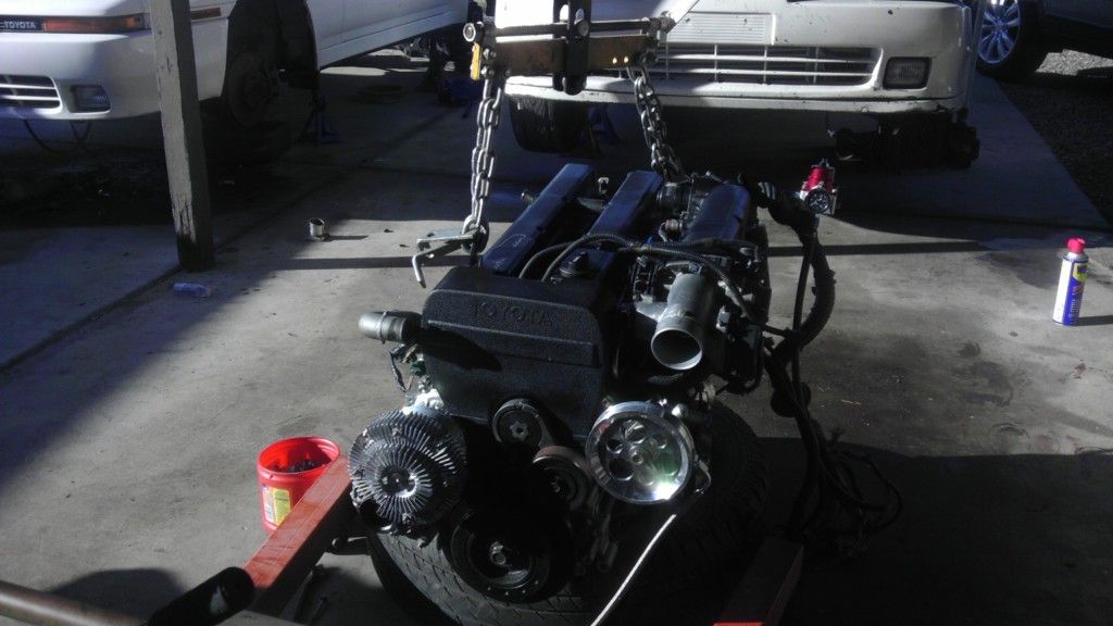

Taken right now

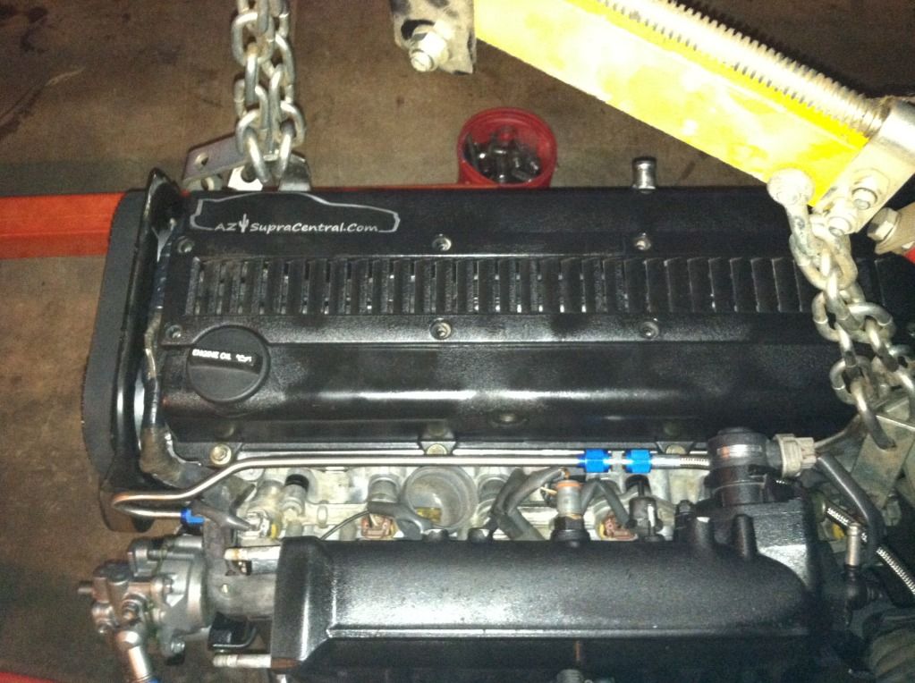

I dig the AZSC sticker on the valve cover... gives me an idea.
