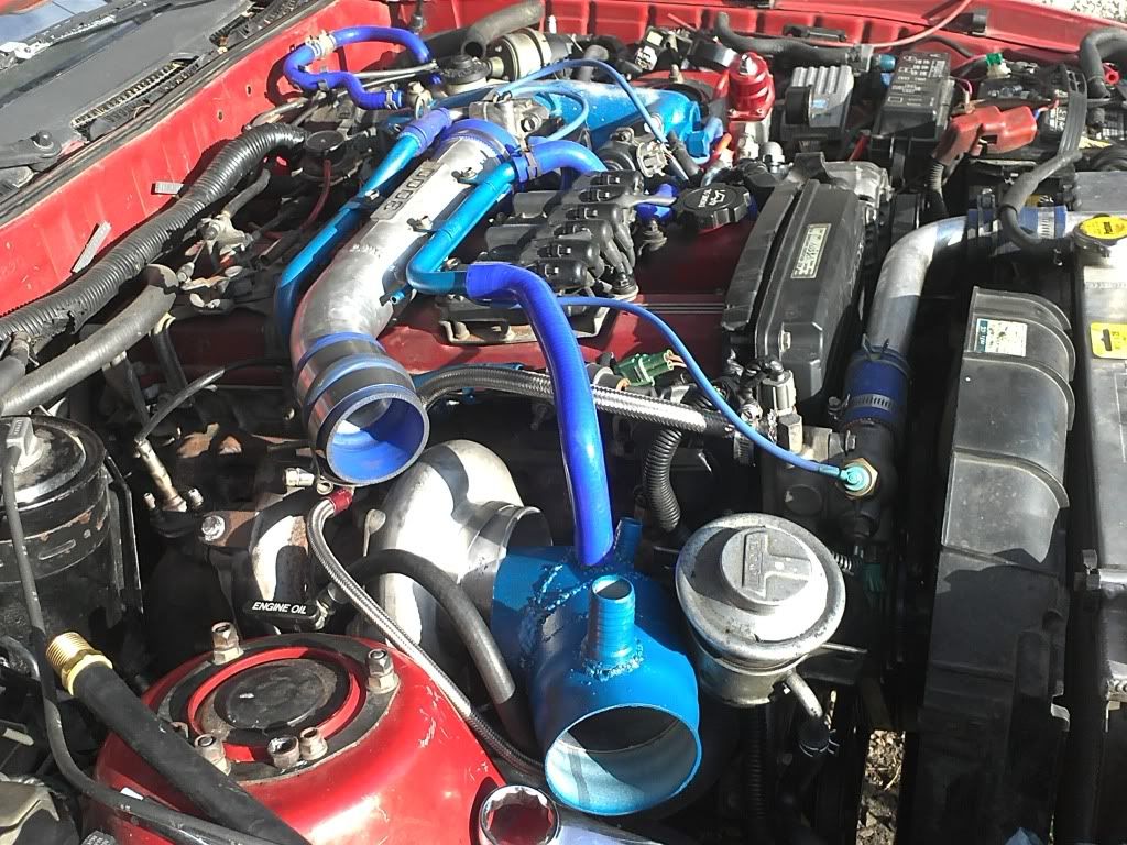

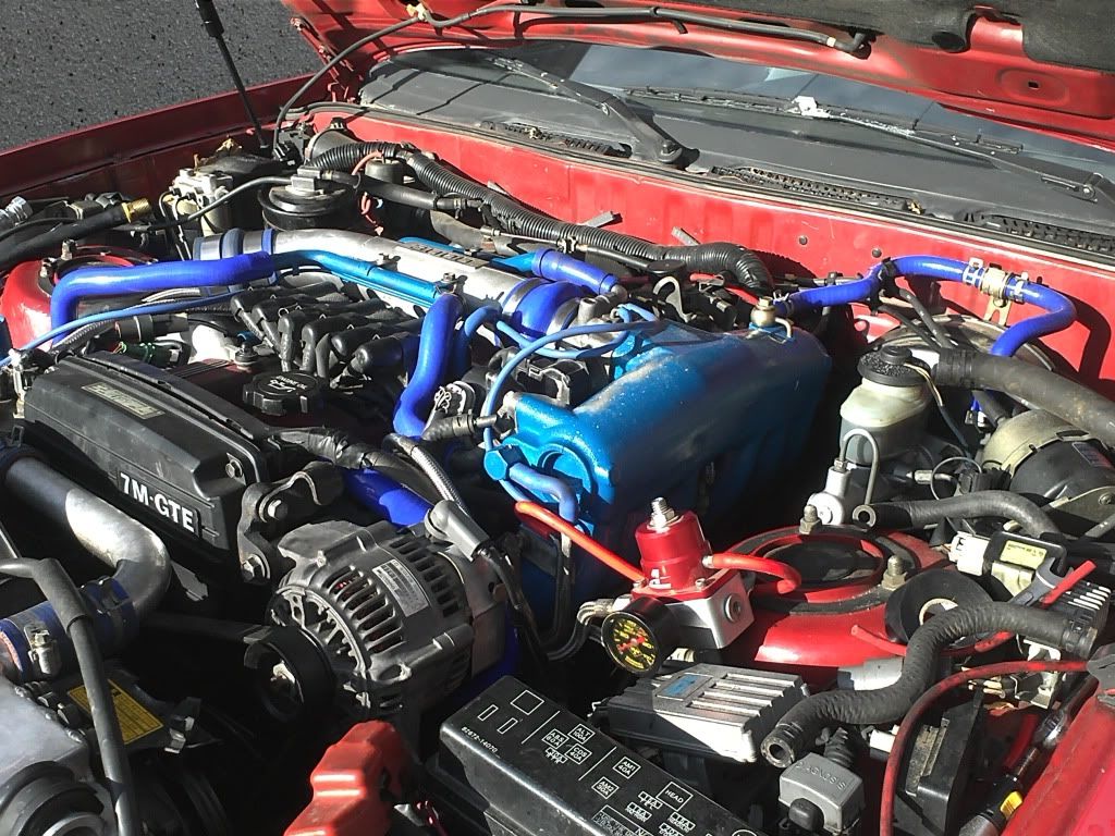

Well the last couple of weeks' puttering under the hood, and it's starting to look like an engine in there.
Visually, it's quite different, with some of the powder coated pieces being installed, and a lot of the eBay mafia blue silicone pieces. Fact of the matter is that it's not that different mechanically on the intake side, with the upgraded injectors (Which of course are completely invisible) being the only real change. The exhaust side is actually different, and not complete yet. I need to get this finalised, with some details of intercooler piping, intake piping, and the oil filter relocation/oil cooler kits still to resolve. (On that note, I bought some hydraulic line with 90 degree fittings for the adapter plate to extend the lines. This should solve the issue of placing the filter relocation kit.)
Intake side:
Exhaust side:
