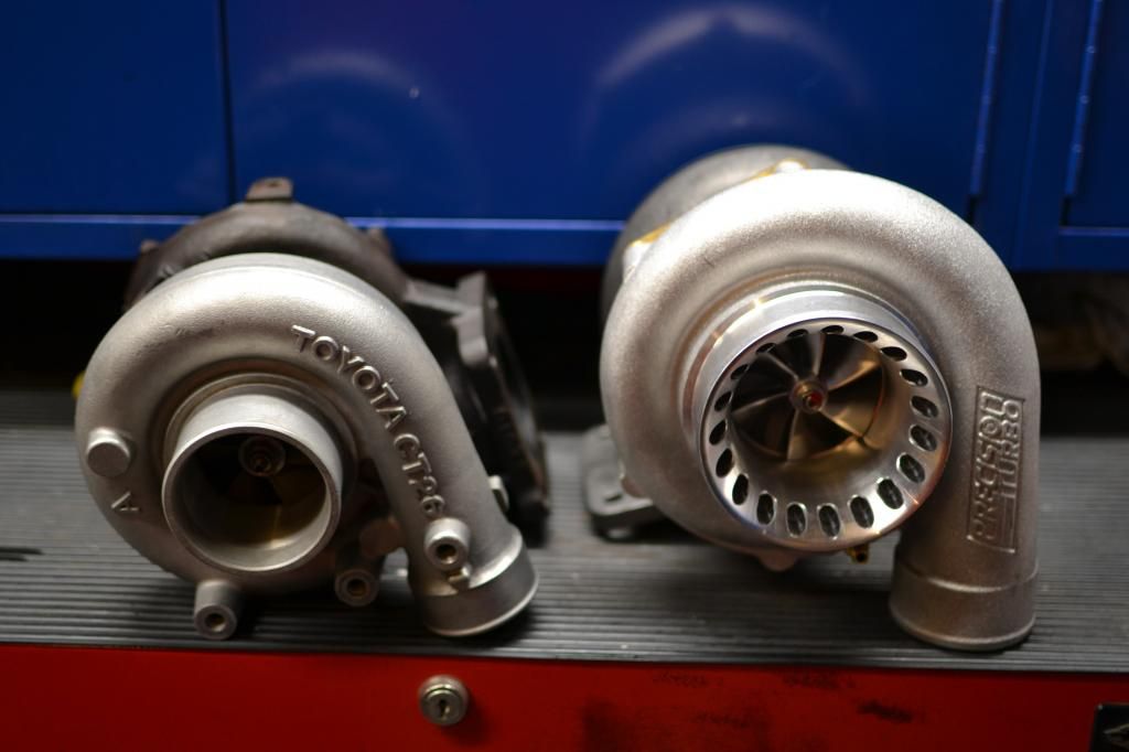

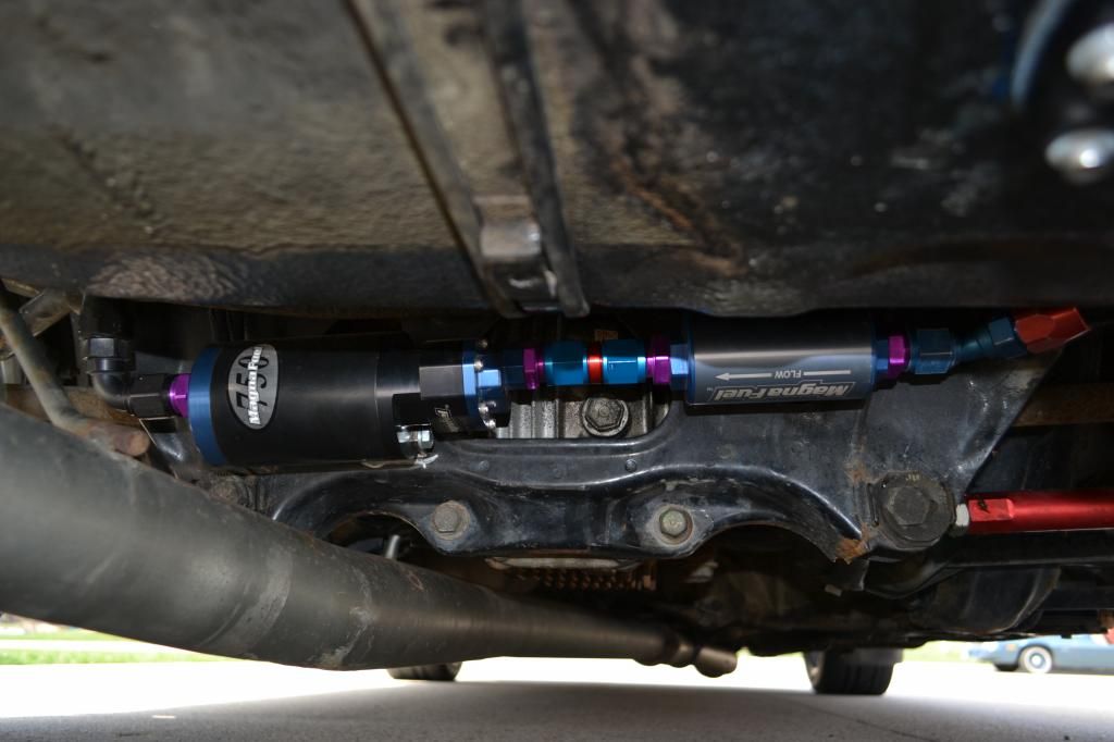

For anyone of you that was following my build, I had a ct26 57trim turbo with 550's, Lex AFM, and SAFC. With a walbro pump etc etc.
Well, I have since then decided to dump that whole set up, and I went standalone (AEM V1) and got myself a nice t4 turbo. (PT 6766)

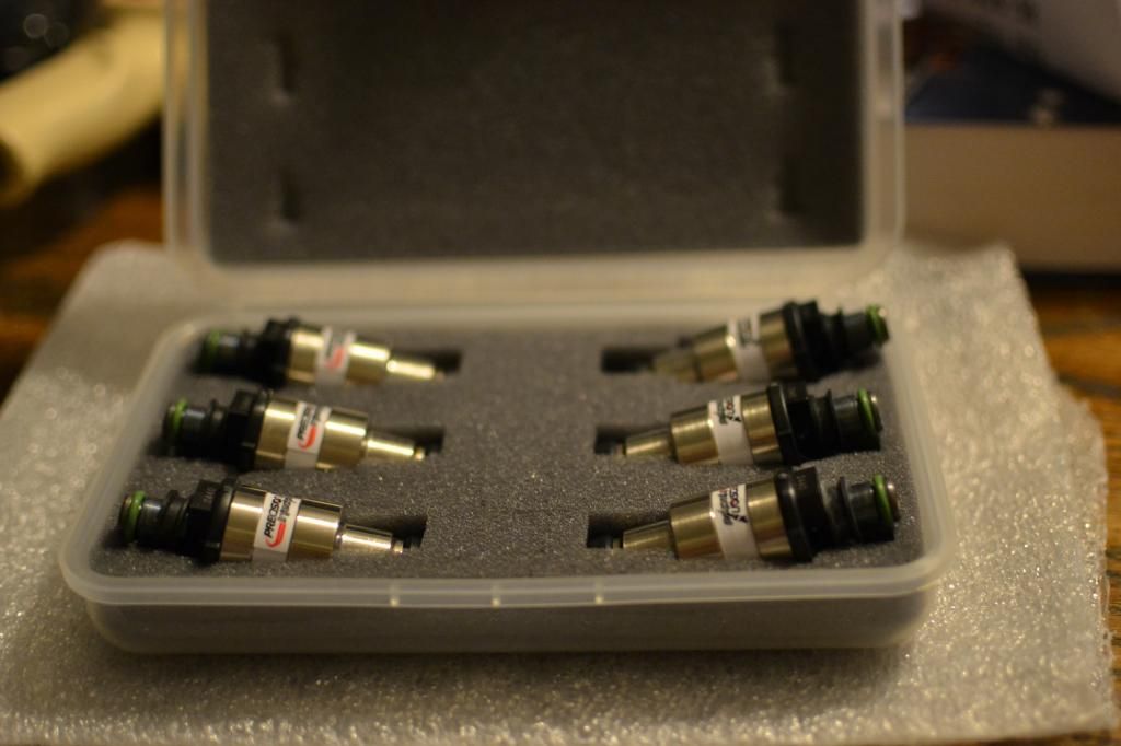

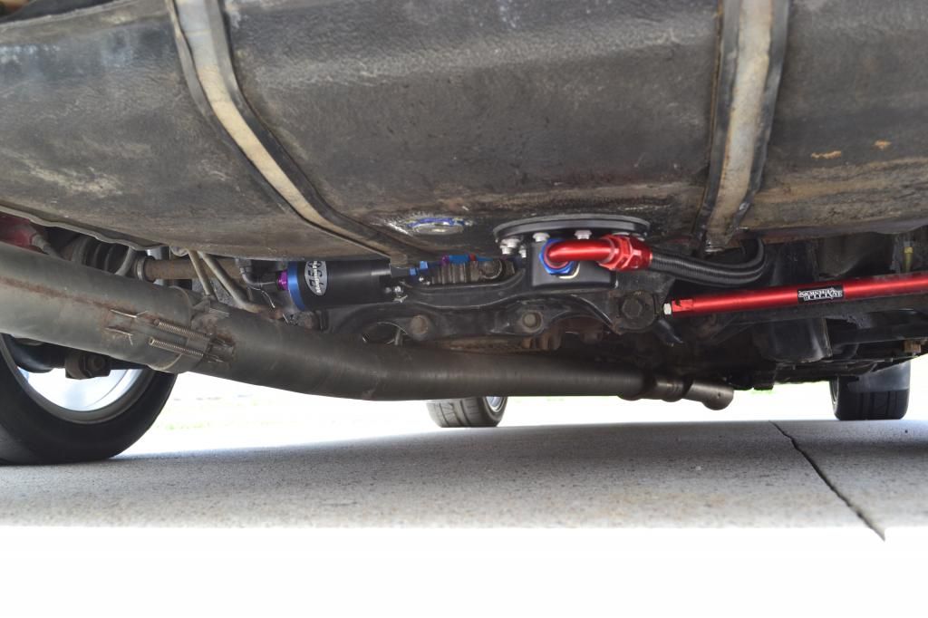

I was planning on running pump gas, and bought a pump and injectors for that set up. Well, I ended up deciding I would like to make more power, so I decided to go with e85. Now I have a big external pump, large lines, and 1200cc injectors.
Plan is to be on the dyno on the 24th of may, and I am not saying any numbers, but I am expecting some decent numbers for a stock head gasket and engine.
Here is a quick video I took with my go pro the other day.

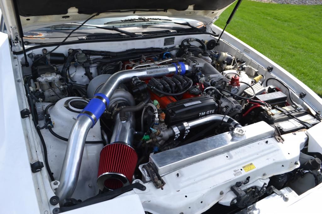

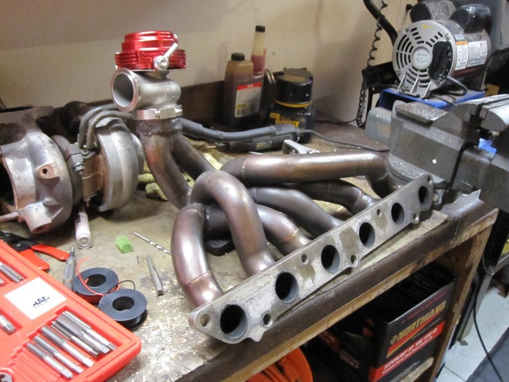

Here is a few pictures of my updated set up. I still have to have the stock BOV port blocked off, and have my new flange tigged on at a different spot. Also going to be changing up some things here and there, but this is where I am at at the moment.
