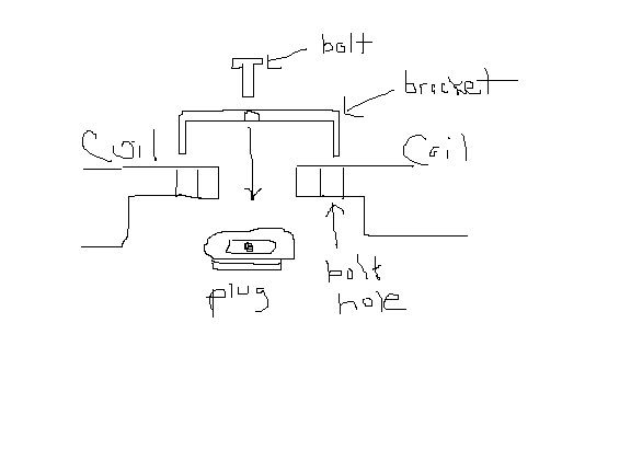

I keep forgetting to bring my camera to work, but for the mounting tabs.....One coil sits on # 6 plug...I made an L- bracket that bolts into threaded hole on rear oil galley plug. The other two sit on top of #2&3 plugs with the bolt holes facing each other. Between #2&3 is another oil galley plug, but only the rear one is threaded. I'm taking the threaded one from a spare head and putting it in between 2&3. This high tech drawing should explain the rest. Clean & simple....just the way I likes.....verrrrry nice....much success!

The edges of the coils actually rest right on the edges of the plug already , so its solid and straight, bolting down doesn't tilt them any;)
I see there is the rear galley plug w/ a hole in it, but it is not threaded on mine. Did you tap yours?
