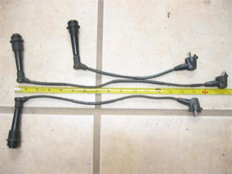

could someone do me a favor and get me the lengths of the plug wires? are they all the same? could you measure just the inside cable(between the ends), and then the overall?
thanks
Heres the 3 lengths:
Overall
Short: 10.75
Medium: 15.5"
Long: 18"
Just the wire
Short: 7.75"
Medium: 12.75"
Long: 15"
