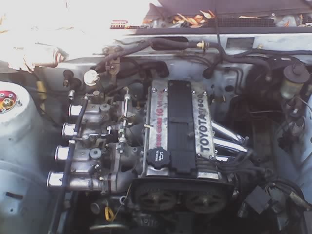

I was thinking about running these on my 4A-GZE, and using a 4A-GE center cover, which is open on the one end (front of the engine), do you think it's important for it to be vented above both coils, or would it being vented at the front and rear be enough ventilation?
I just don't really want to modify the OEM center cover at all, but I don't know how much ventilation is required.
This is of course assuming the OEM cover will even fit over them, but I *think* it will.
EDIT: This is the cover: (The part with the plug wires going into it, is the opening I was referring to at the front).
I've never determined out much is "enough".
The MKIV stuff usually has vents down both sides of the cover. Generally I follow the way Toyota designed something unless I can find a good reason not to.
If you look at the Titan Billet cover for the 2JZ below, you can see they duplicated the factory vents almost exactly.
The six red arrows show the vents.
Each one is about 1/4" x 5" and there are 6 of them.
That's about 7 1/2" in sq of vent. I'd try to duplicate that much vent area.
