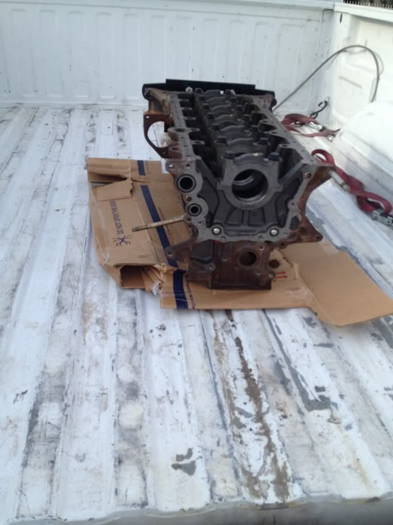

heres some of my motivation...lifted that into my truck by myself (truck is a gmc 2500hd on 35's and a 6" lift...i weight 130lbs lol)

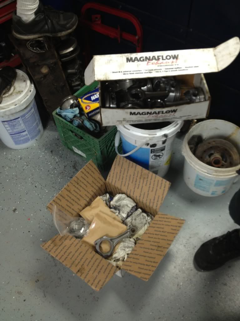

my box O stuff at the machine shop...guess whats next!

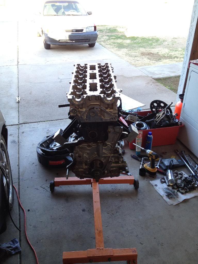

picked up this GE from a friend in a trade for some work

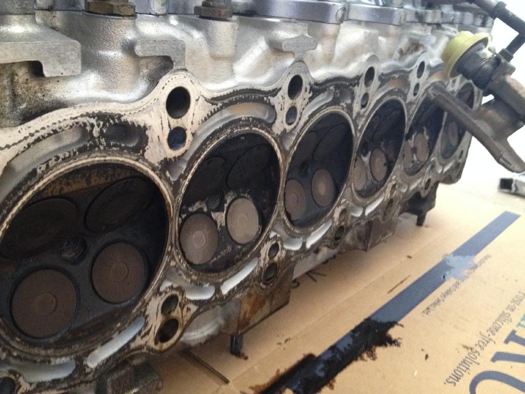

head

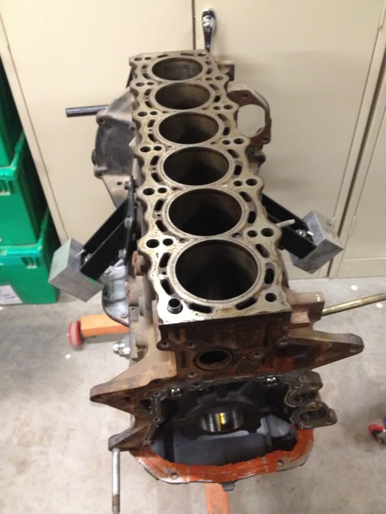

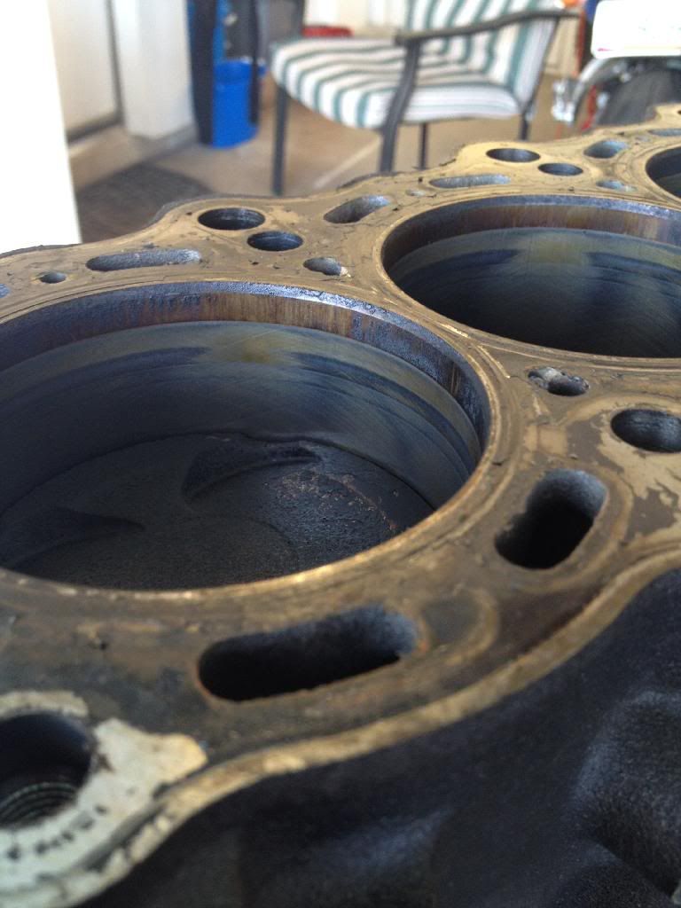

cylinders arnt too bad

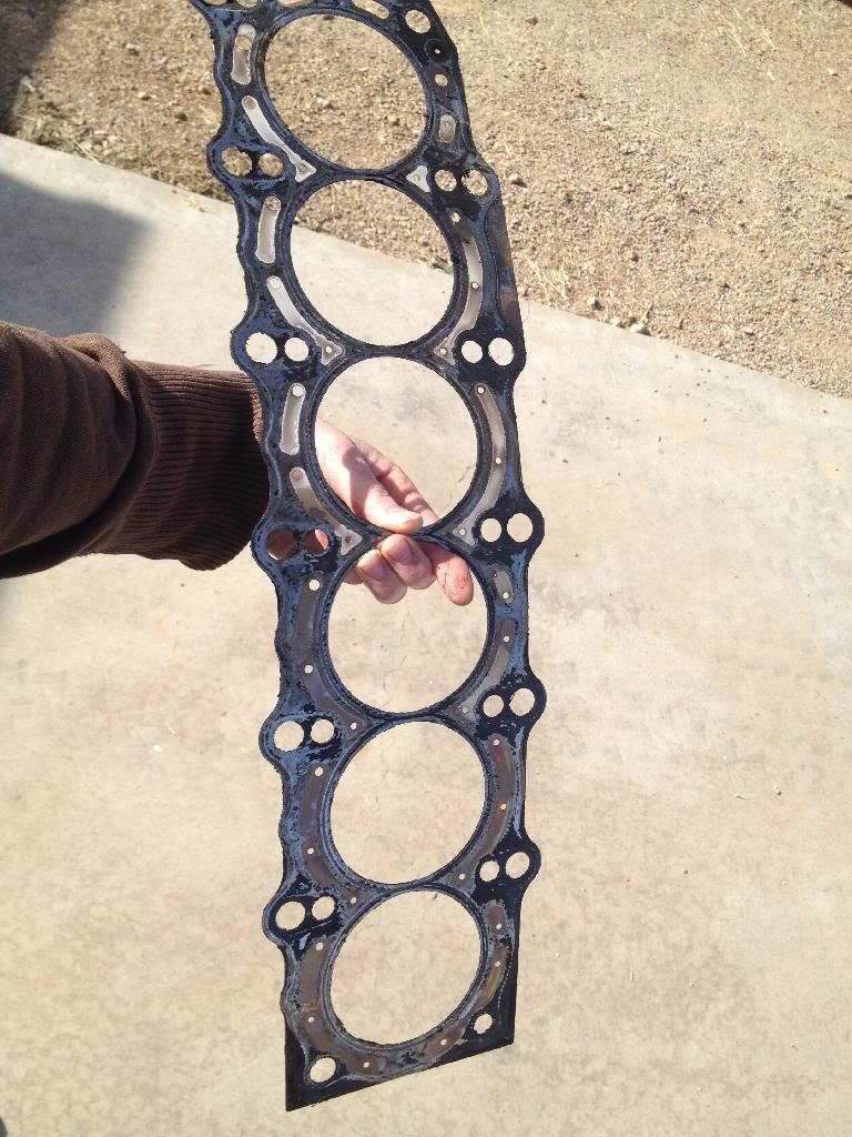

headgasket didnt look too bad either
before the clean up

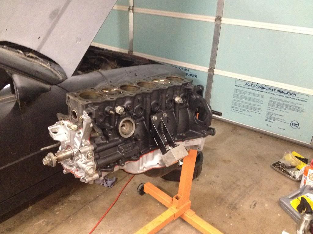

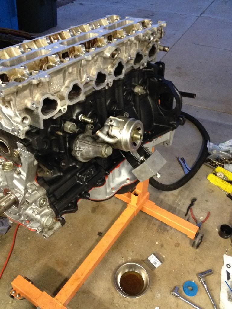

after clean up, new oil pump, new front and rear main, rear sump, and brackets on
things should go together quickly at this point but we shall see so stay tuned in

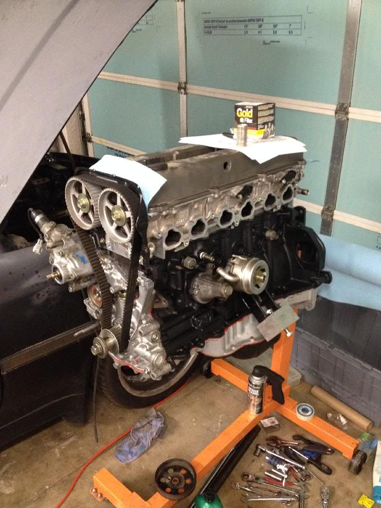

getting closer, hoping to get all the little bits on the motor finished this week and maybe drop it in Friday night.

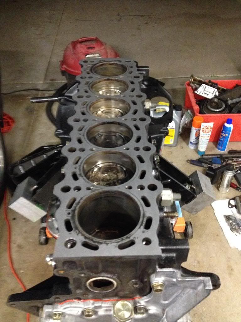

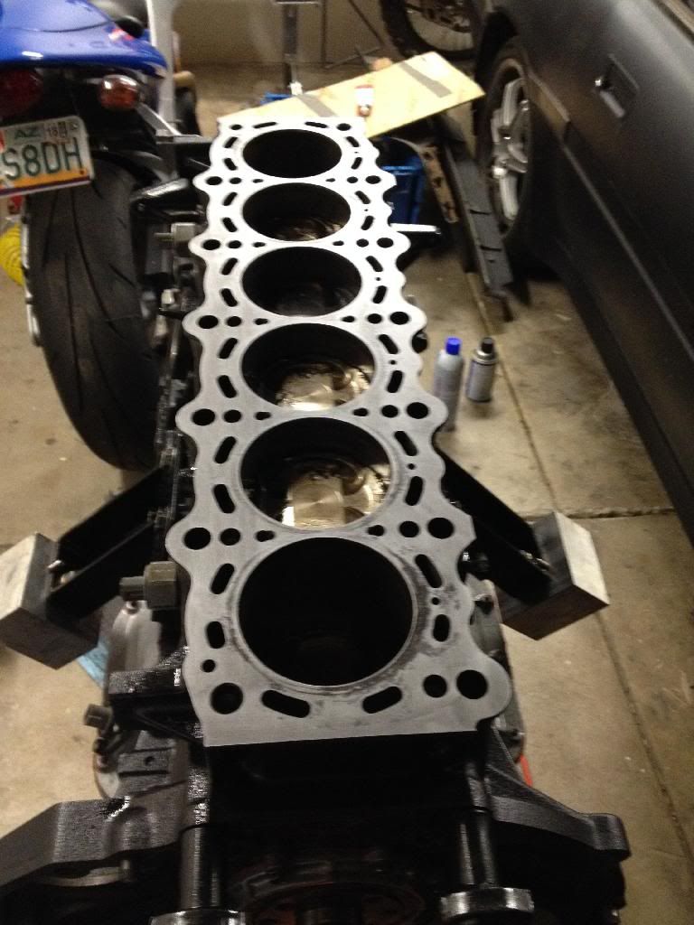

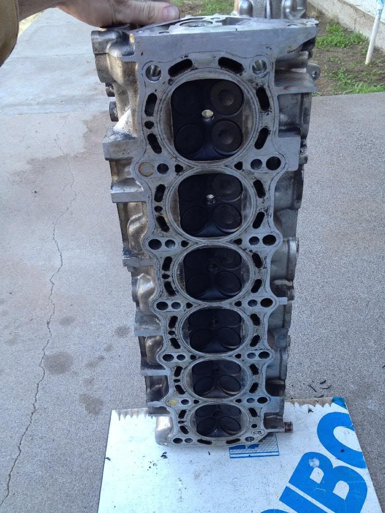

had to lap the block a bit, it cleaned up most of the way and what didnt clean up was less than .002 so i called it good.
cleaned up the head, came out good.

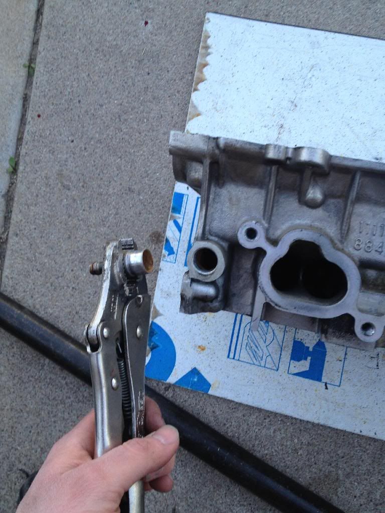

pulled the nipple on the side of the head and plugged it

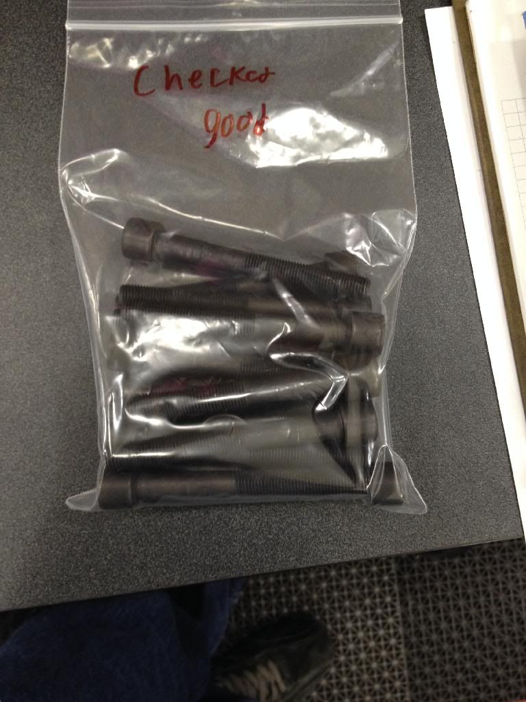

cleaned up a few sets of stock head bolts, inspected them and took the best of them. all bolts i used were on the high end of the spec so the were brand new more or less.
head on
oil cooler on

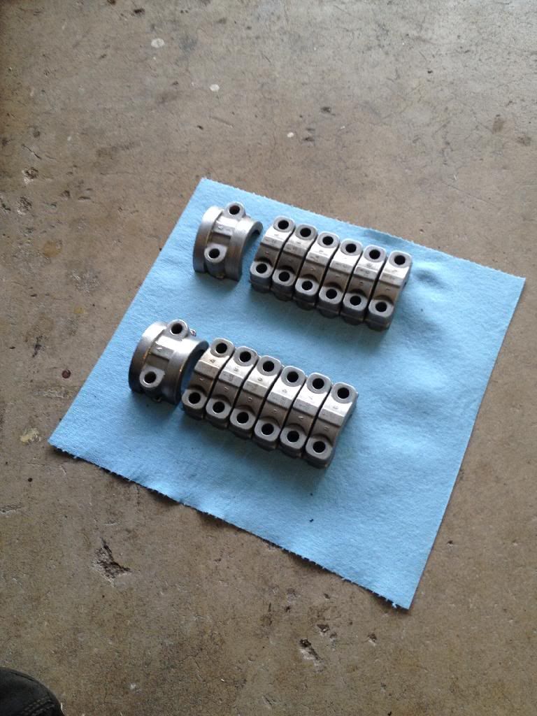

cam caps all cleaned up

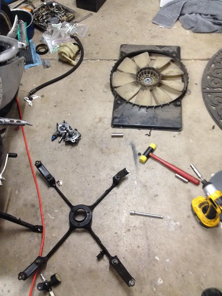

started pulling my hydro fan parts out that ive been collecting over the years.

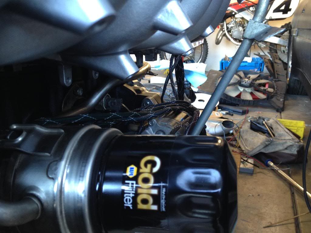

got my oil cooler lines in, and started bolting on accessory

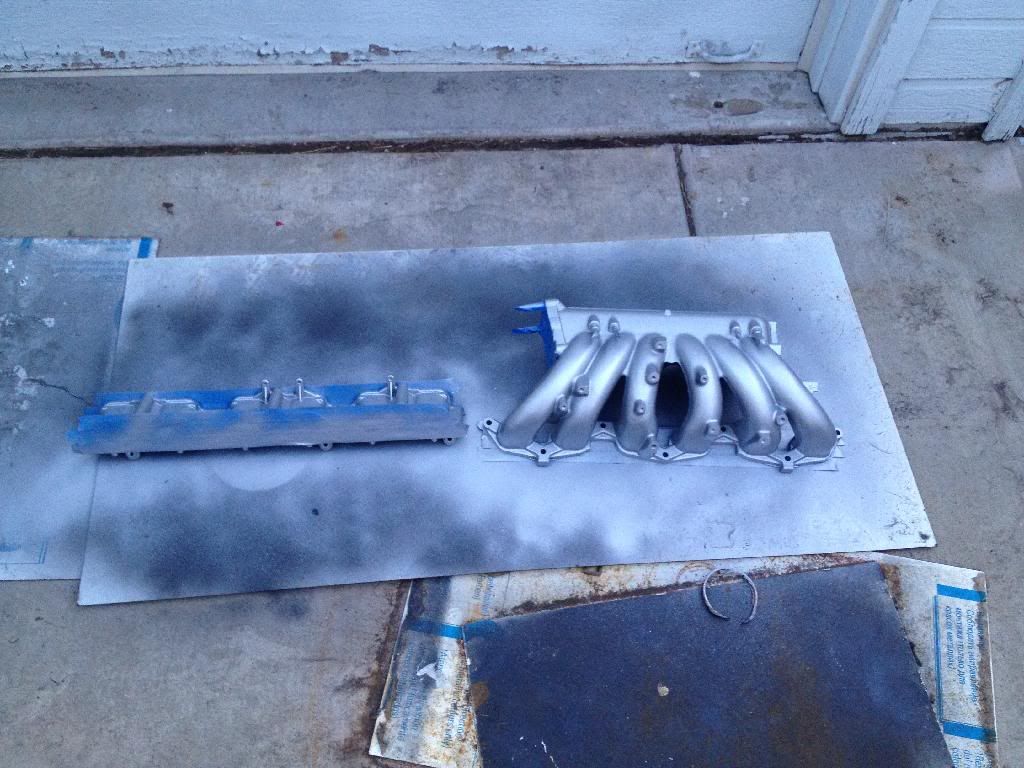

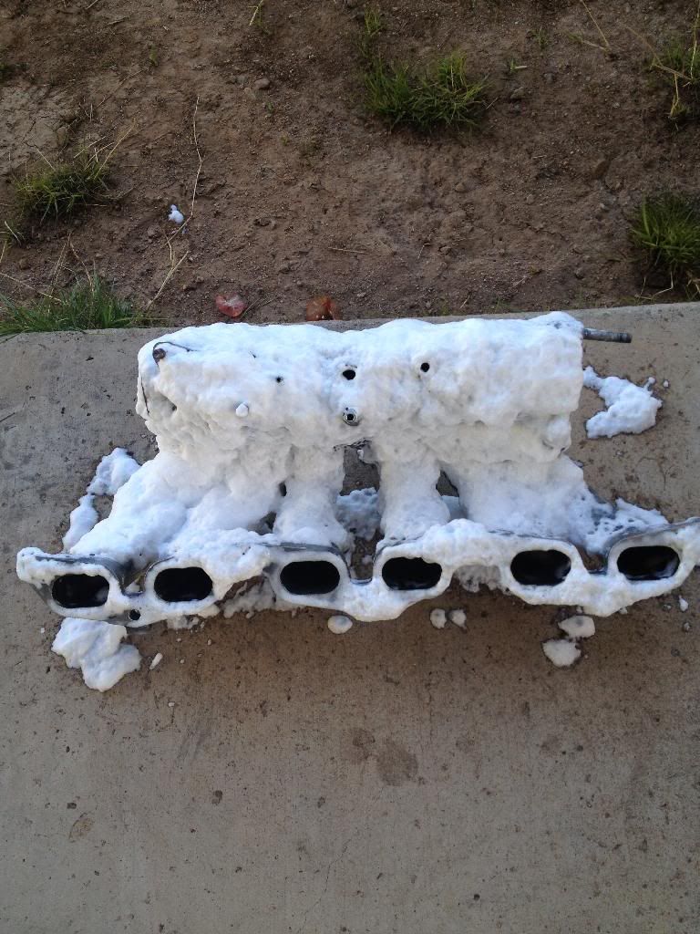

cleaned my manifold with magical jizz
then painted both manifold and runners

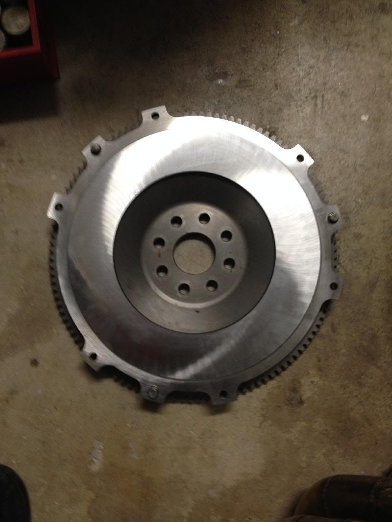

also had my flywheel resurfaced when we did Clint's v160 on Saturday

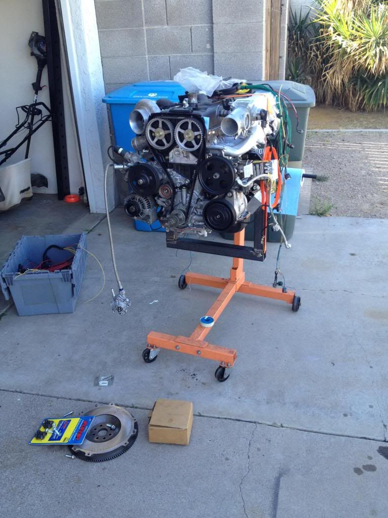

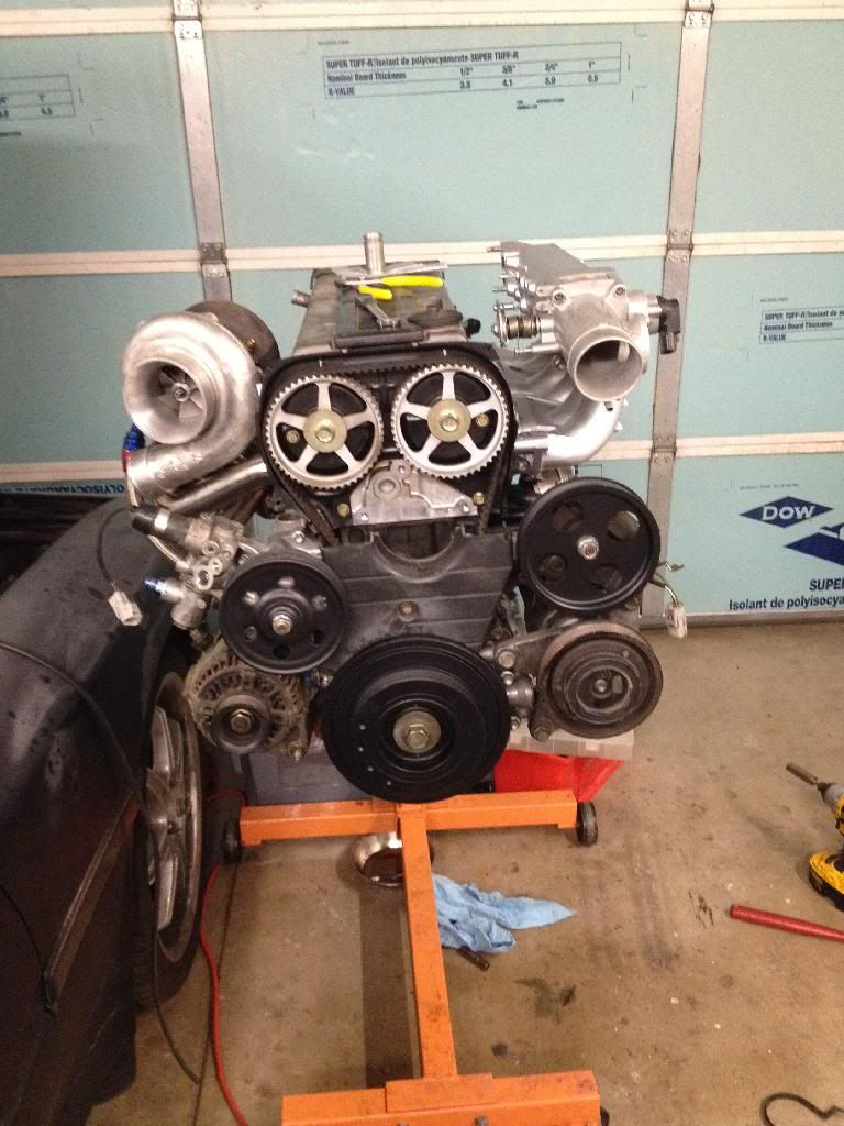

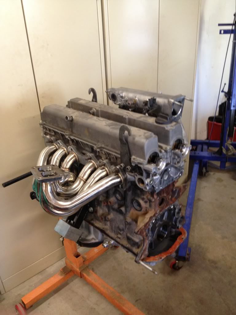

started getting turbo stuff on to start getting my wastegate welded on and downpipe ran
tossed on the rest to start making a list of random bolts and what not i need

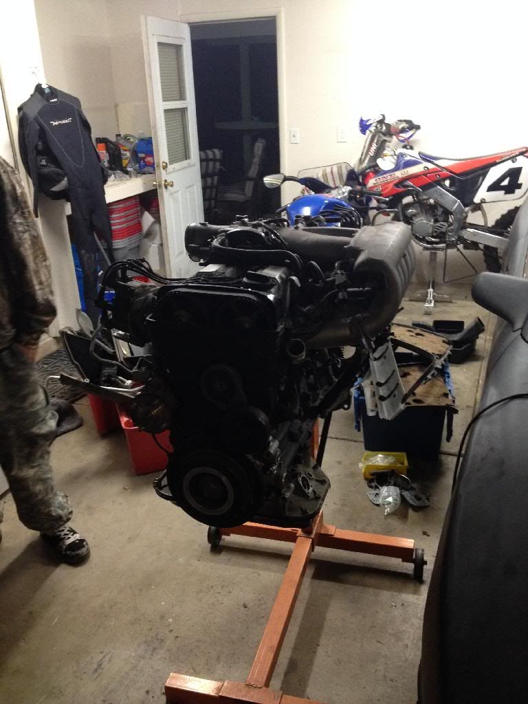

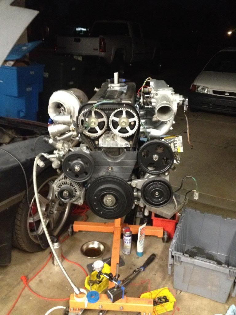

motor is still outside of the car had a few things that set me back a little bit but hoping to get this done soon, just need to sell off my stinger to get $$$ to buy stuff.
extension tube for the 1.5 setup with a hydro pump
getting there...i see wires!

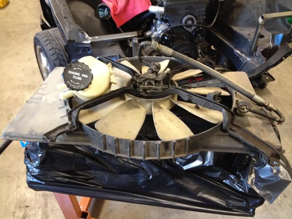

hydro fan was nasty so i decided to clean it up a bit

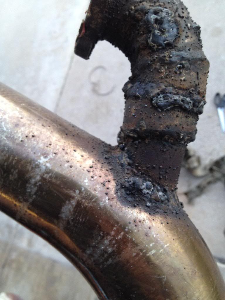

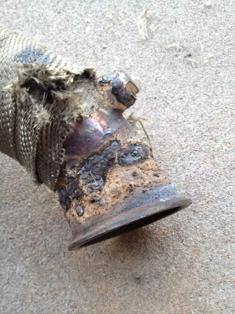

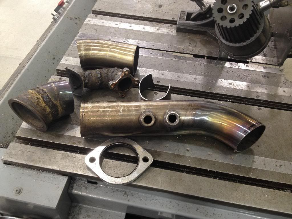

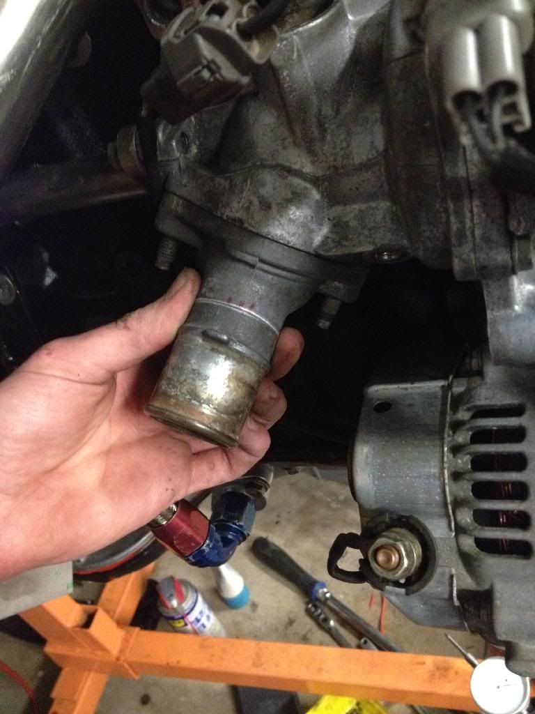

then went to put on a downpipe i bought a bit back...i was unaware of this until i unwrapped the exhaust heat wrap :X
...not too sure but i think someone was trying to weld...:nono:

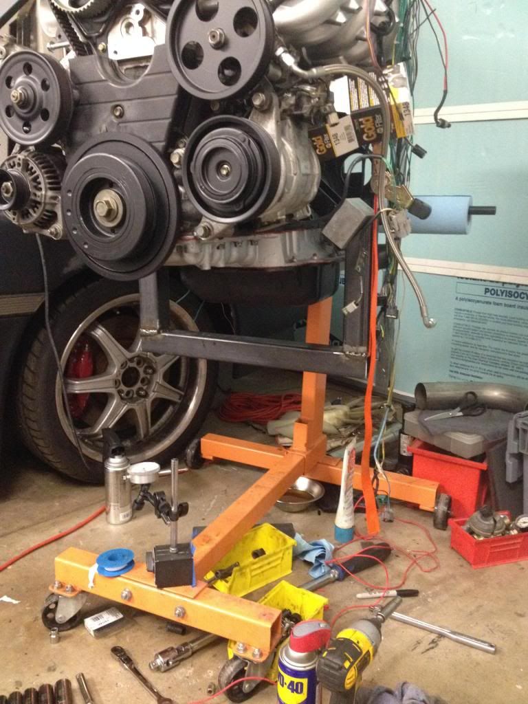

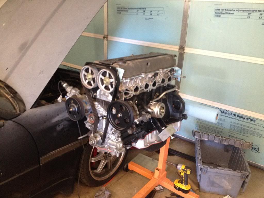

well i was thinking i wanted to get the trans on and be able to wire the motor after the trans was on, so i wanted to make a small motor stand so the motor could sit on the ground. i was sharing the idea with my girlfriend and she said she wanted to sharpen her welding skills more so i told her she could build it for me...and she did lol
my miss', Avanti welding it up.
all done...not the best welds be shes getting better (second time ever welding), we are talking about going to some night class so she can learn more and i can better my skills.
killed that downpipe, will be fabbing my own out of this and albert's old bent downpipe

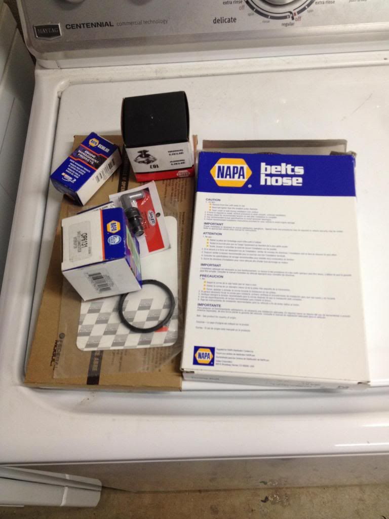

dropped $$$ at napa lol

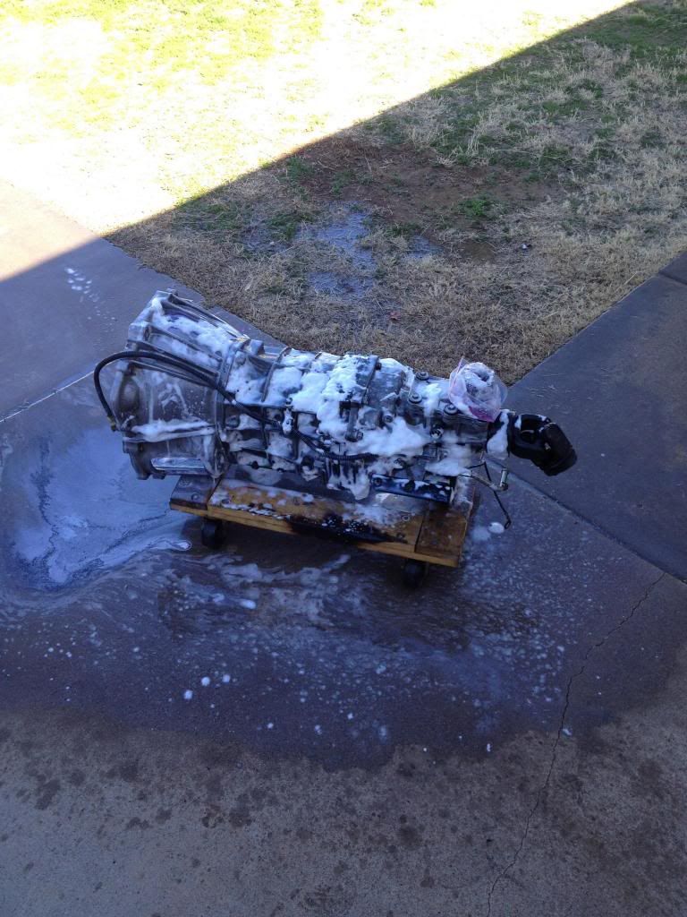

clean trans = happy trans :p

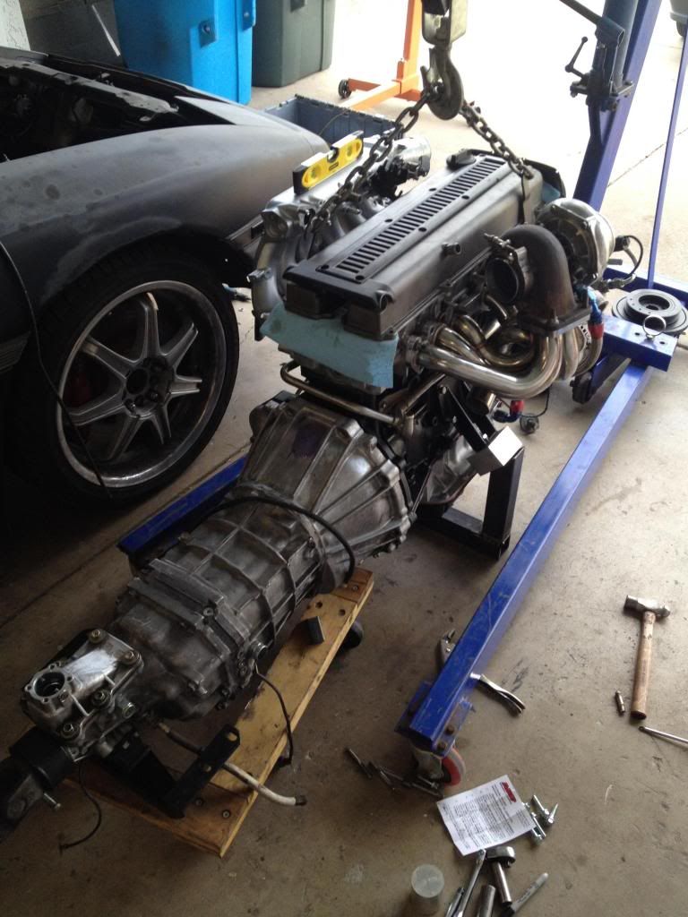

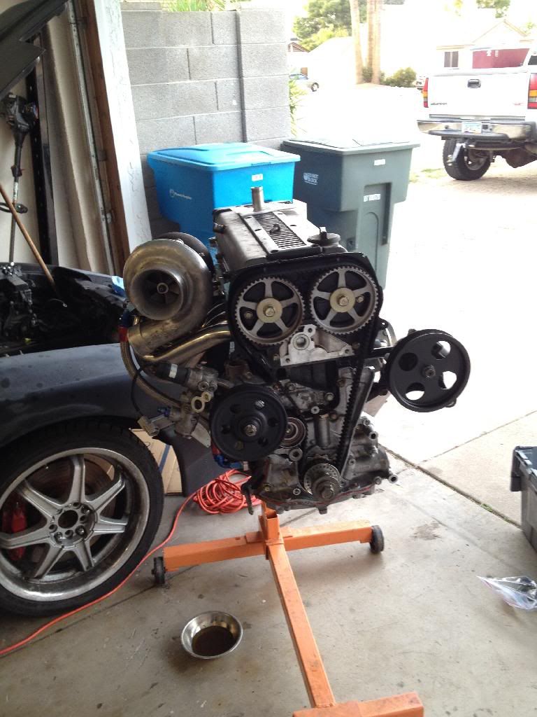

getting ready to take it off the stand

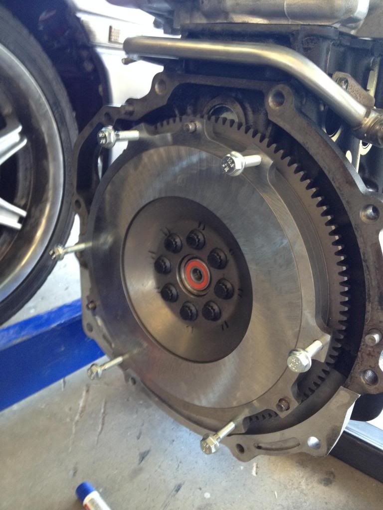

flywheel on, sealed, locktighted, and used arp torque lube under the heads
stabbed the trans like a boss...walked right in no issues...STAND WORKS GREAT!!
sits on stand nice, going to make a trans cradle as well soon...i work on too many JZ motors not to have ones of these

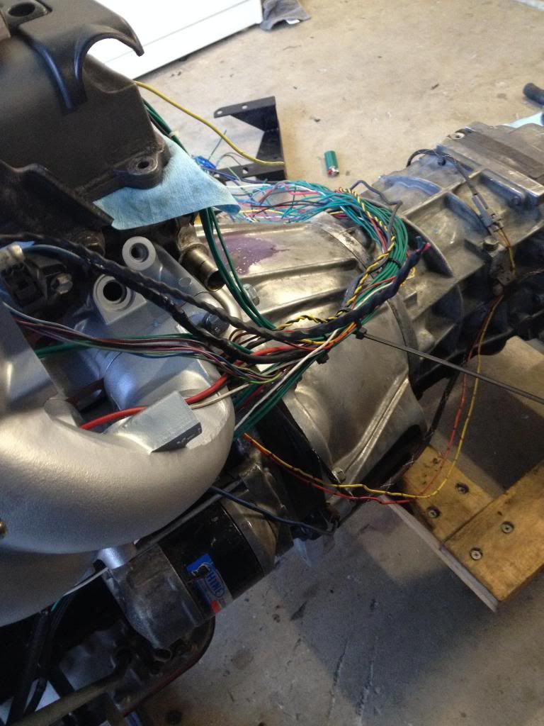

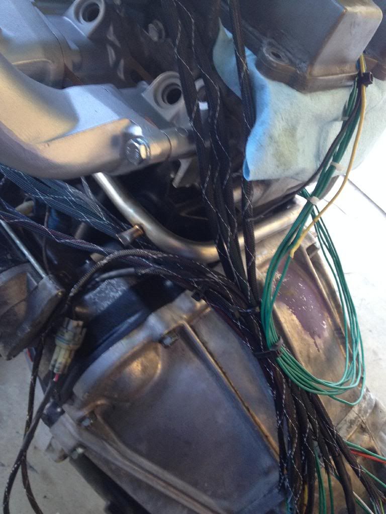

started on wiring

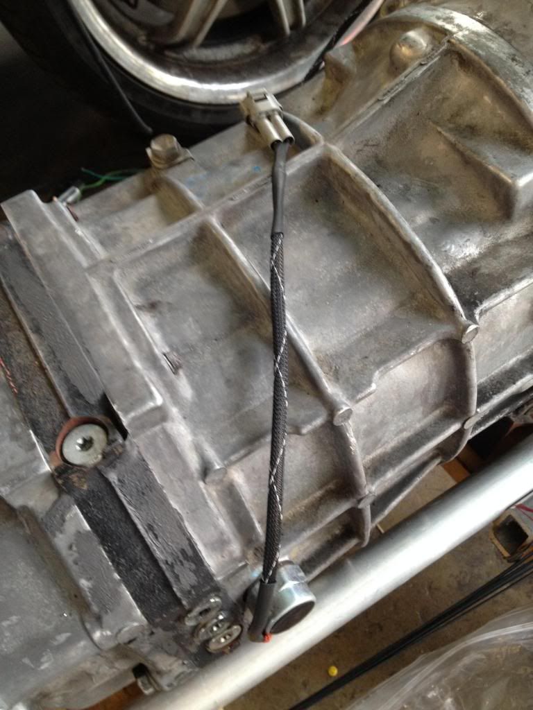

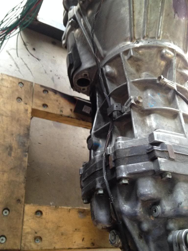

trans wiring

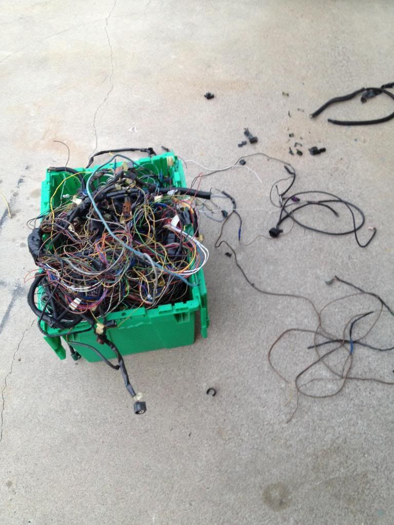

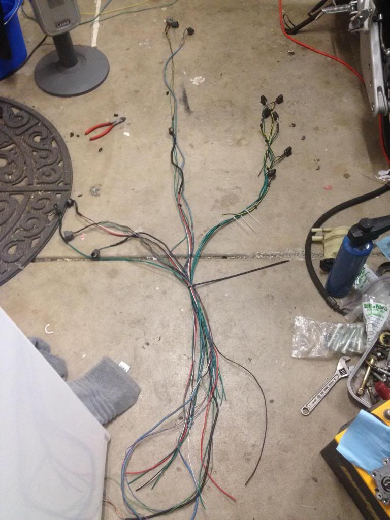

the amount of hack harness Ive collected over the years is out of control...this is 1 of 4 bins lol

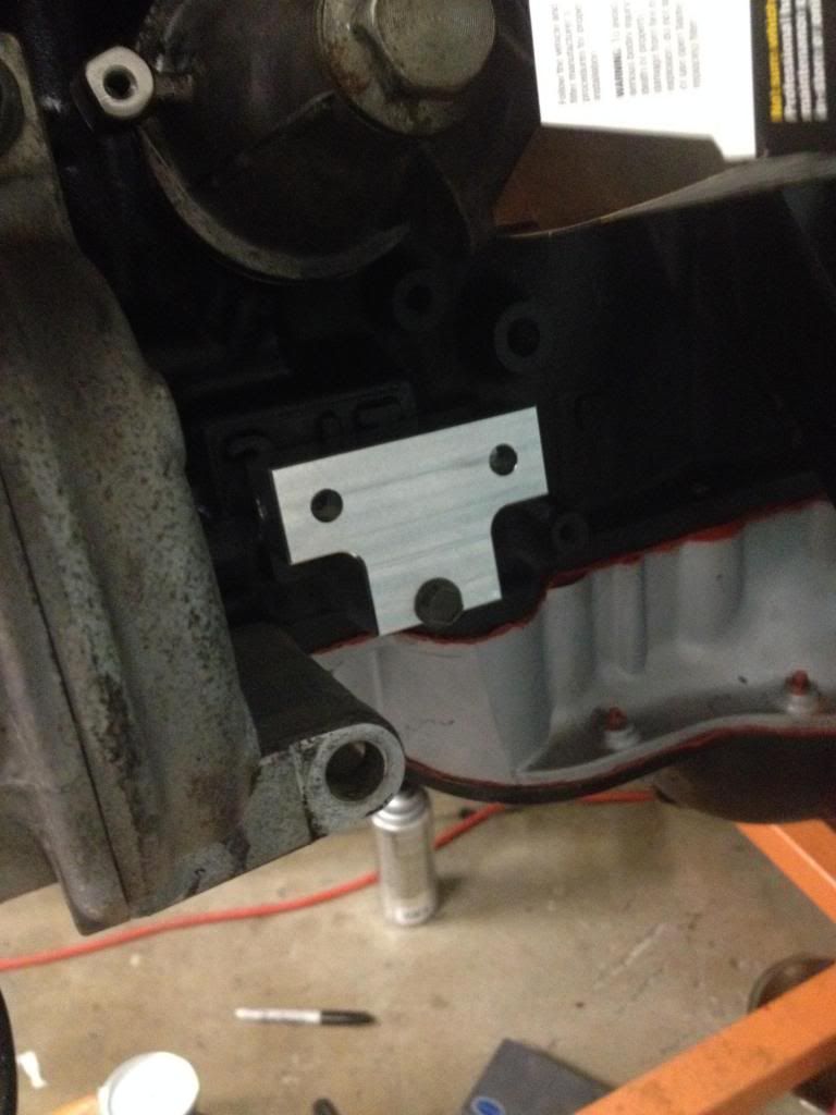

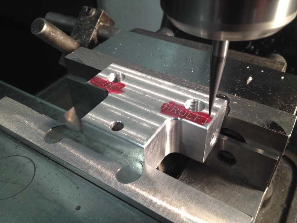

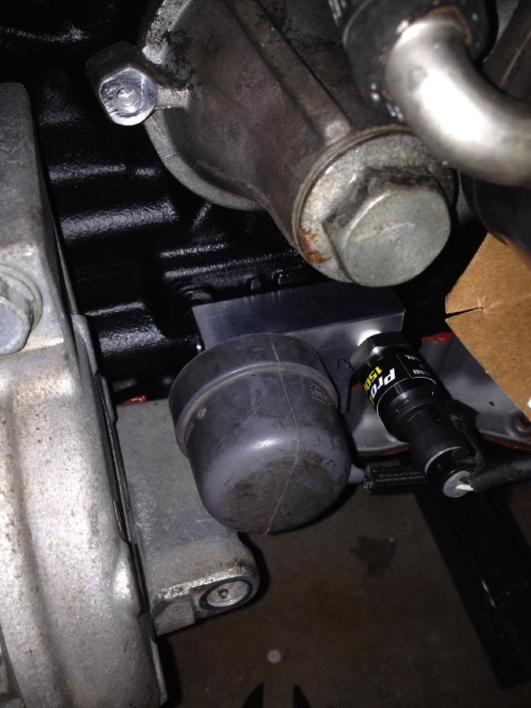

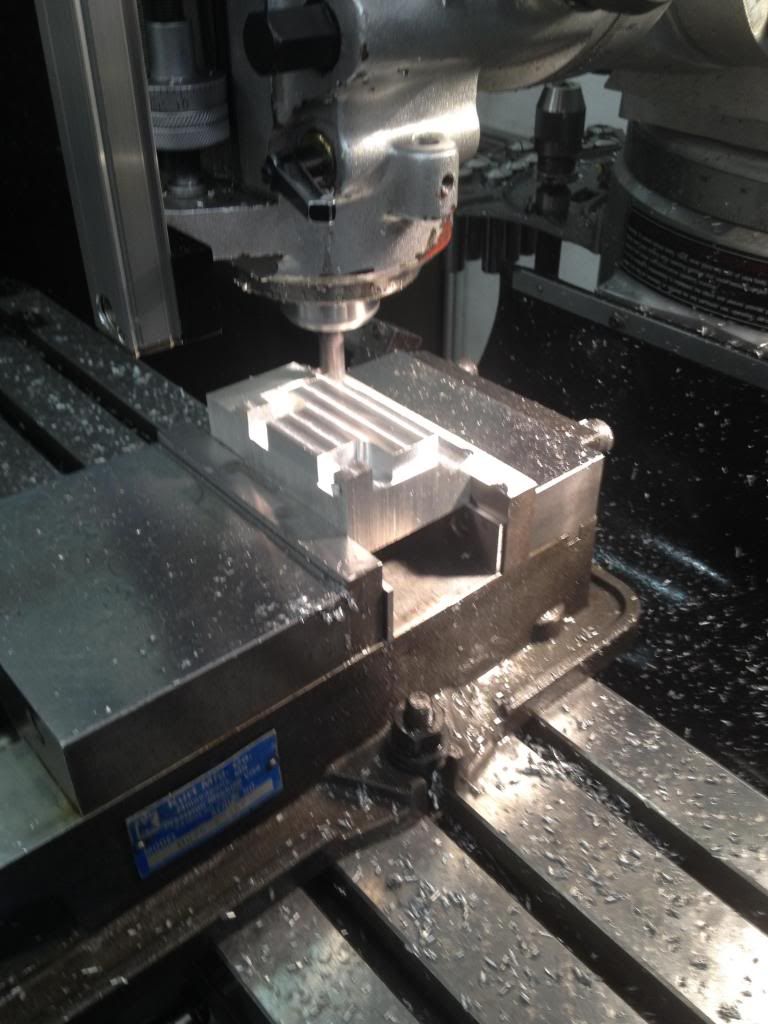

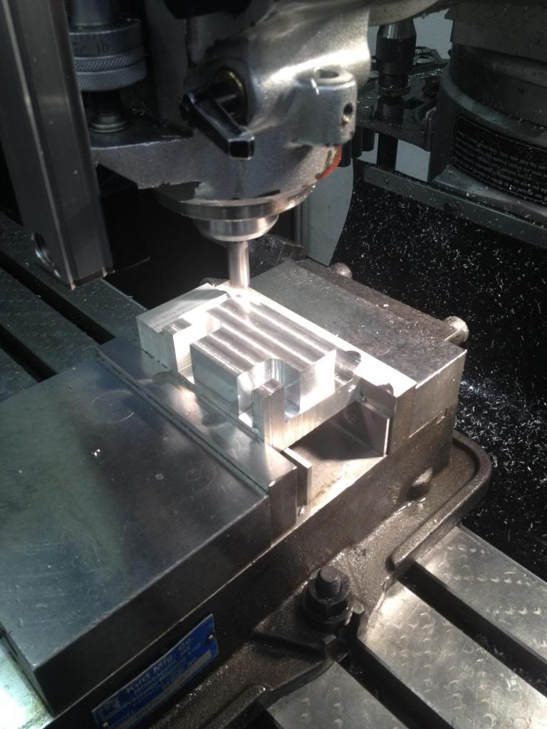

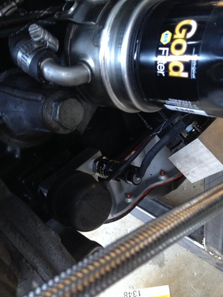

oil block worked out good, just need to run lines now

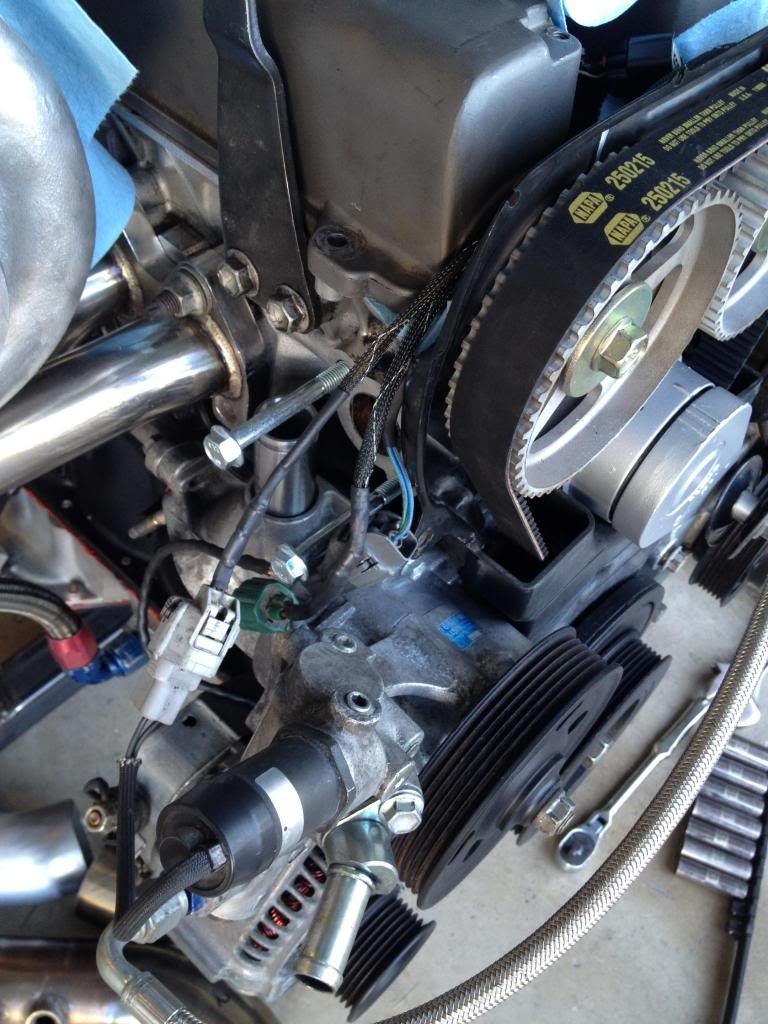

more wiring

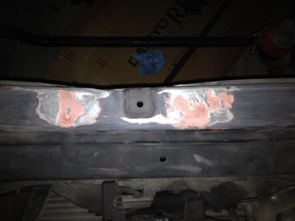

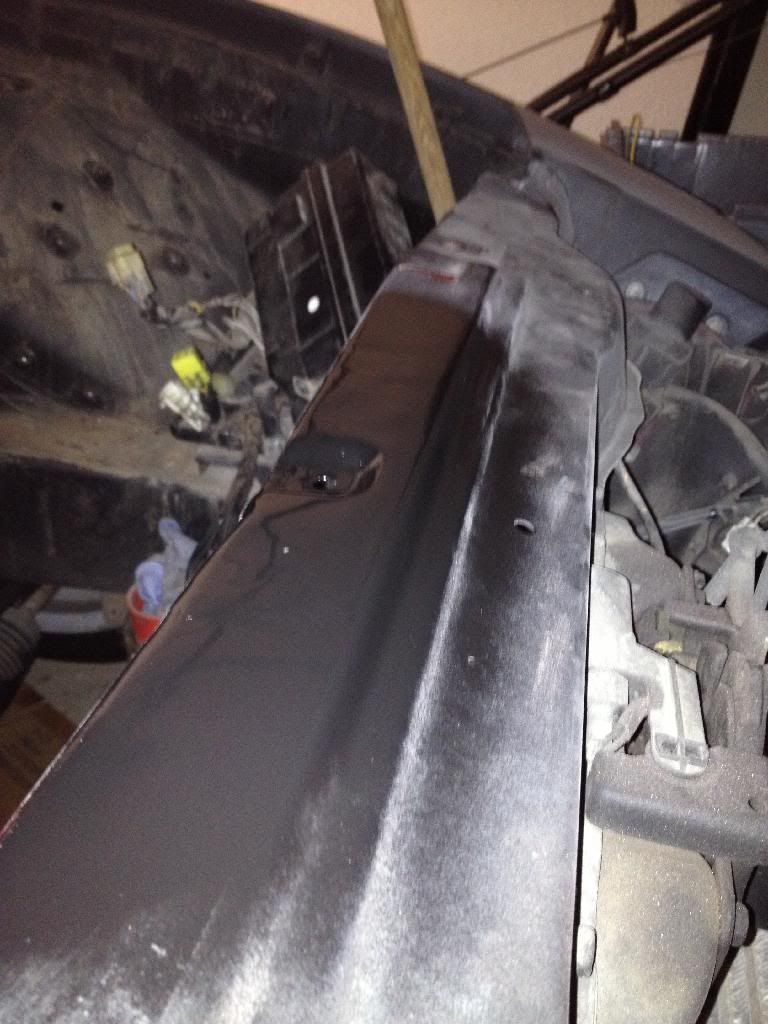

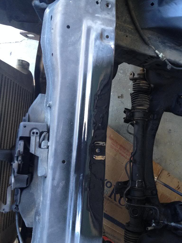

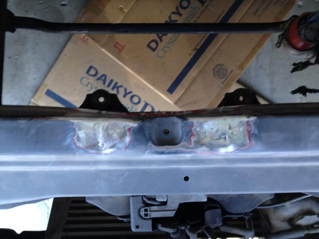

started fixing my core support
before:
after:
just went over with glazing putty and some rattle can for now, will redo this when i paint the engine bay.

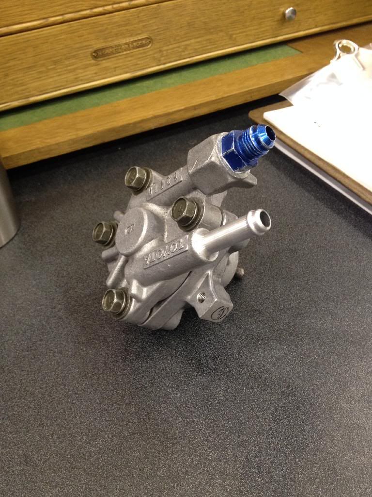

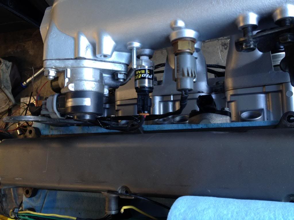

start of fuel rail
