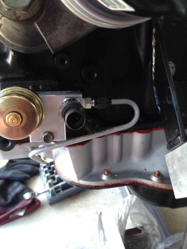

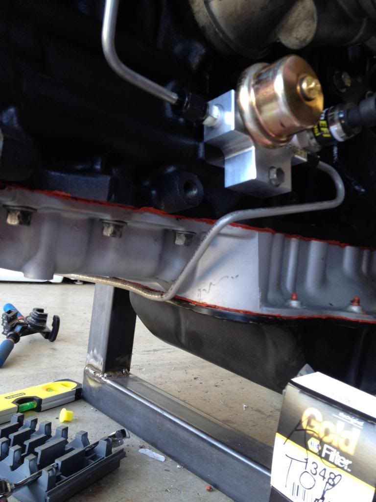

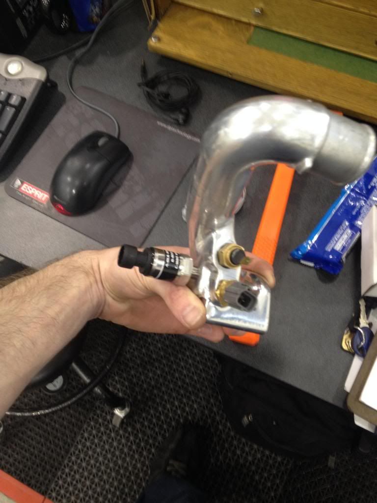

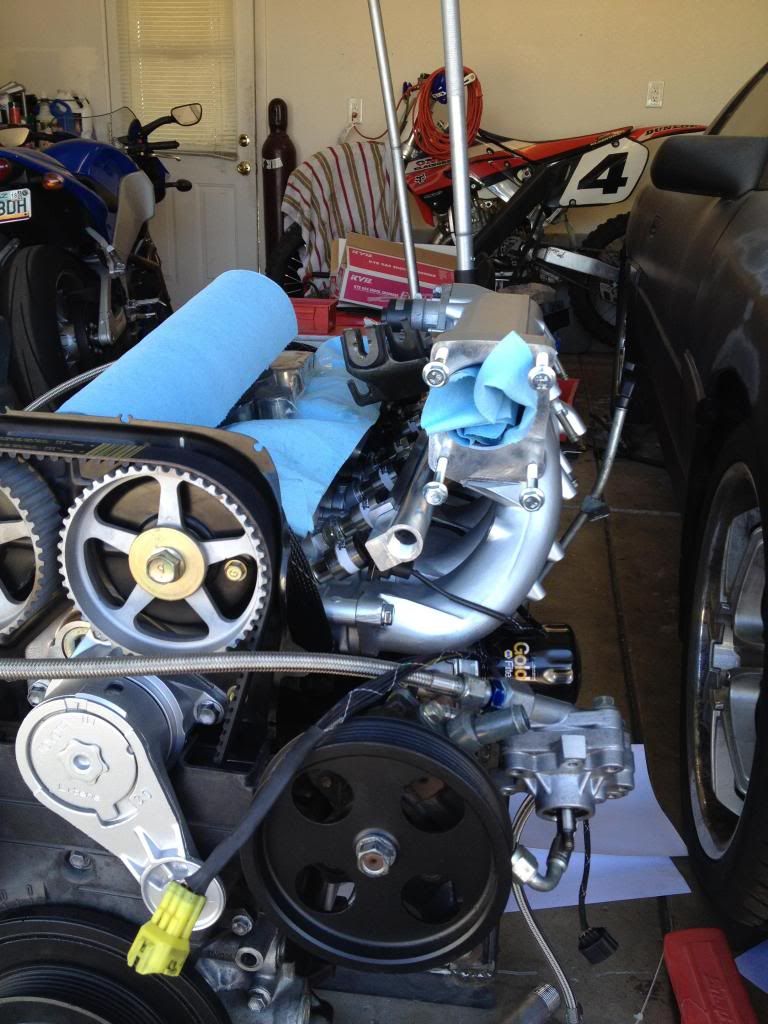

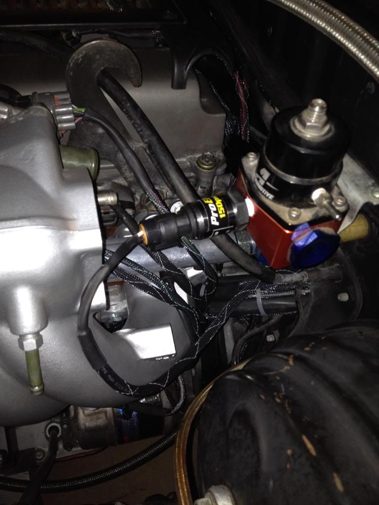

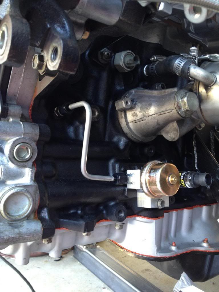

coolant pressure sensor in upper neck
back-pressure sensor

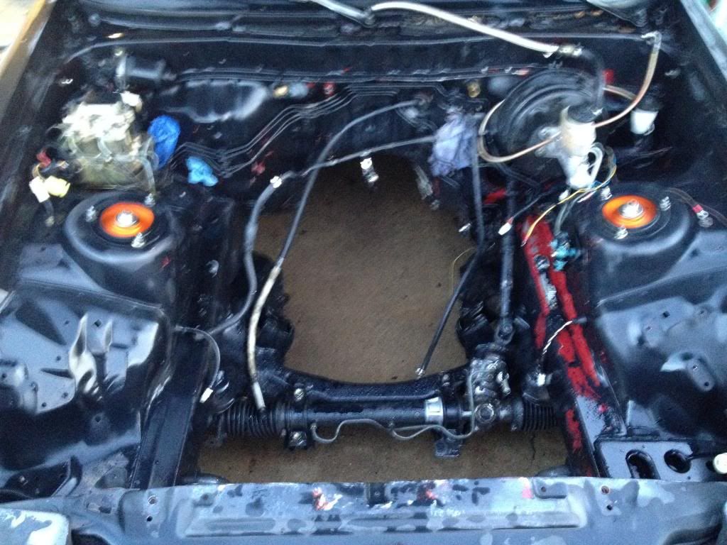

started pressure washing the bay, need to start sanding

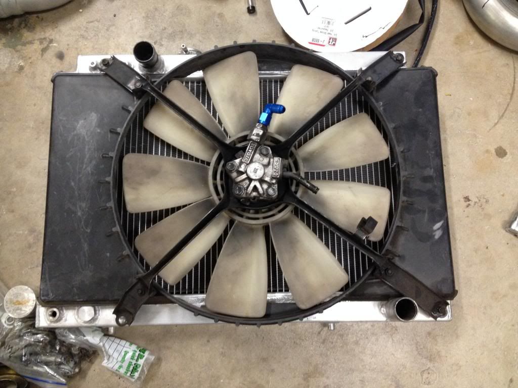

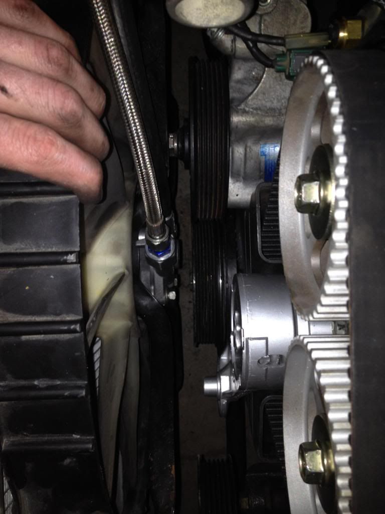

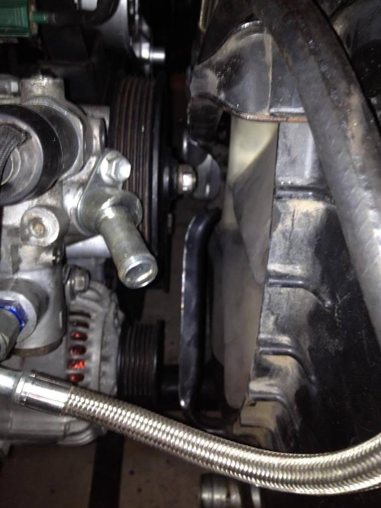

changed to this hydro fan, the return line placement is better on this fan pump

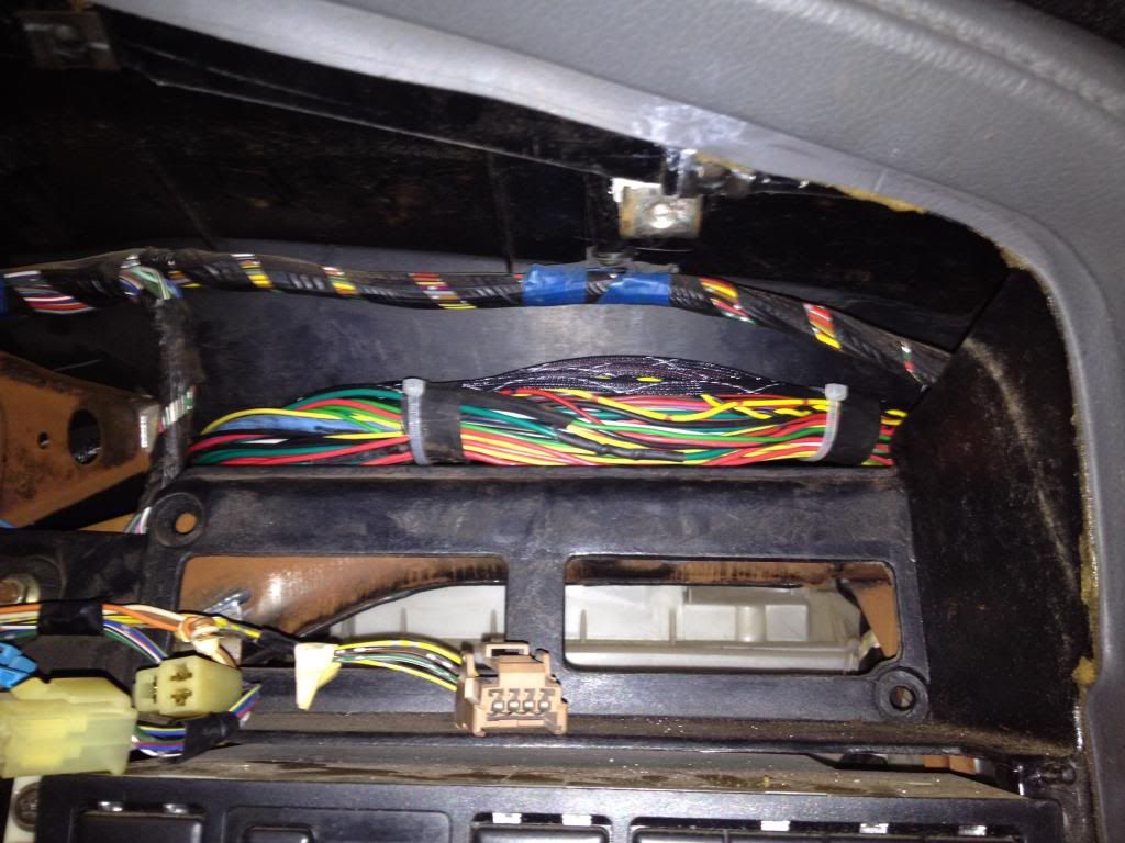

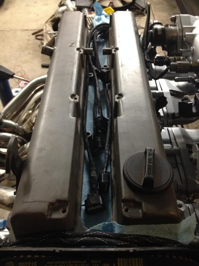

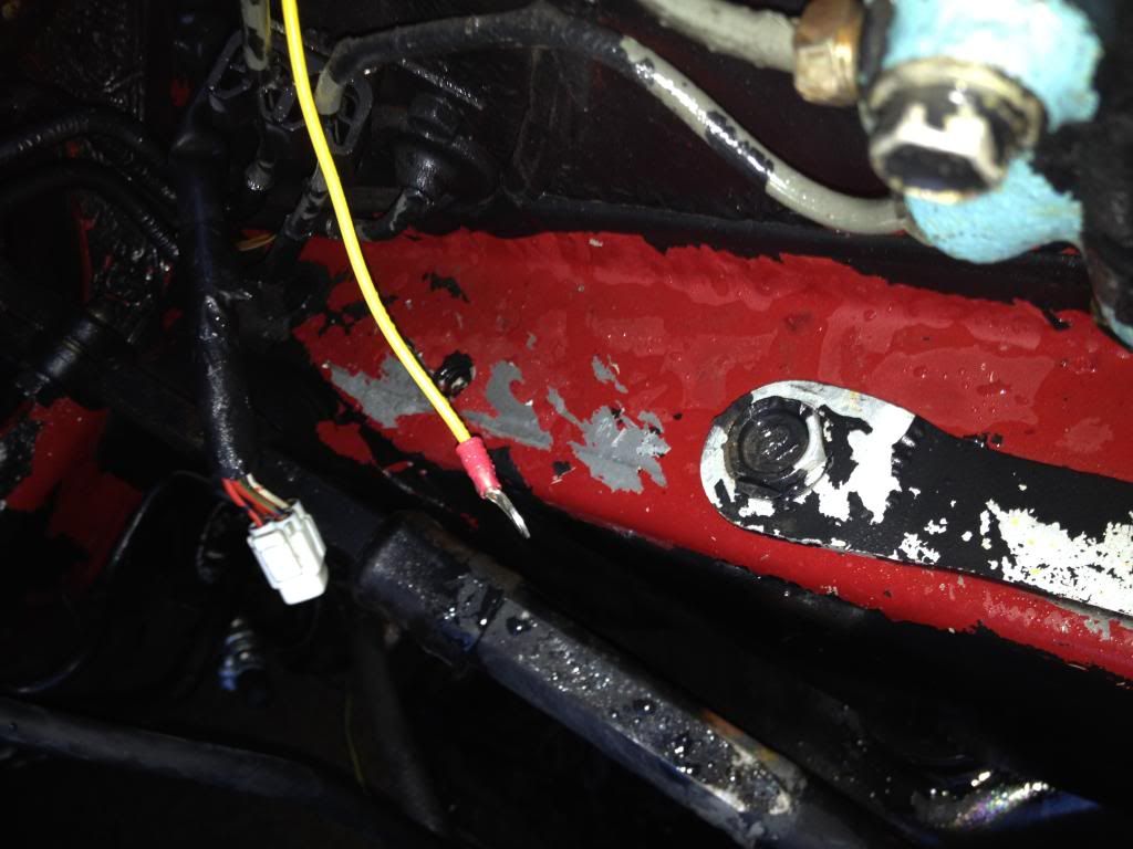

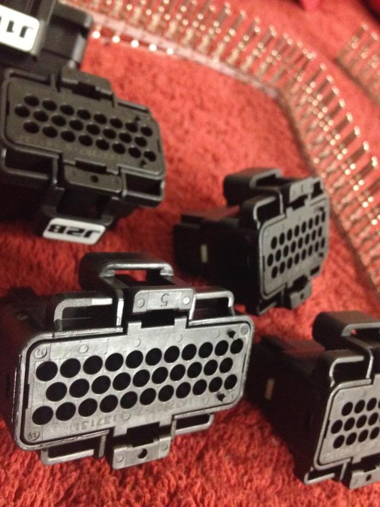

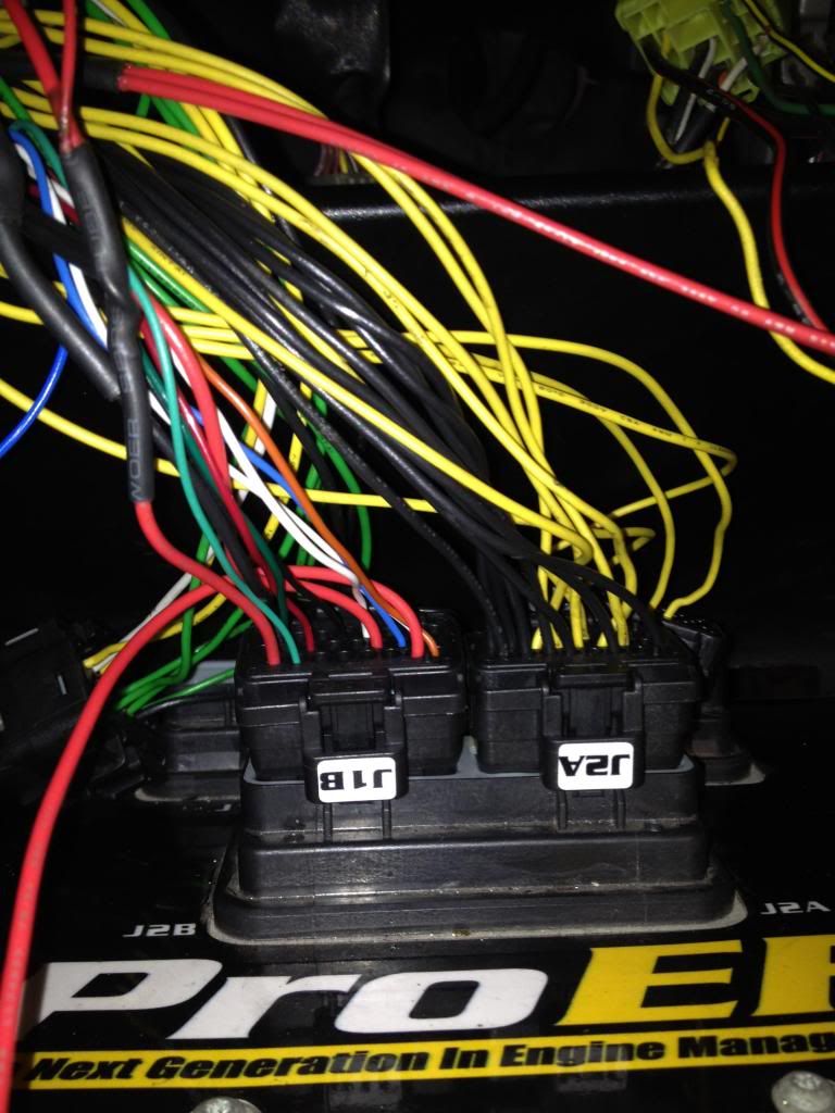

coil wiring

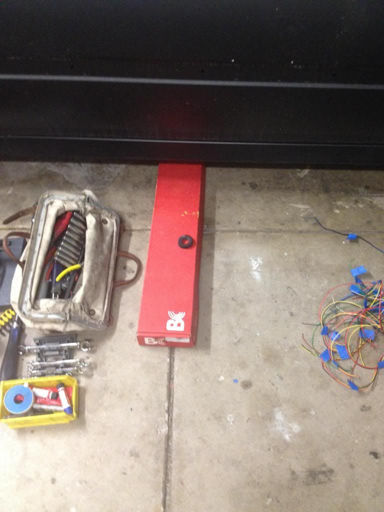

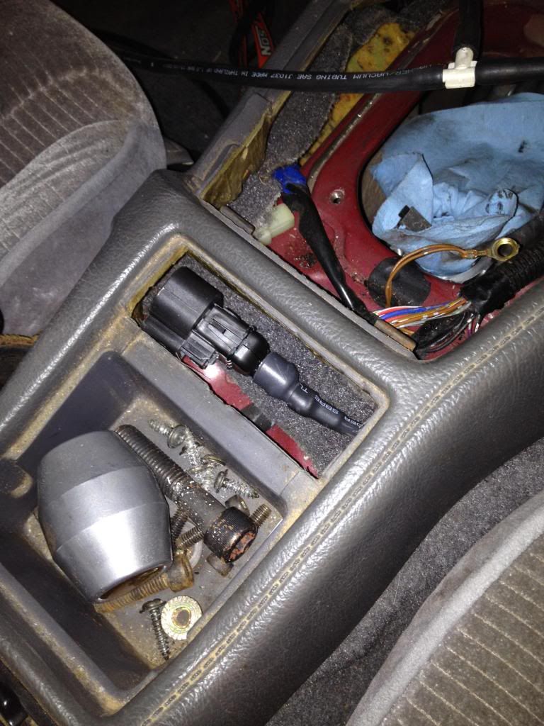

i found this funny looking box under my car...no clue where it came from...:naughty:

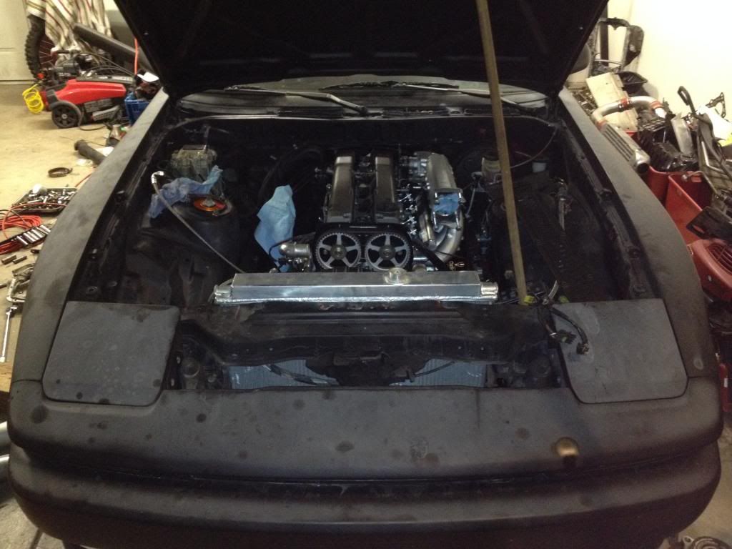

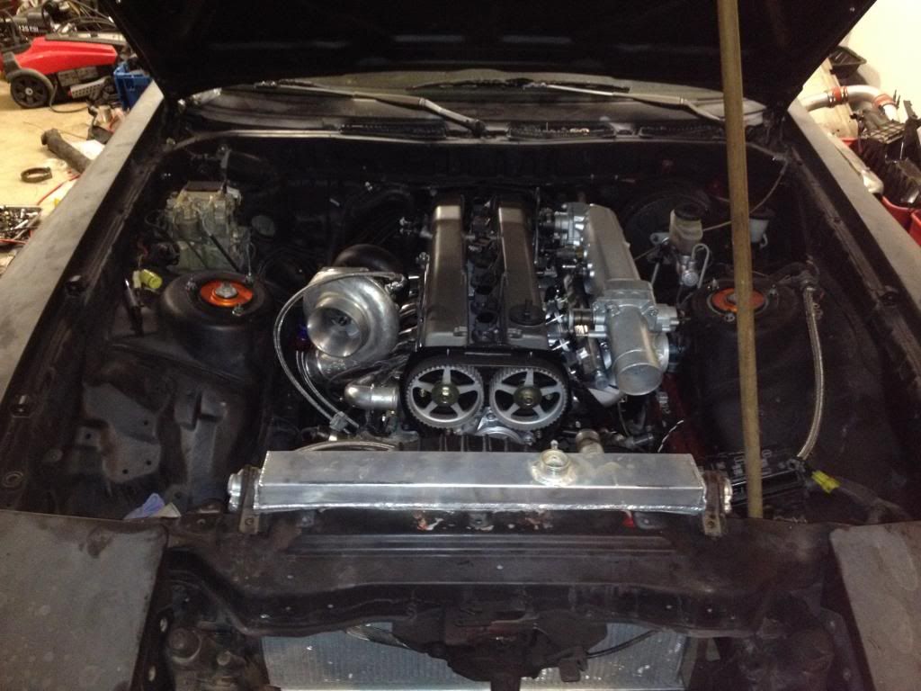

so to make the meet im leaving the car as is, alot of stuff has been hitting my back pocket kind of hard the last few weeks so paint is low on my list of things to buy. as of right now my focus is to get the car up and going to get it to the meet then pull the motor back out the first week of march to prep for paint. im kind of glad things have gone this route though because it will allow me to get everything exactly how i want it and if i need to add any wiring i may have forgot or random bits i can do that in march when the motor is out for paint. the motor is more or less ready to drop in (minus the cams but that can be done in car) just been holding off because i wanted to finish my DP and manifold but that should be done tonight so i will most likely drop her in tomorrow night...then the fun of pinning in the 128 will begin...hopefully i can get that all done before Friday that way i can drive it down Saturday morning to the meet...i know its a long shot but its been done before.
128 plugs

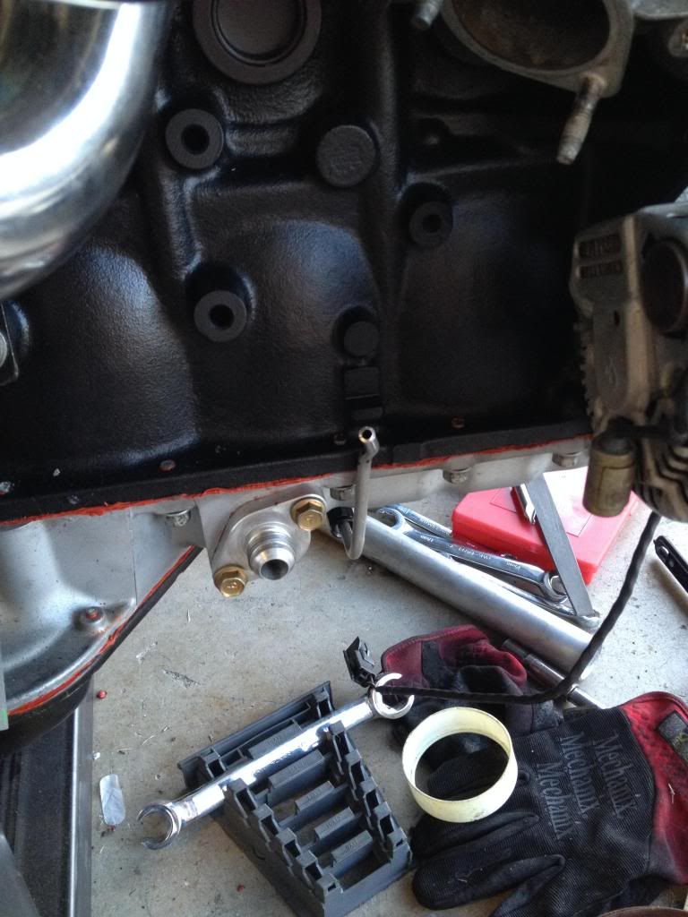

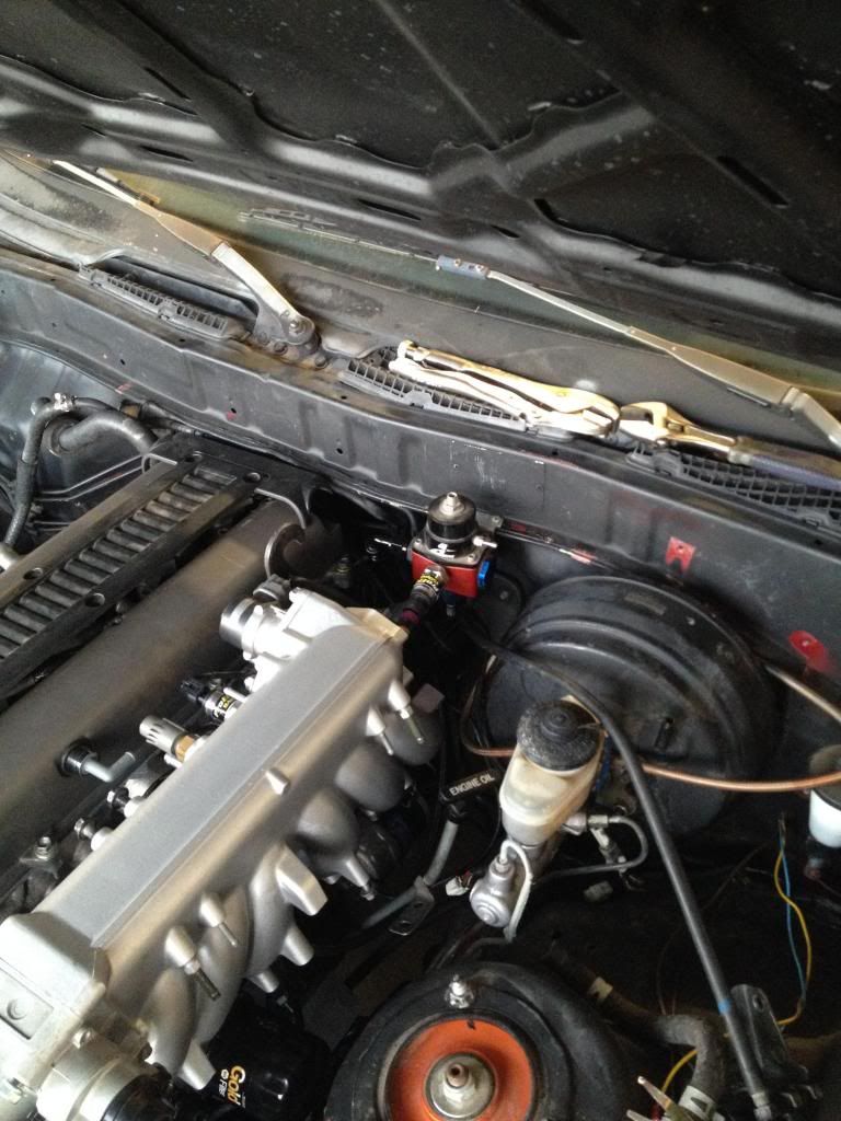

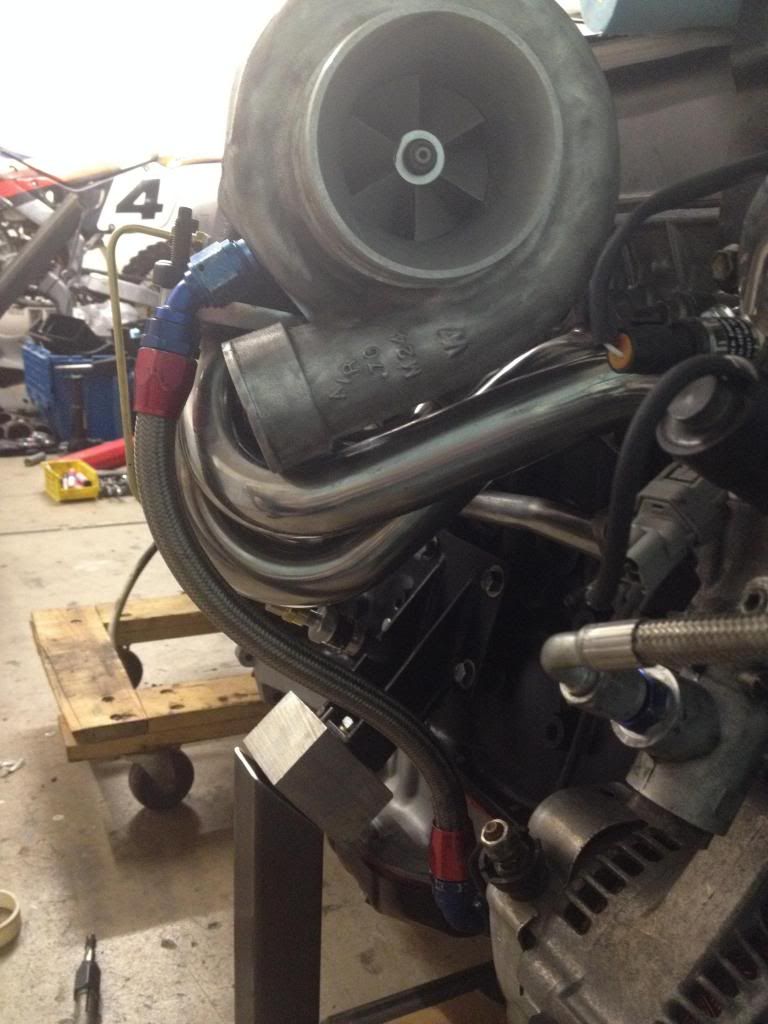

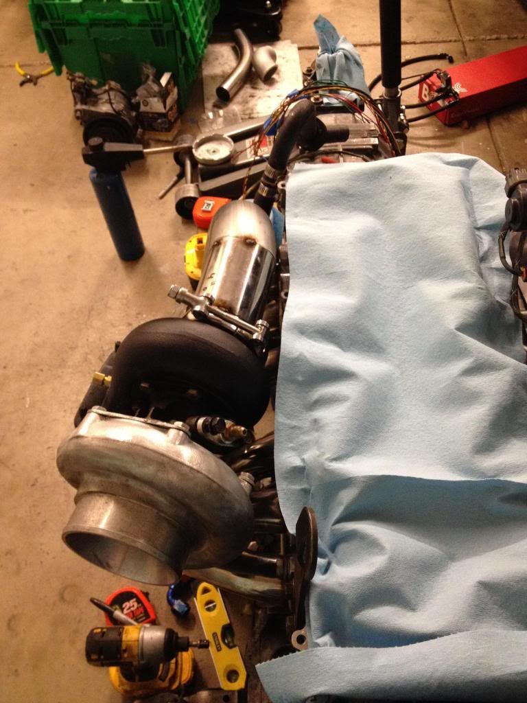

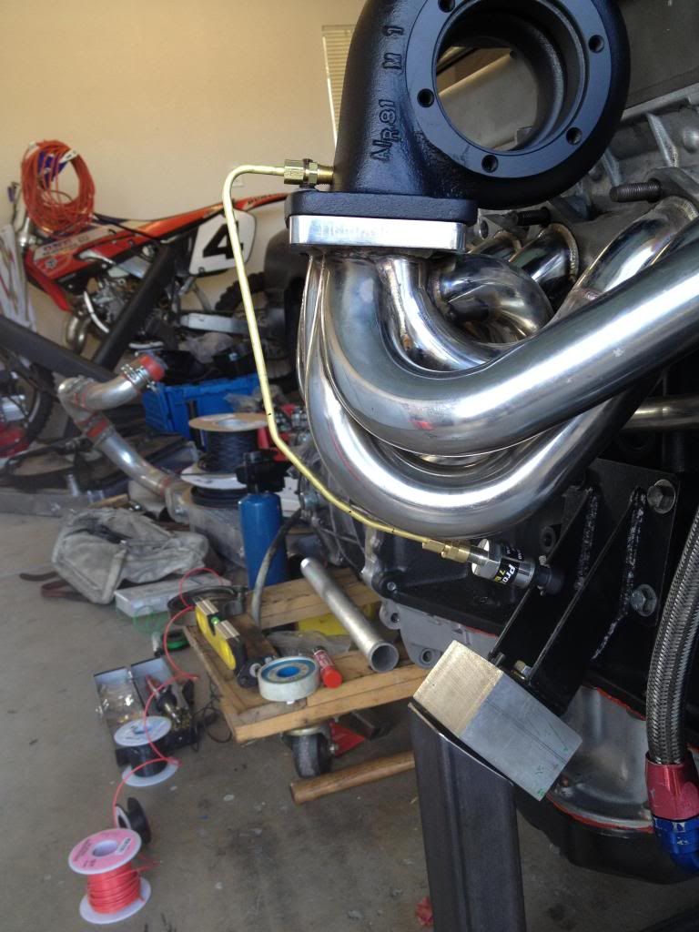

turbo oil feed, just need to go to parker to get my softline
was going to run all hardline but i felt it wasn't the best way to do it with what i had, would have been too close to manifold

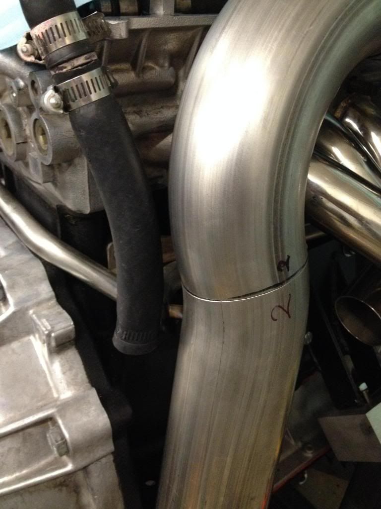

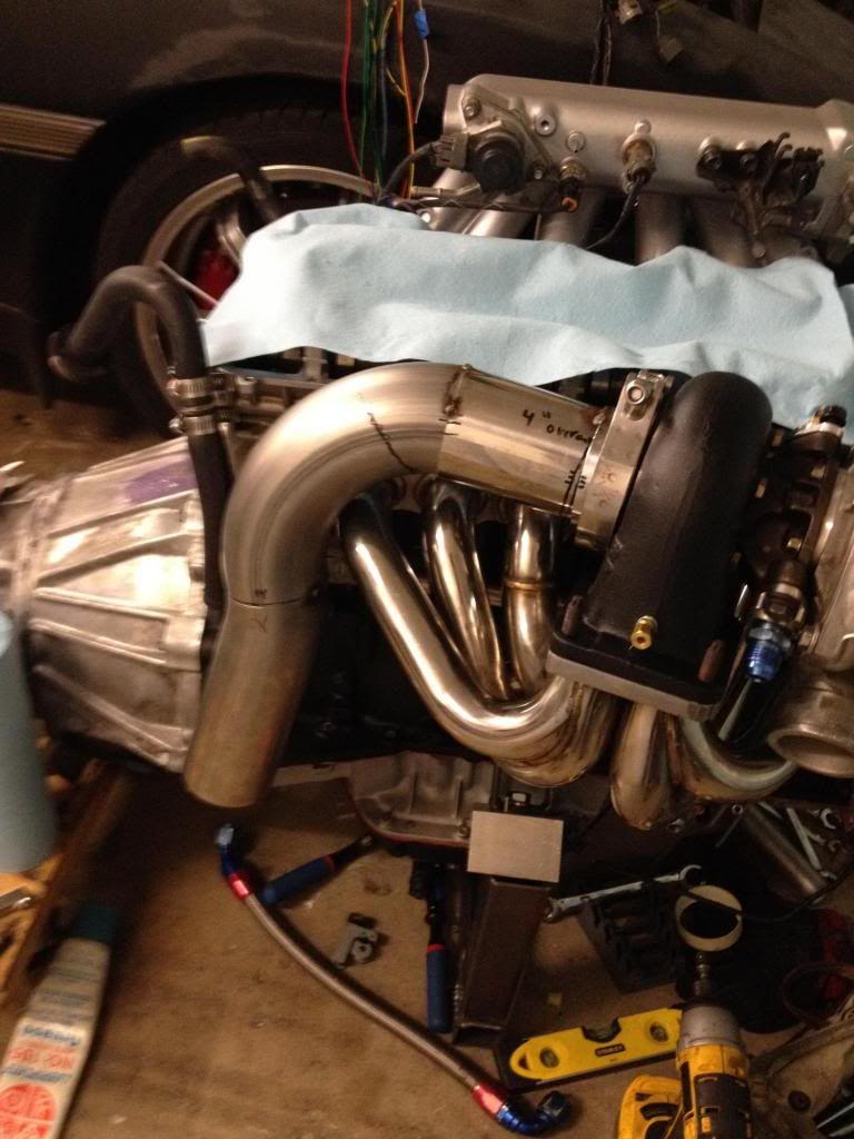

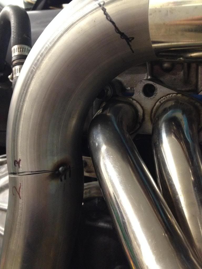

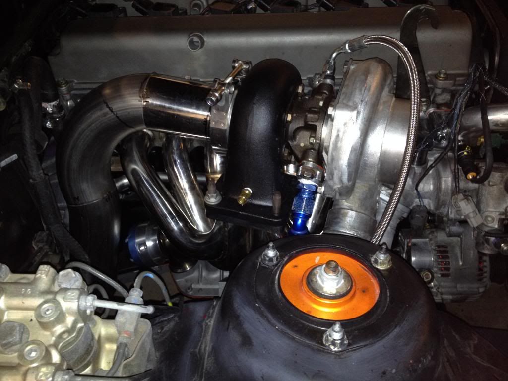

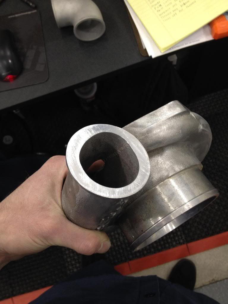

downpipe taking shape

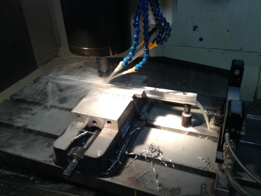

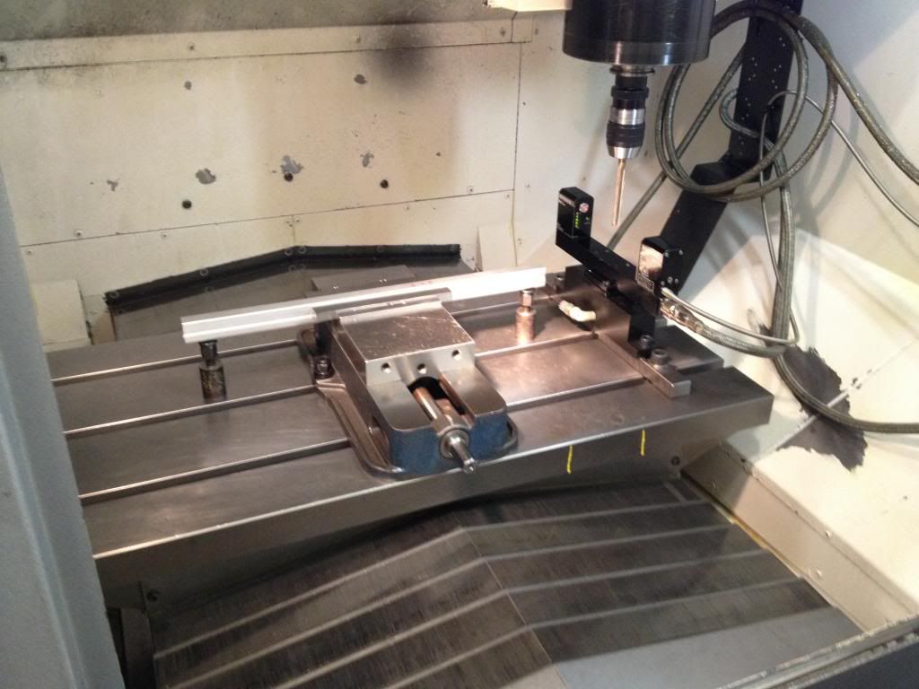

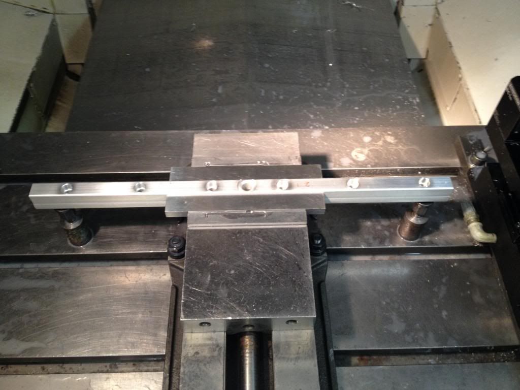

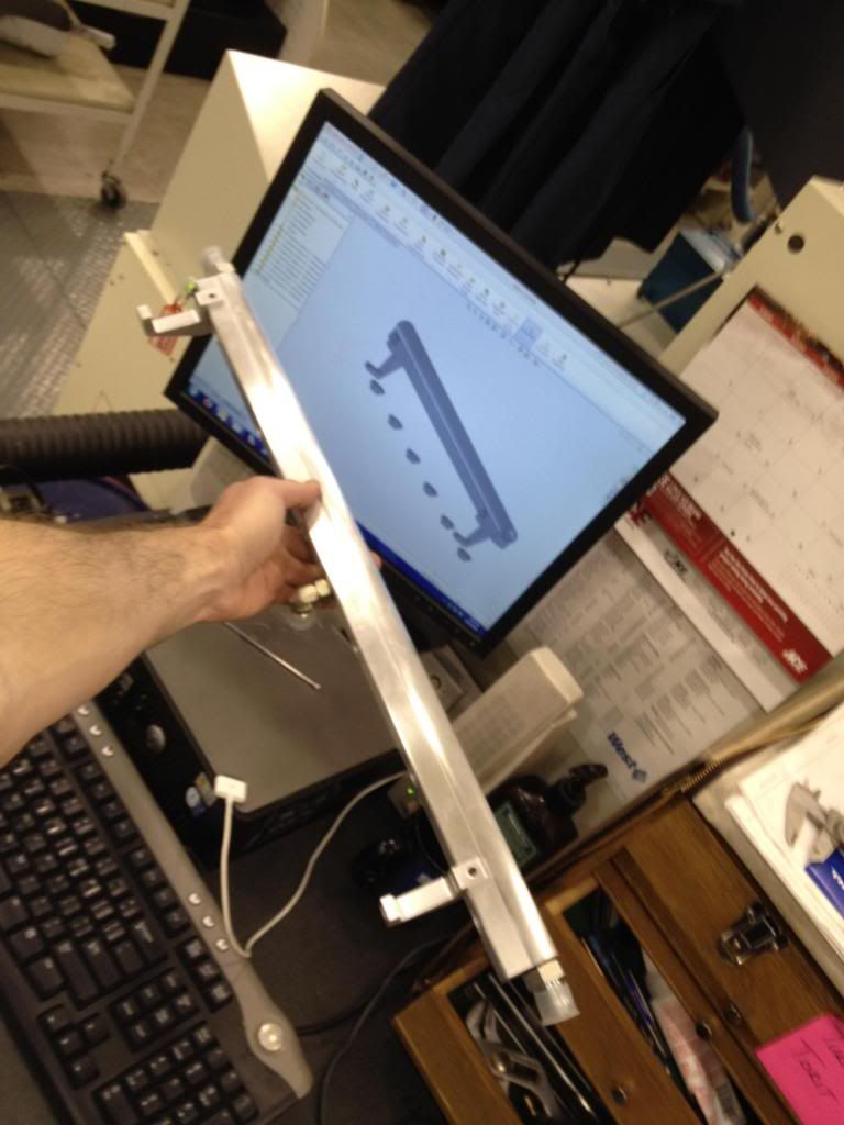

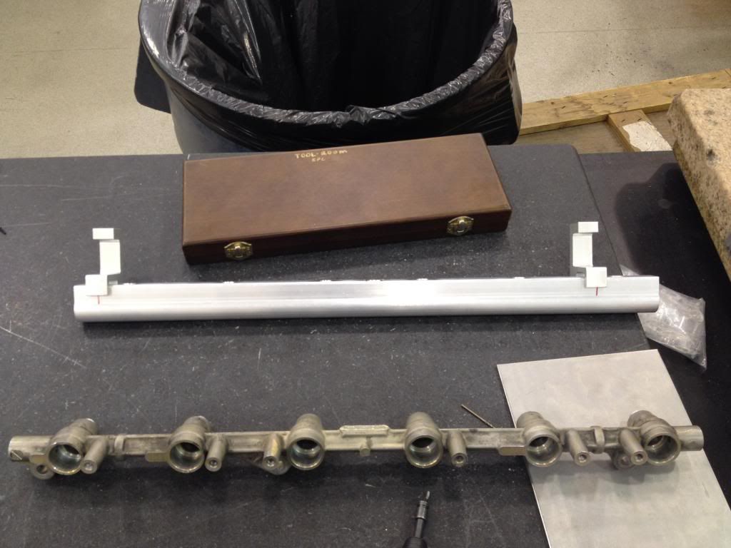

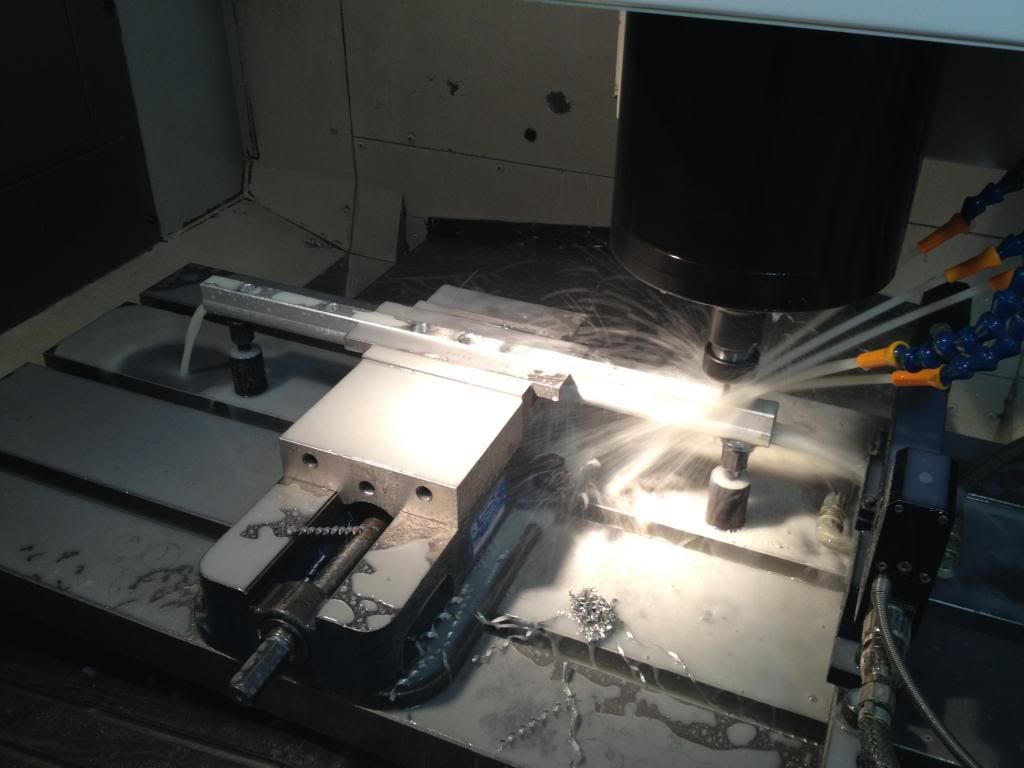

UPDATE TIME!!!! some good pictures for you want a be machinist out there

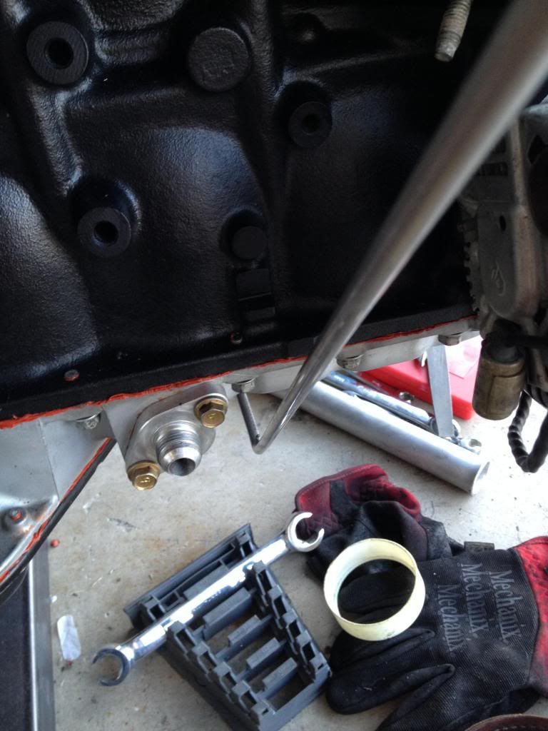

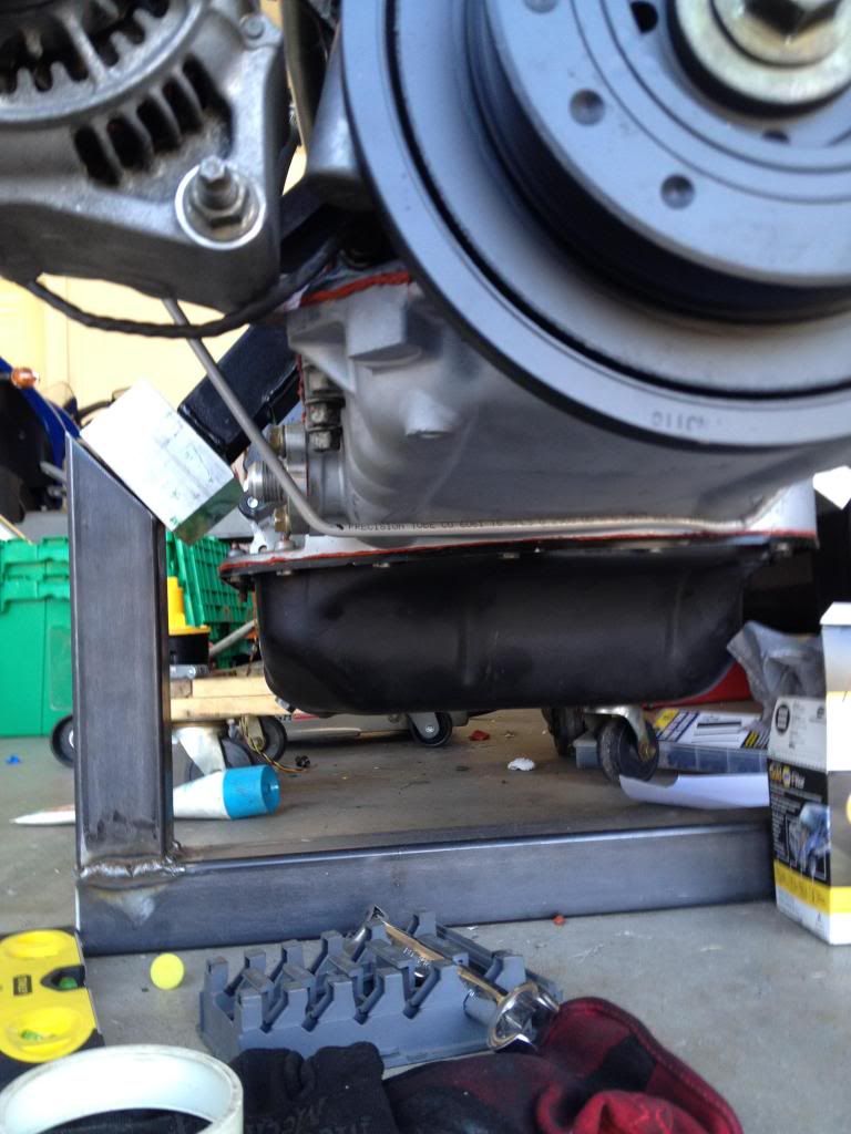

oil feed for the turbo is done

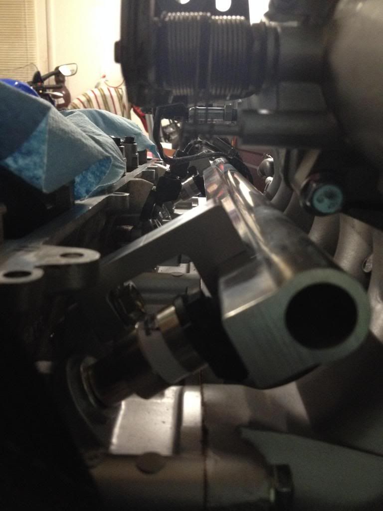

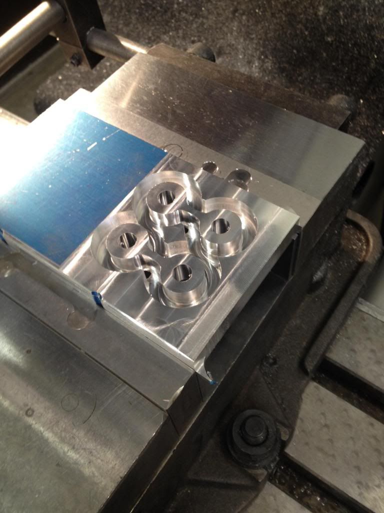

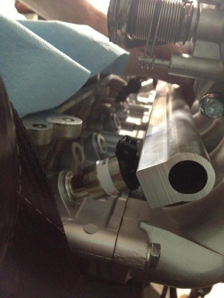

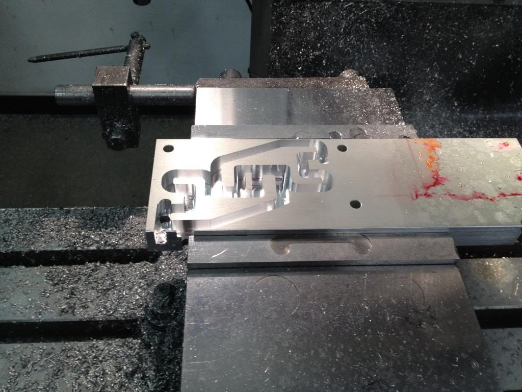

injector boss' made

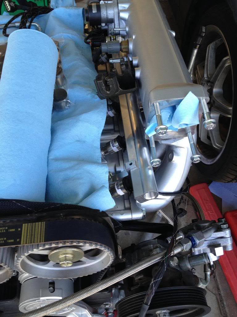

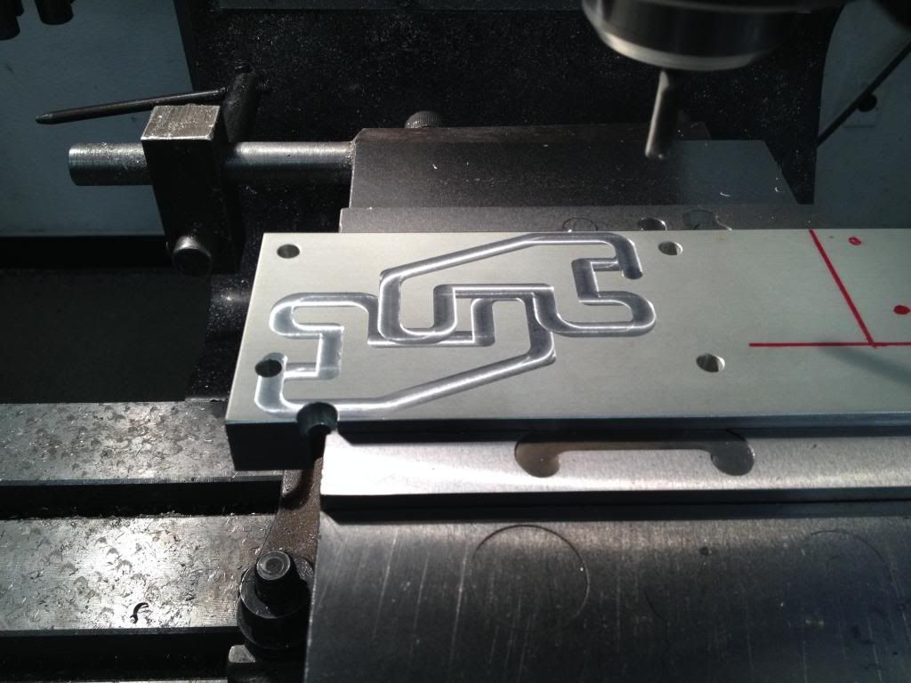

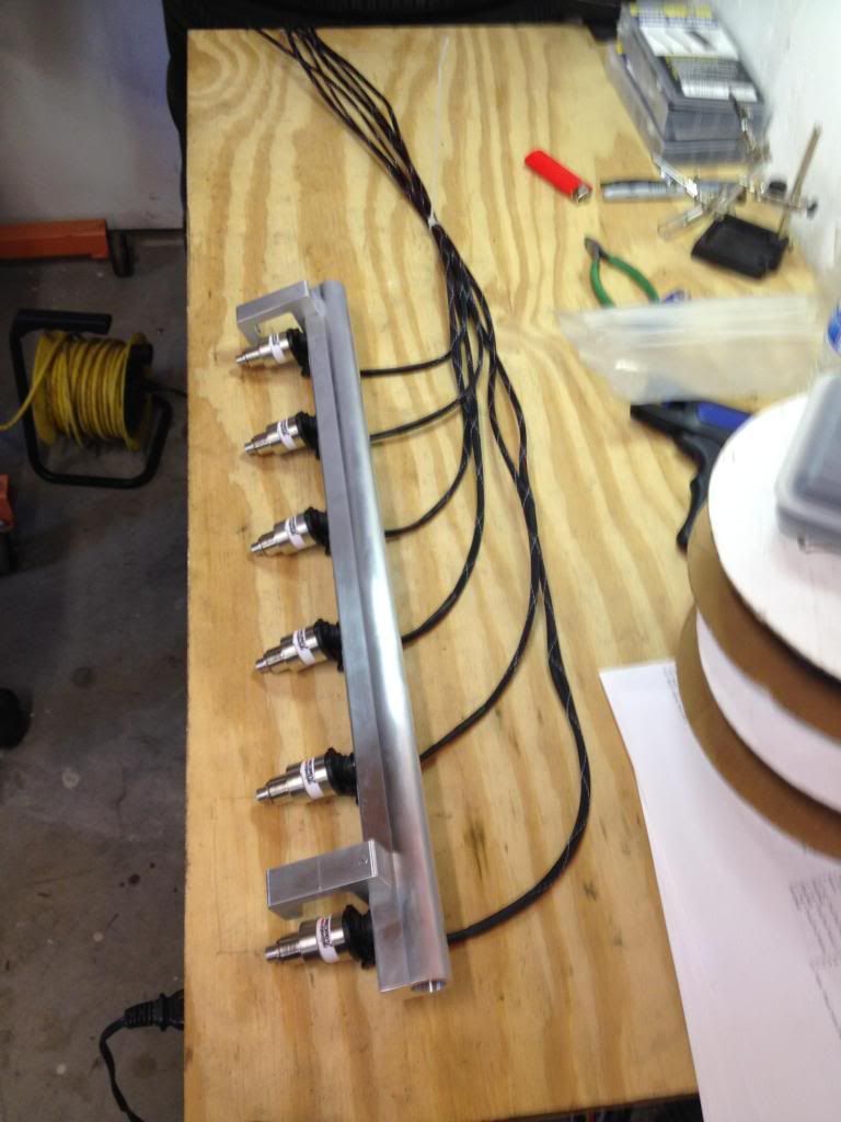

machine setup to run fuel rail
running
done
fitment test before standoff's

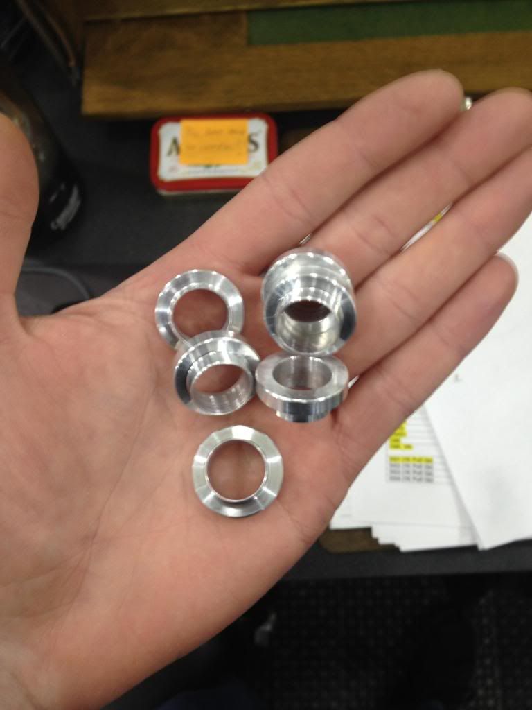

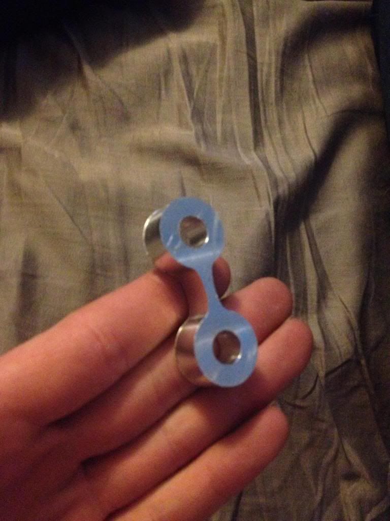

standoff's made
like a glove...only problem is I put the support face on the wrong side so i will be remaking the standoff's witch is no biggie

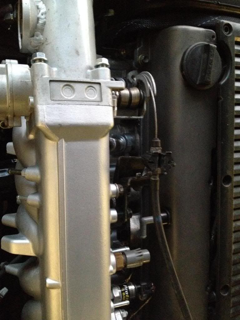

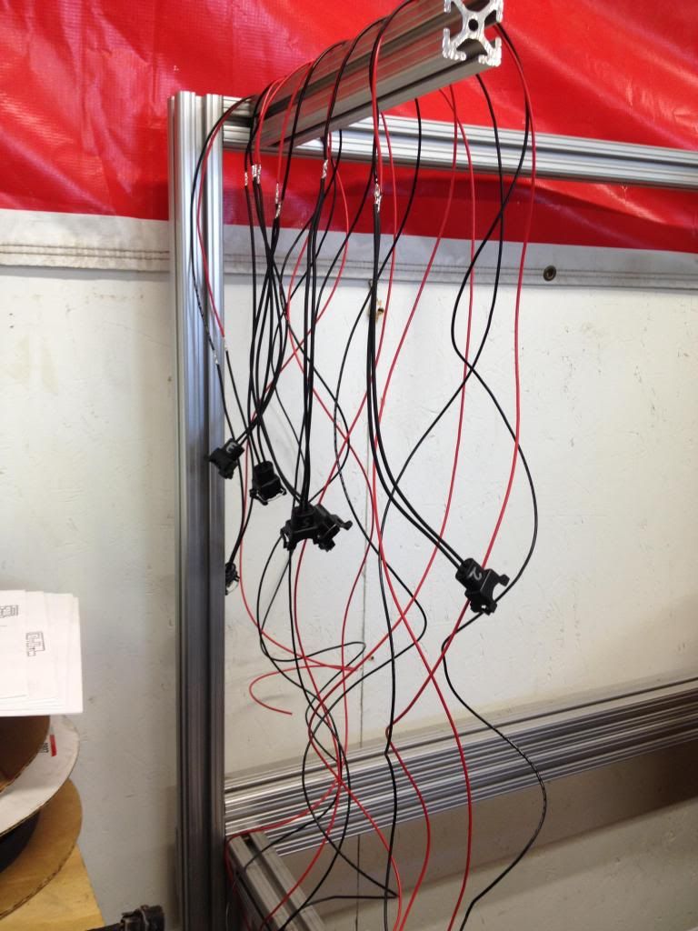

injector clips

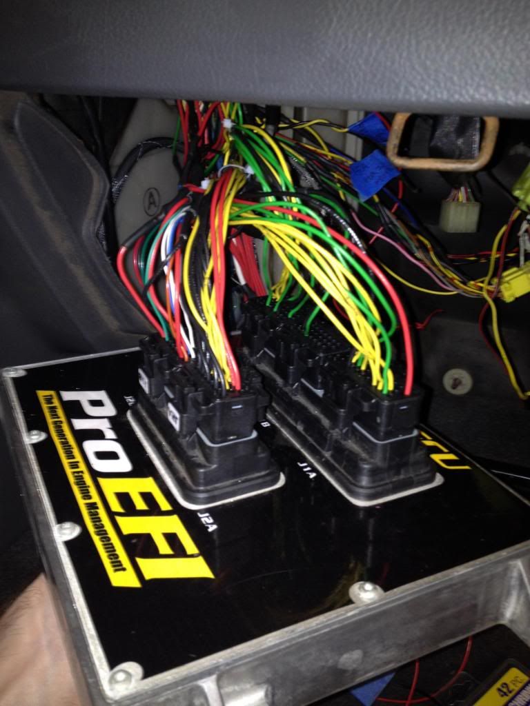

wired

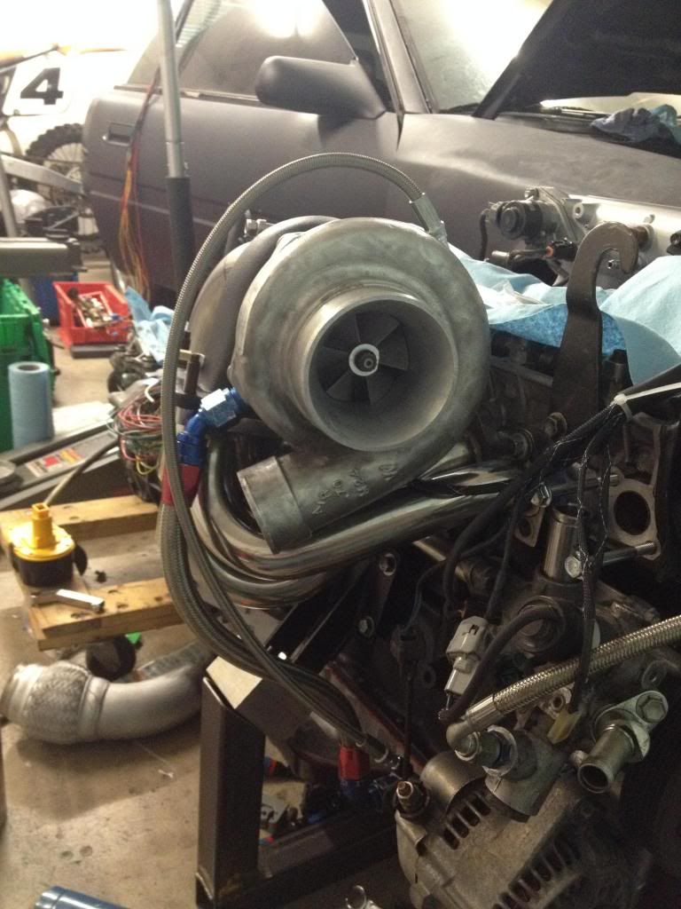

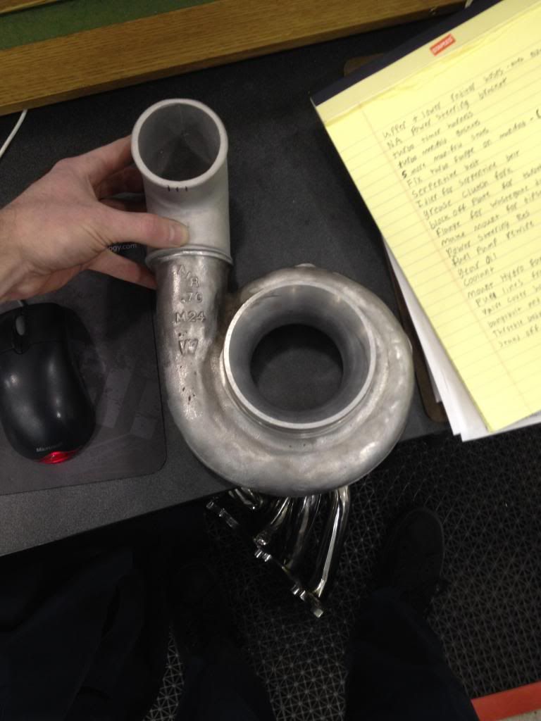

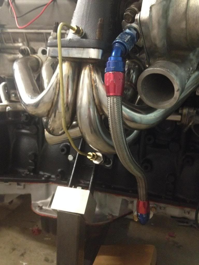

Stupid question perhaps.. but your turbo oil input line is not clocked correctly is it? (not in car, so I am assuming not final clocking... I would think should be at 12:00)
yea that was just mock up mostly, manifold will be getting a spacer welded onto it. reason i am welding the spacer on is because the manifold has two out of the four holes drilled out on the t4 flange. it will resolve that issue as well as bump the turbo up a bit for better clocking for oil lines and intercooler piping routing.

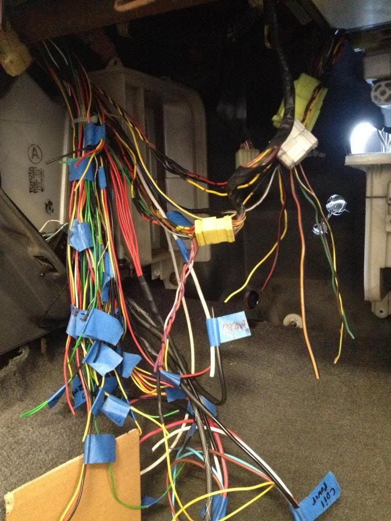

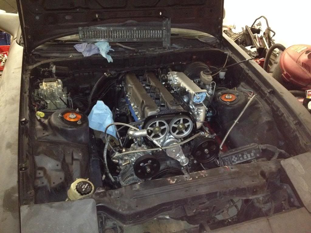

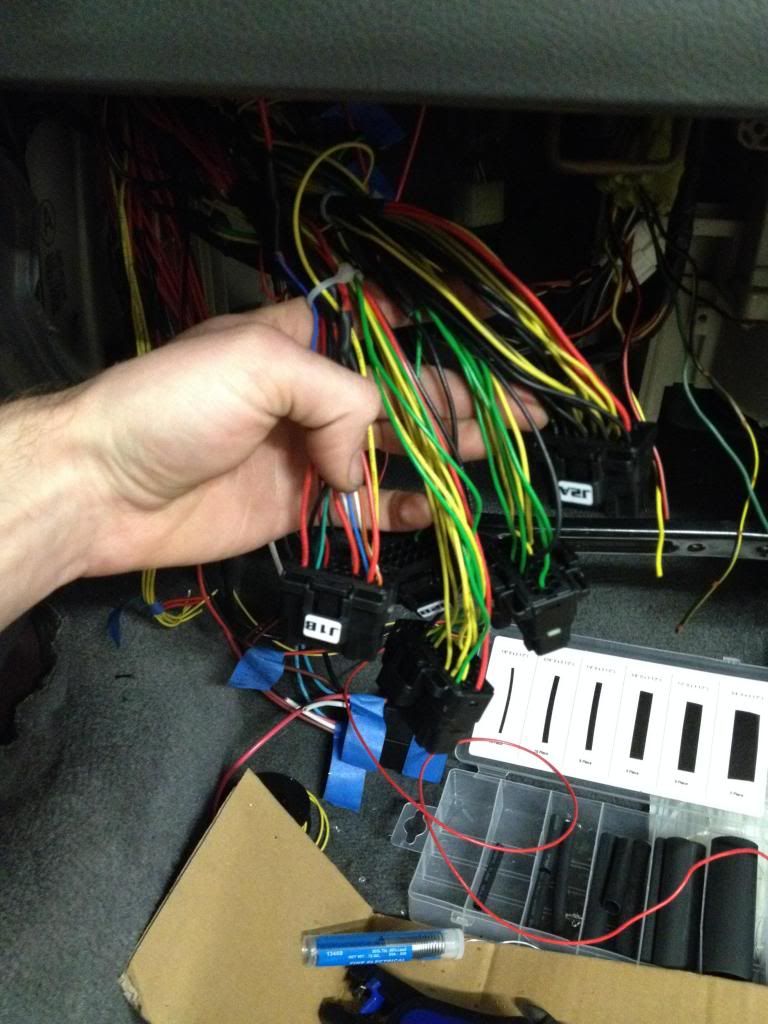

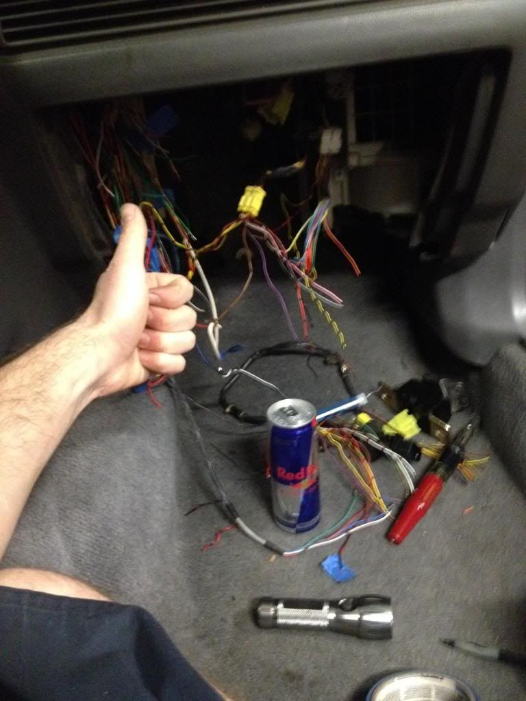

just about ready to turn the key, still have some stuff to run before i start it thought. my fuel pump relay will be wired tonight, need to run some fuel lines, rewire my starter, and run lines for my boost controller...some other random bs im forgetting but its getting close.

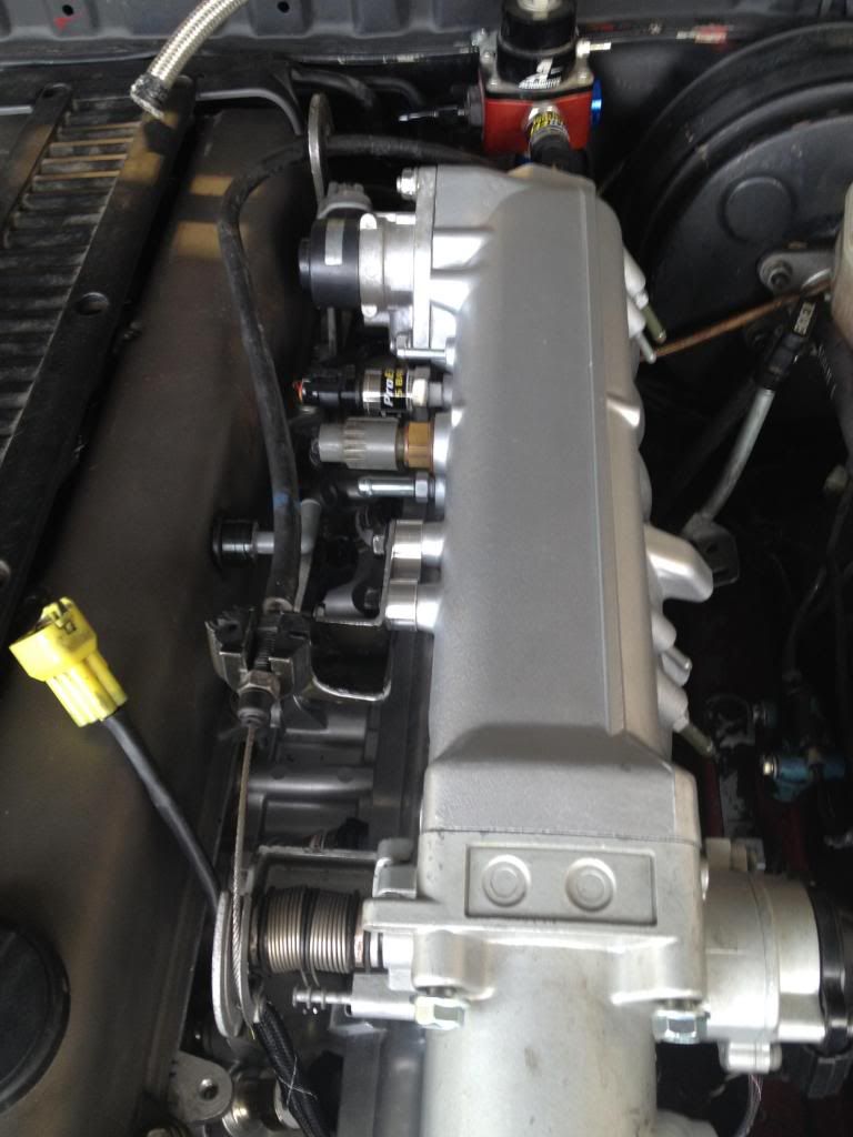

made my throttle cable mount spacer, best way to run 1j throttle cables that ive found over the years.
getting some measurements

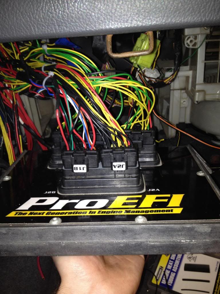

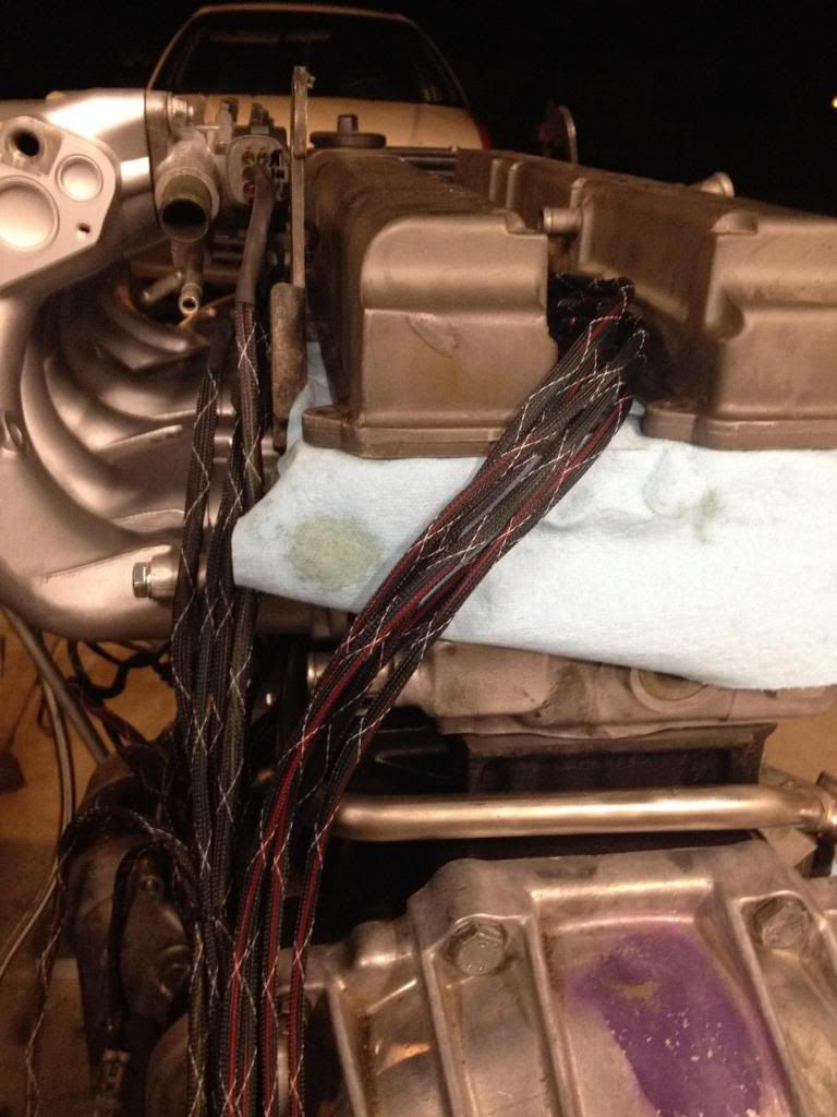

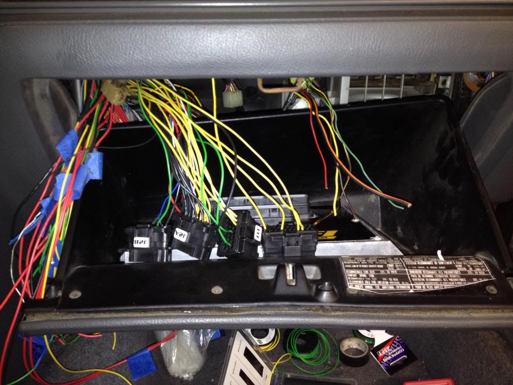

forgot my fuel pressure wire when i was making my harness but easy fix...
Friday night i believe...Albert came over and we started pinning
i think this was after friday night
Saturday / Sunday 90% pinned, still need stuff like flex fuel and boost controller but everything to start the car is there besides the fuel pump trigger
