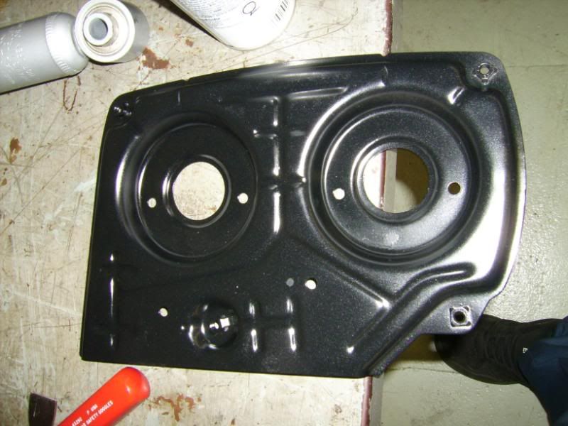

so this is what i got done today! not much, but tomorrow is gonna be GOOOOOD:evil2:

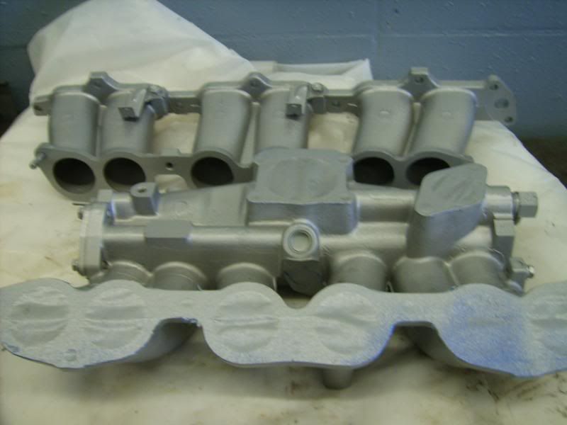

sandblasted the pumpkin
a beautiful hammered silver finish. it came out NICE! :love:
this is what i got done on the block. so COLORFUL! i love it :biglaugh:
haha i painted some more things! it's an addiction i swear lol

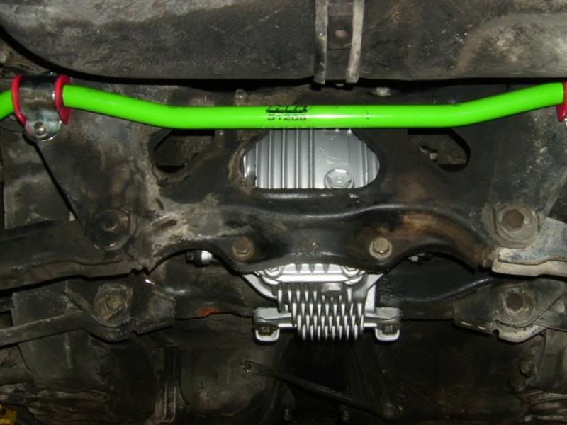

a) Wonder how much grit/dust from the blast cabinet got up inside the vent and how long till the Diff dies?

a) hopefully not THAT much. if anything, i can take the color off and clean in out

a) well, it's not full of oil yet, so i guess i could do that

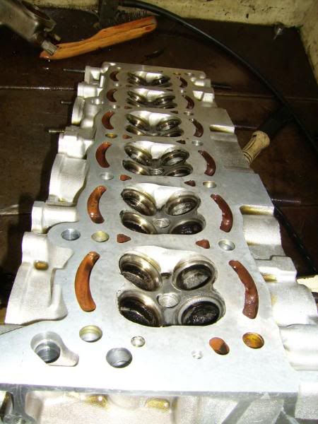

like i said. i got the head today and got started :icon_bigg

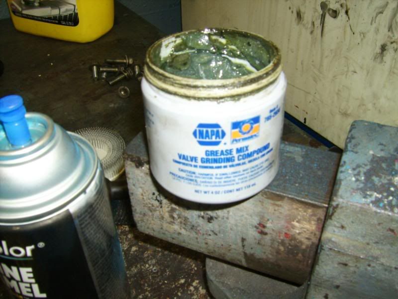

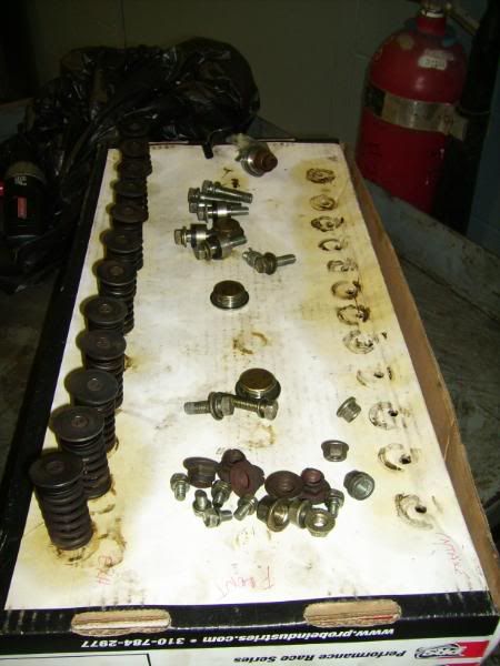

cleaned out the head again and started lapping the valves. damn that was tiring! :aigo:

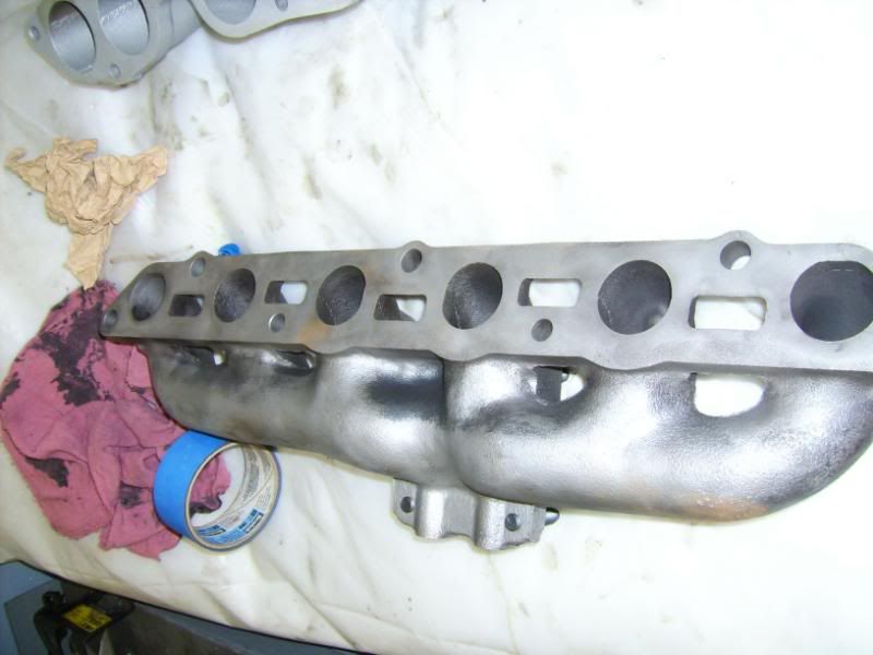

somewhat bead blasted the exhaust manifold

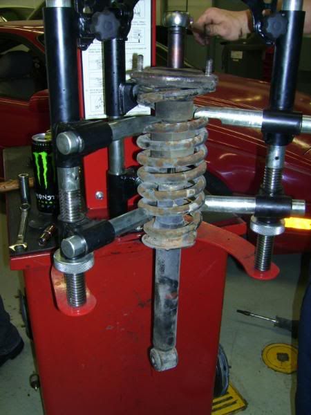

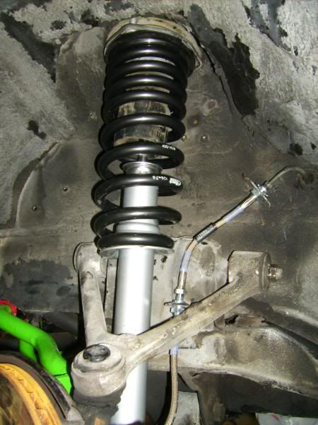

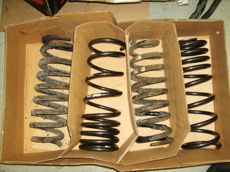

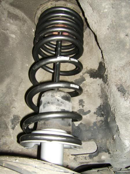

got the new Eibachs and GR2s on the front. the rears will be done tomorrow :icon_bigg

damn man, i wish i had this much progress this quickly. how would you suggest me clean out my exhaust manifold? i don't have any access to a sandblaster or anything

haha you can't get to any parts washer? hmm. that sucks. i'd say ALOT of carb./throttle body cleaner. it dries faster than brake cleaner. and maybe a small wire brush to scrub the ports out good. they do sell like cleaners at auto parts stores. maybe askin one of them what they recommend wouldn't hurt...and maybe some HIGH TEMP paint to make it look all nice =0)

Actually brake clean dries a lot faster than carb cleaner. You can get your manifold sandblasted by a local shop for cheap or you can get a small sandblaster from Harbor Freight Tools for cheap.

haha i thought it was the other way around.
oh yea. i replaced my rack, sway bars, struts and springs. SOOOO much easier without having a motor in the way

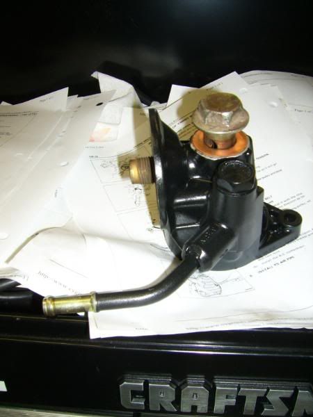

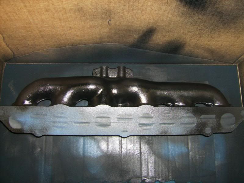

started painting the exhaust manifold in good ol' high temp black
got the old rear struts/springs out and installed the rears. CAN'T WAIT TO SEE HOW SHE SITS!
after cleaning the inside alittle bit, i installed the lsd. looks NEW!

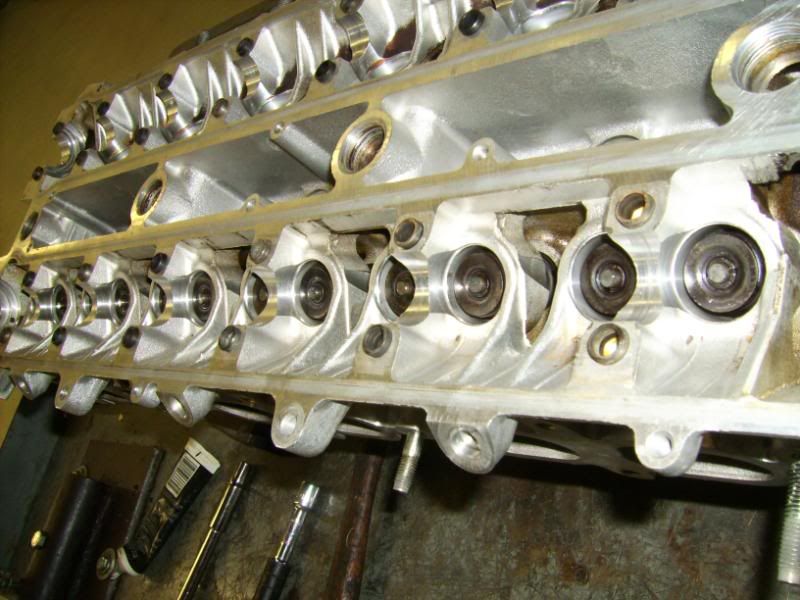

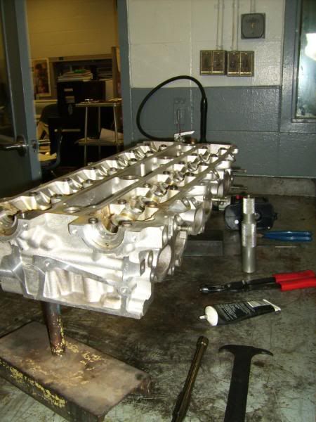

this my head work station with the head sitting on stands

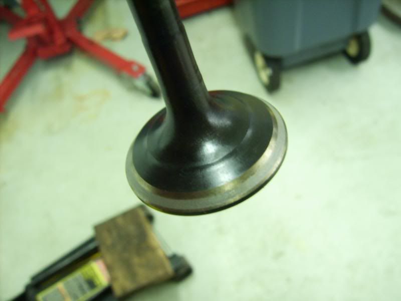

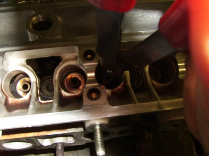

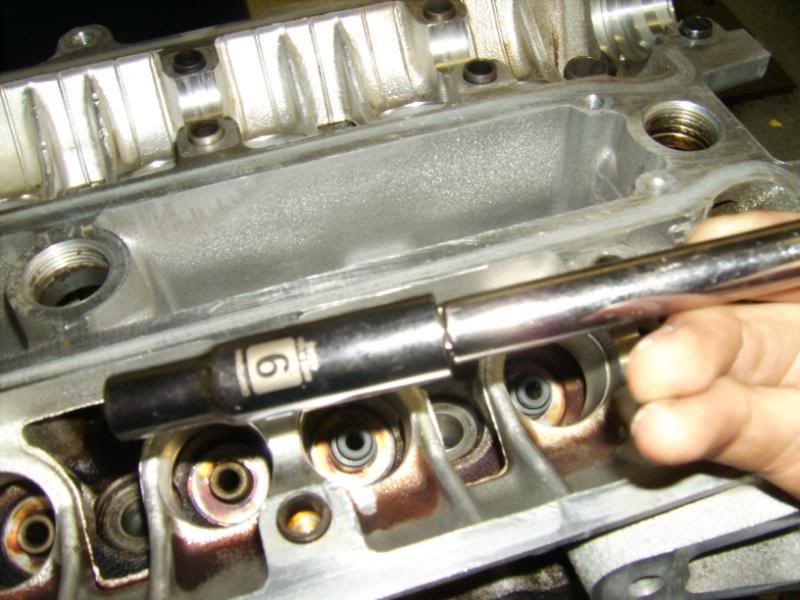

here's me literally installing the seals
i used a 9mm deep set 3/8 drive socket with an extension to firmly place in seals in. the socket fit perfectly over the top of it. it also helped with keeping the seals in place when i put the valves in :naughty:
here's that crazy kat (me) lubing up the valves

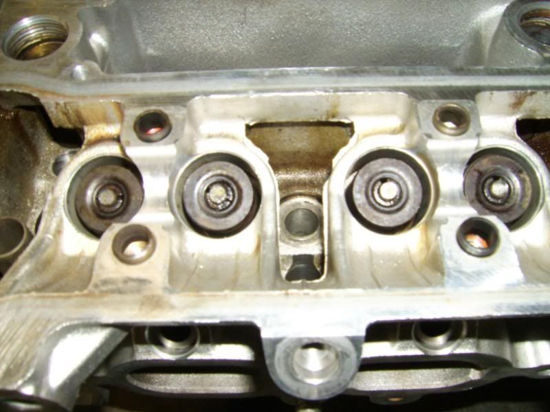

got a some valves permanently installed
finally got all the intake valves/springs and whatnot done. that took alittle muscle :aigo:
so the exhaust side is up for tomorrow and possibly putting the head on the block. we'll see how it goes! i'll keep you updated...............with pics of course :icon_bigg

heh...that exhaust manifold is going to flake VERY quickly.... none of the high temp spray paint will stay on the exhaust manifold. it will look pretty for about a day or two and then look like shit ;)
