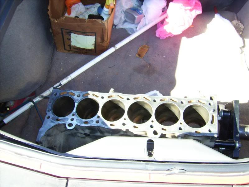

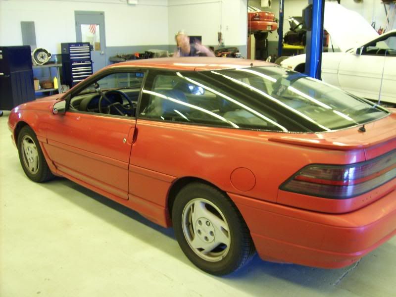

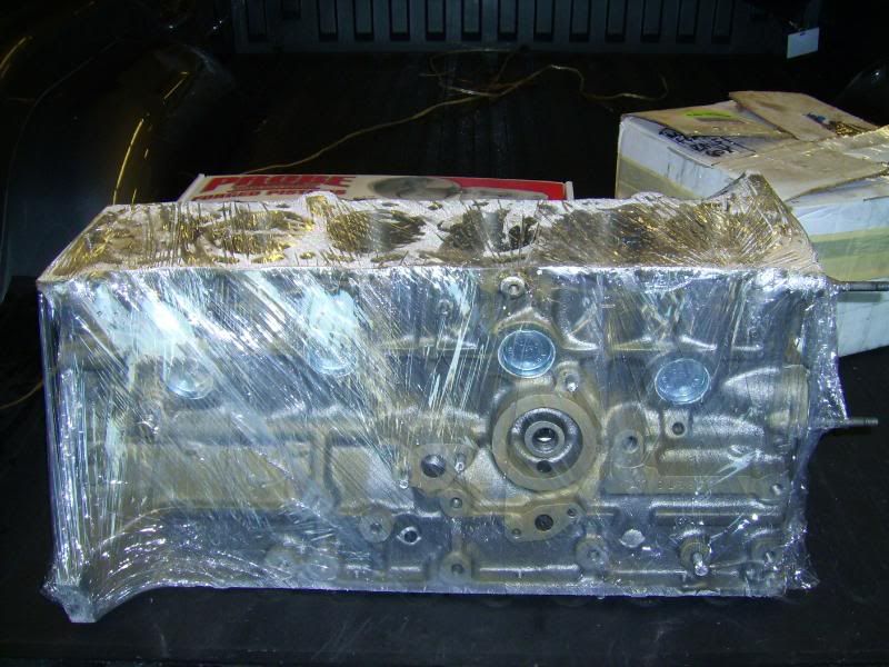

my block and other rotating assembly parts loaded up in my Probe to take it to the machine shop :icon_bigg
and this is my $400 DD 91 Ford Probe GT Turbo.
...yea i know. definitely not bad for price though. drives perfect!

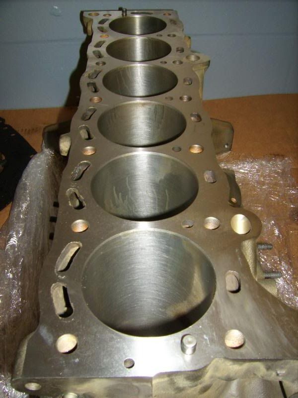

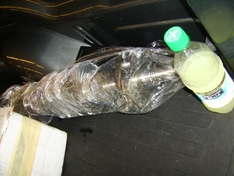

got my parts back all nice, clean, and BALANCED! :love:
i was alittle sad that the machine shop couldn't get brass freeze plugs for it :nono:

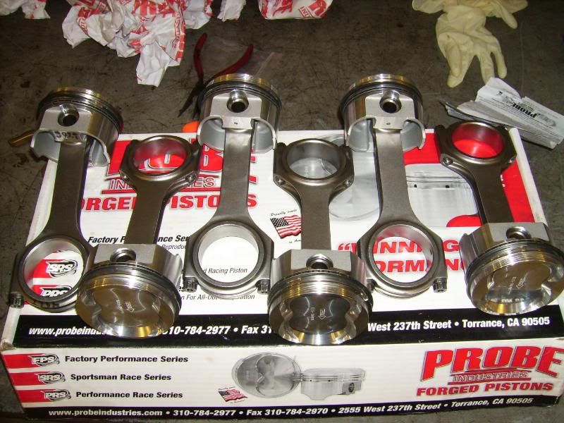

i put my lovely Eagle rods on my new pistons...spiro locks SUCK!

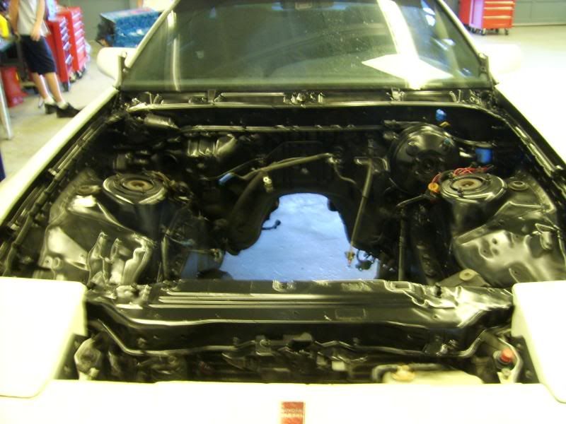

painted the stained engine bay gloss black! picture quality sucks, but you get the idea

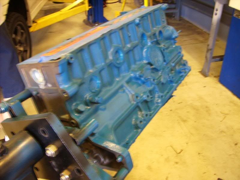

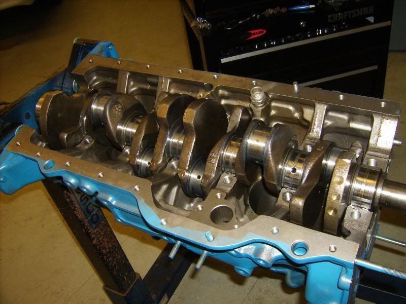

after some HEAVY DUTY cleaning and dead tired arms from cleaning out EVERY FREAKIN BOLT HOLE, i put a couple coats of Ford Blue high temp paint. I DON'T CARE! I LIKE THE COLOR!

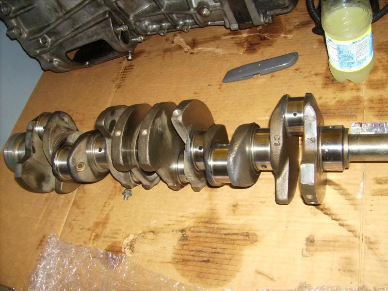

crank is just chillin in the block.....................waiting :icon_bigg

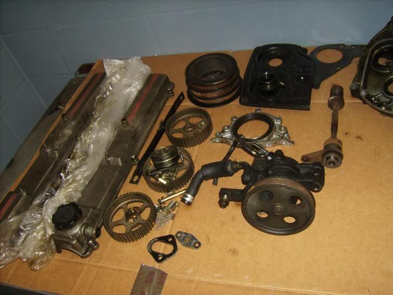

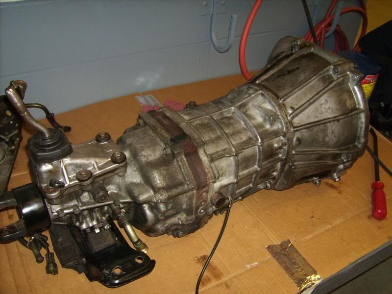

i got the tranny chillin on the bench and other parts off the new motor
so nice new parts that will be added at a later date :love:

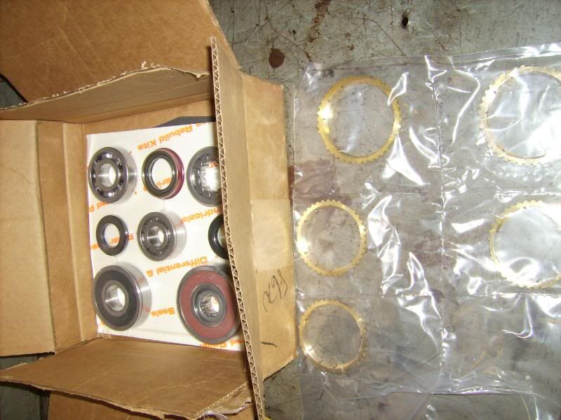

and my r154 rebuild kit from DM. we'll see if i actually have time to do that :icon_mad:

hey ted where did you get the machine work done....
do you know what RA they did the block to? ALSO did you make sure to get the timing cover decked with the block? (I think i see it in the wrapped up pic you posted)
Worries me a bit it still looks a little too rough for a MHG seal. Could just be the picture though.

i sent it to United Speed World. that's what F&H recommended me to go. i'm not sure the exact RA it is, but its pretty smooth. the pic doesn't really do it any justice. you'll be able to see in other pictures.
what would happen if, lets say i didn't get the timing cover decked with the block?
Ted: The HG WILL leak :(
Also did you get the rods on the pistons facing the correct way?
64
the t3d;905452 said:
yea the rods and pistons are all facing the same way. i already have the shortblock assembled. what should i do then????? =0(
If you have a shop handy you can get them to mill the cover so it's the same height.....
If the Block and Cover weren't decked at the same time the Cover will be higher and hold the head off the deck causing a leak.
But are they facing the correct way? ;)

the t3d;905456 said:
i don't see why it WOULD leak? can you explain it alittle more?
the hg sits on top of that timing cover as does the head... so they all have to the same height. as IJ said if you do your measurements carefully you should be able to have them mill the plate down to the right size...but it really needs to be exact or youll have a hg sealing problem.
yeah united speedworld is pretty good. they have a nice laser cutting machine there that use to do resurfacing and decking etc... So ill assume its just the picture ;)
And IJ wants to know if they are facing the right way not that they are facing the SAME way ;)

the t3d;905460 said:
i look at the pics i have and looks like the timing cover is alittle below the HG surface.
and LOL YES they are the correct way
dont know what you are getting at here? lol
if you didnt have it decked with the block it needs to be cut down to match...
