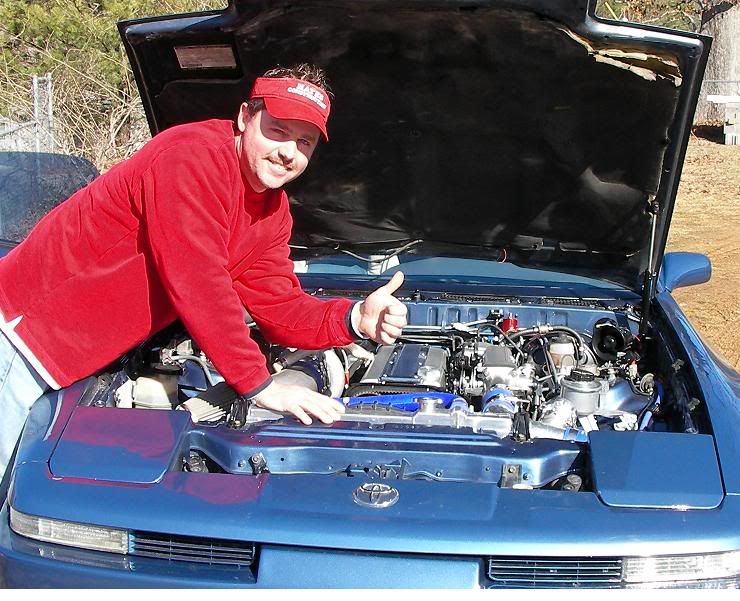

Nate requested this pic:
56
My car is a little more photgenic than I am, but I've spent alot more money on it's appearance than I have on mine.................:biglaugh:

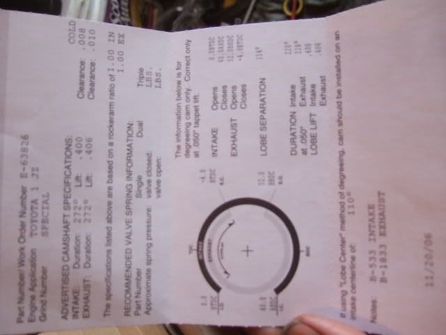

Jay, post a pic of the cam card that came with the small cores. I want to see if the overlap is that bad.
Also, what's your vacuum at idle?
I not arguing with anyone, I just don't think the small core cams would drop static compression 30 points, and I'd like to see the card anyway.
FYI, cam card for large cores.
Jay, if yours are .008 for the intake, then it looks good according to crower.
Super trick vid on how to degree the cams out of the box.
http://www.youtube.com/watch?v=_MsqA-C3vGI
But uh, yeah.
56
My card reads that it needs -1 ATDC for the intake and -9 BTDC for exhaust.
My lift is .344 for intake and exhaust. It also saids that my clearance for intake is .008 and my exhaust is .010 which is closer to what it is. I printed something off of the internet and it said exhaust needed to be .012. I'm going to go check the intake side clearances in a minute. I'll post back the results...........lol
