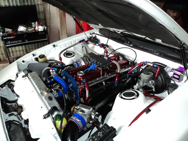

clutter? not if you build it right. example, nashmans car:
Also depends on your budget. You can also compare a rebuilt 7m with all appropriate parts, such as forged pistons, etc to a stock 2jz swap. Mods are the same price essentially, so ignore things that get upgraded like injectors and turbos. Compare the shortblock of each motor, dollar for dollar.

Lol you couldn't find a better angle? One where we couldn't see the new greedy lemon bottle over flow. It takes a lot of work and money to clean it up like that. I'm guessing over $1000.
And still the jz looks cleaner.
