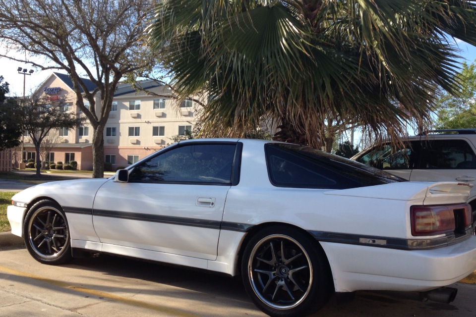

Did an awesome burnout in front of my buddy's house the other morning. Disappointed the marks aren't darker though. If there was anyone sleeping I'm sure I woke them up, haha.
Random shot in front of the gym the other day. It really could use a little drop.

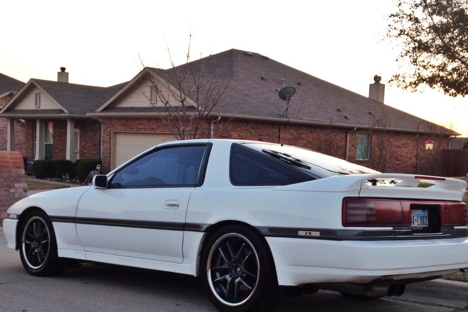

Well a quick update.
I've lowered the car with B&G springs. Ruined a shock in the process because it is now leaking but a new one will have to wait.
I've replaced the BOV with a recirculating one and that has cleared up the stalling issues and running rich.
Had to replace a caliper that was seized up.
It now has a bad powersteering leak. Will be looked into after TX2K13 this weekend.

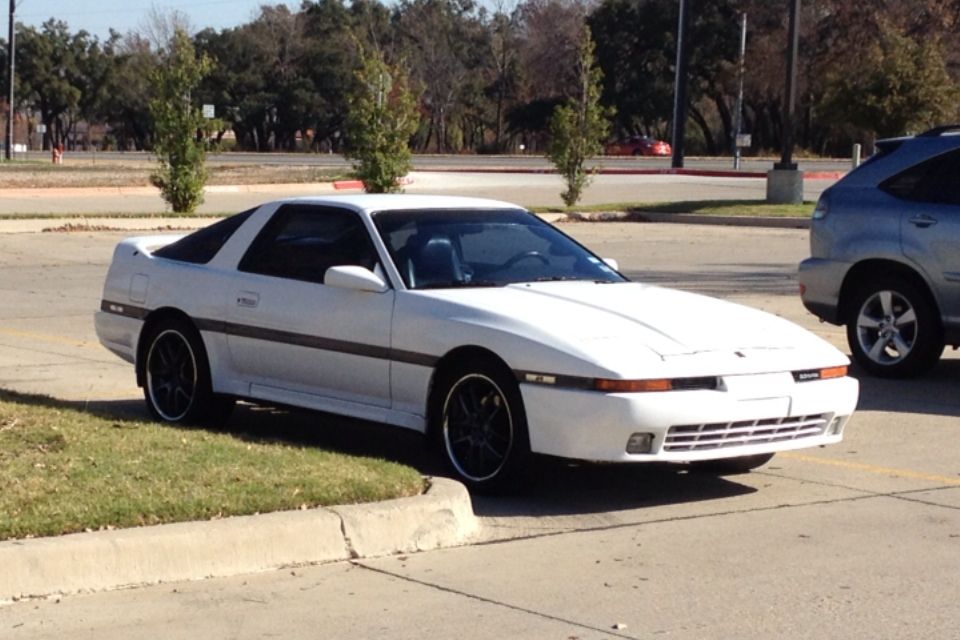

Anyway, that's about it for now. Here's a picture I took today.

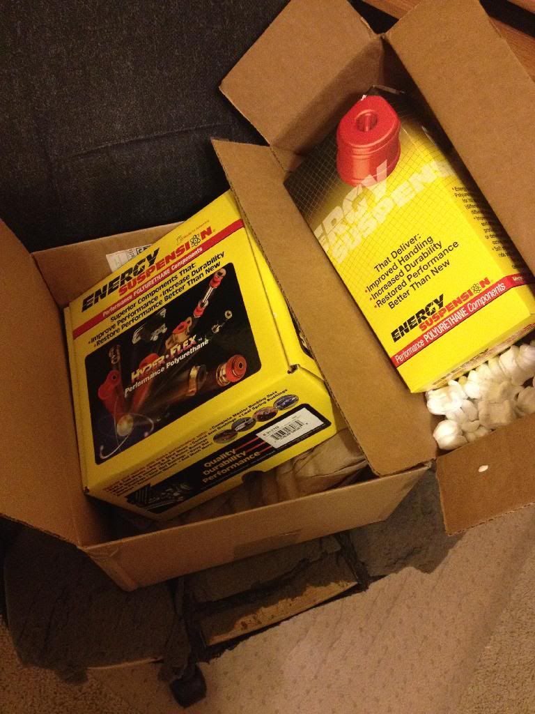

Update on this cars goings on. If anyone remembers it haha.
Got some goodies in the mail the other day. All the suspension bushings are about to be replaced. This car is sloppy as hell going down the road. Those aren't the only changes I'll be making.
