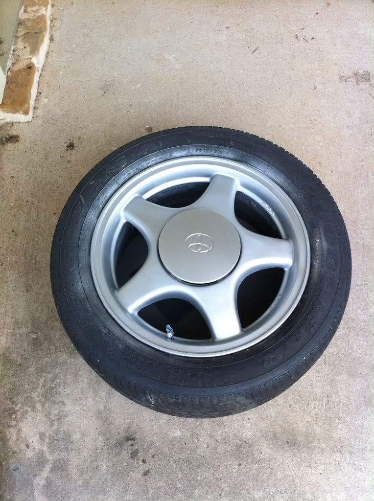

Also I'm slowly working on repainting my 5 spokes so I can get new tires on them and then put them on the car.

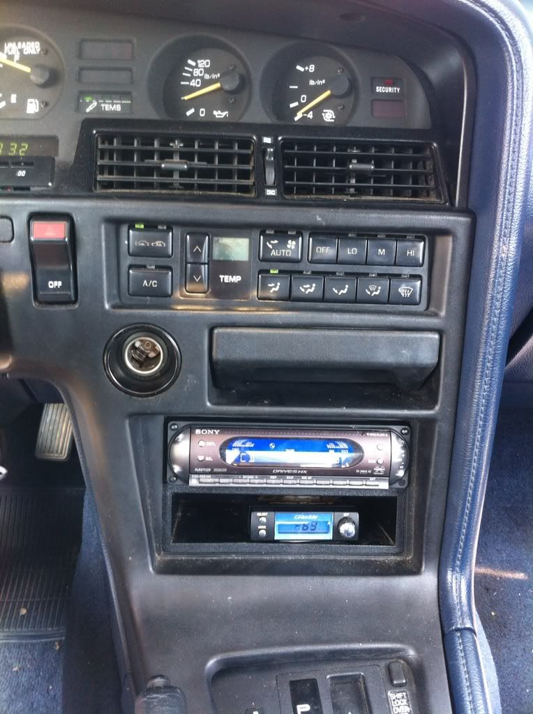

I really like the cleaned up console/pillar pod job you did there. That looks MUCH better. Also, I'm a big fan of stock looking too. Those 5-spokes should look really good on the white car. BTW..I've always wanted those wheels you currently have, what are you doing with them? I think I have convinced myself I want a deeeeeper lip though.

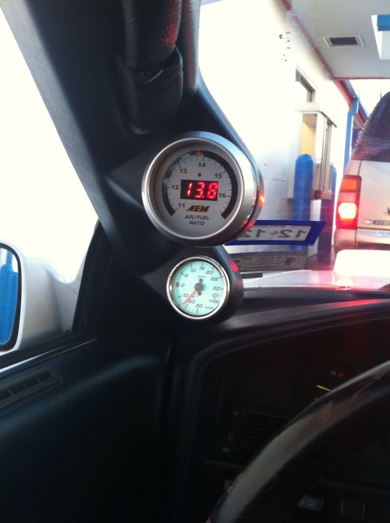

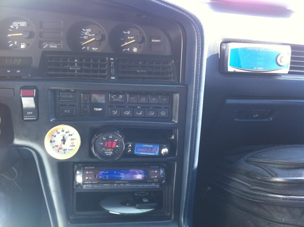

gtsfirefighter;1842832 said:
This picture brings 2 questions to my mind.
1. The aftermarket boost gauge is showing -20 (meaning it is running), while your stock gauge is reading 0. Is that just another case of a garbage stock gauge?
2. And, looking again at the stock gauge, what the hell is -4? Would that mean that each 1 is equal to 5? And if so, would +8 also equate to +40? Just trying to make logical sense out of things.

The car is running and the stock boost is connected. Notice the suitcase on the passenger side (I had the back full of parts Jay had given me). I took that picture while driving back from Alabama. The deal was the vacuum lines at the time I bought the car where everywhere but where they should've been. No emissions in good ole Alabammy. I've since had everything put back in order and believe it or not, the stock boost gauge and the aftermarket one are pretty much spot on with each other. I know I need a better aftermarket boost gauge but the Faze is doing just fine for now. For the money a good one cost, it's low on the priority list. When I get the car sorted for the most part then I'll upgrade it.
