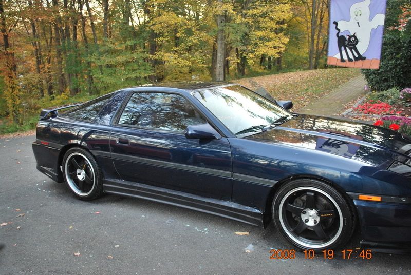

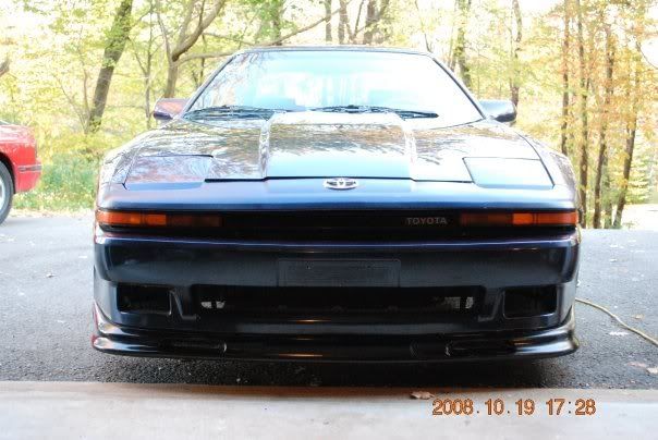

2 more i found....i know i need to paint the sides...i think im going to go bomex sides and rears so ive been pitting off paint.
