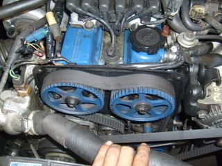

Soooooo I went and saw the car today. Finally. The intercooler piping and and blow off vavle were stolen. And it stopped running because the timing belt tnesioner broke. I hope everything is fine with motor. To the best of my knowledge its non interferance so you can free spin with no problems.....right? Anyway I have 3 options (I'm paying 1000 to get it back) I'm either going to part it out, fix it with the 7m, or swap my 2jz in. Any suggestions comments?

IJ.;1111715 said:
Unless you're running huge cams or have had heaps taken off the head and deck with a thin HG our engines are non interference so losing a cam belt isn't fatal.
Yeah I doubt the motor is damaged because of broken timing belt tensioner unless they drained all your coolent/oil out and ran it with out them, then I can see the motor not being in good health...
ij thank you soooo much. i acutually tried sending you a pm to this thread im really glad yo read it instead. the motor had weisco piston a metal headgasket and valve work. stock cams thank god.
thanks again. i look forward to semi staring over again.
i am going to try and get it finished for the last couple drivable monthes. this winter depending on many factors i may or may not sell the motor (if it checks out ok) and swap in my 2j. only time will tell that.
thanks again brain,ian,ryan and alex. you guys helped me out alot.

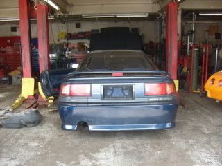

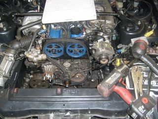

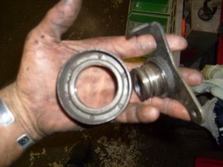

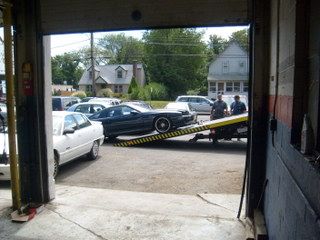

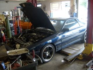

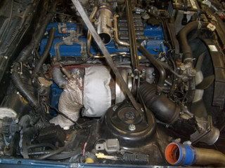

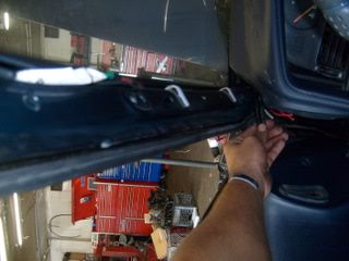

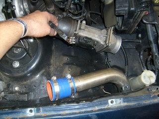

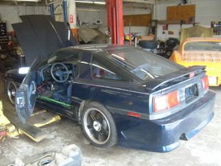

i got it back today. after i went and saw it on saturday of last week the shop it was at took t upon themselves to steal as much shit as possible off the car. i called my lawyer and i m pressing theft charges against them because i have proof the parts were there. so i have to do that next week. anyway heres how i got it back after 2monthes.
arriving t the shop
stolen hardpiping with my hks bov
ripped pins out of sensor
slipped timing
stolen a pillar gauges
the tensioner that grenaded
in the shop
