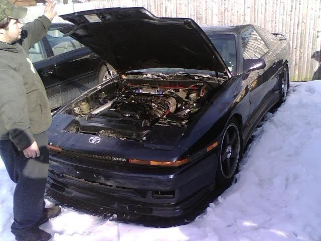

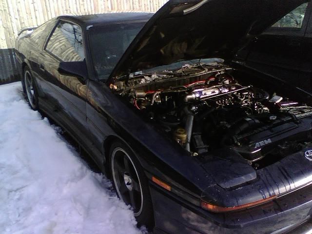

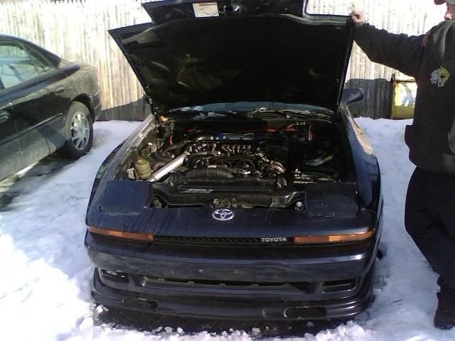

heres a pic update...moved outta storage and did a few things. needs a good cleanin and waxin ill say

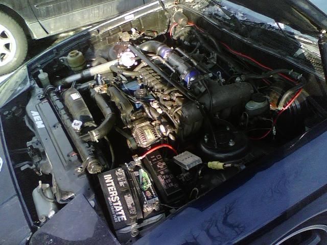

time to throw a little up date up here. i am shying away from the jz swap. i am going to keep the engine as a back up and if the 7m pops maybe ill go that route.
right now i am taking care of an oil leak in the front of the engine. not interested in finding out the soauce just gonna resael the whole front. valve cover gaskets, cam seals, auxilery shaft seal. water pupm, and front main.and im goin to do the water pump since im gonna be in there anyway..flush her and fill her with toyota red.
after that i have been researching a new turbo setup...right now this is what ive come up with...feel free to chime in anyone
gt42
halteck standalone
720cc injectors
sard fuela pressure regulator
manifold
downpipe
a FFIM...not sure which yet
new intercooler 3in piping
bosch 044 pump
-10 feed -8 return
i want to run 20psi and be over 500
(i have the budget for this so if anyone feels i am skimping somewhere speak up)
am i being realistic (the engine is built) most details about the engine in post #1
