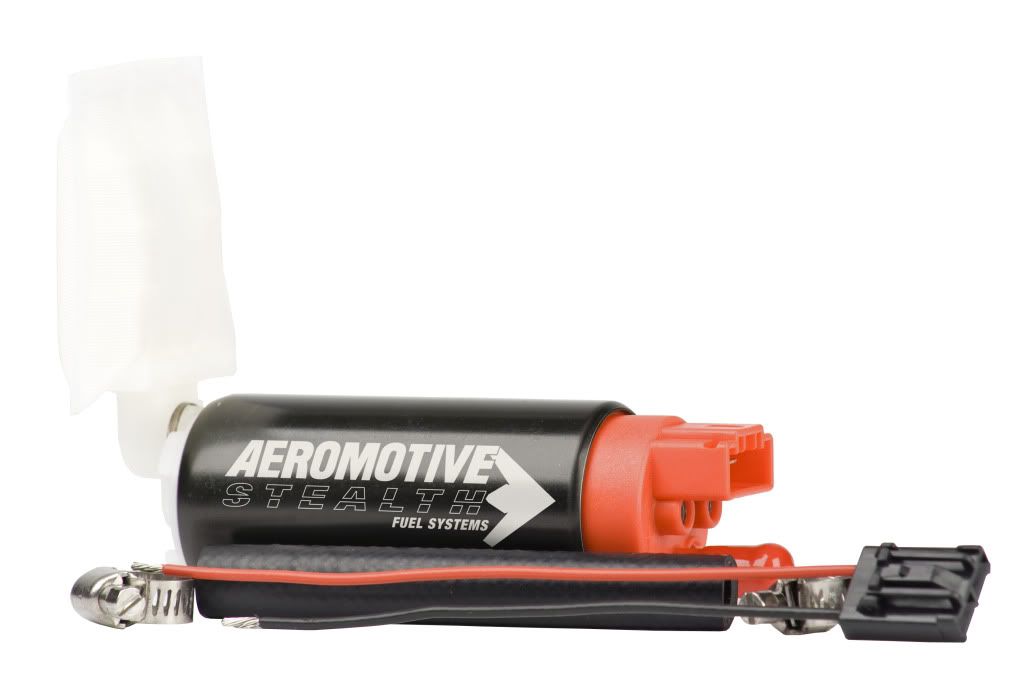

Steve have you seen these new Aeromotive stealth 340 pumps?
With a boost a pump at 17.59 volts aeromotive flowed one at 433LPH with 60psi of pressure

lol, looks just like a walbro...
Anyways, I just bought some 272's for the car and am startig to once again get fuel on the mind. 1350's from FIC and some -8 fuel lines should help.
Main issue would be seen above- which fuel pump to use!! Bosch 044, Fuellab prodigy, A1000, duel densos (with tank modification, obviously) So many options!

Those aeromotive stealth pumps are physically the same size as a walbro so fitting two in should be easy enough man. Otherwise if I were to do it over I would run a magnafuel.

Enraged- I've ridden in walbro pump'd vehicles and was not a fan of the noise output of the walbro, plus their flow drops off pretty badly once FP gets higher. I'm planning on running this turbo up to 30-35psi, so high pressure performance is a must.
IJ- didn't you run dual bosch 044/040's (german ones)? Dual densos is not out of the question, but I would be welding a new fuel tank panel into the tank if I went that route- an oval one from a camry/tundra, etc for them to fit easily.
Sean- I would like to hear one of those stealth pumps in person to make a call on them- their flow pattern suggests a similar gear-rotor design to the walbros. Makes me nervous about noise levels.

They are fairly new (released in dec 2010) so your best bet would be a phone call to aero.
