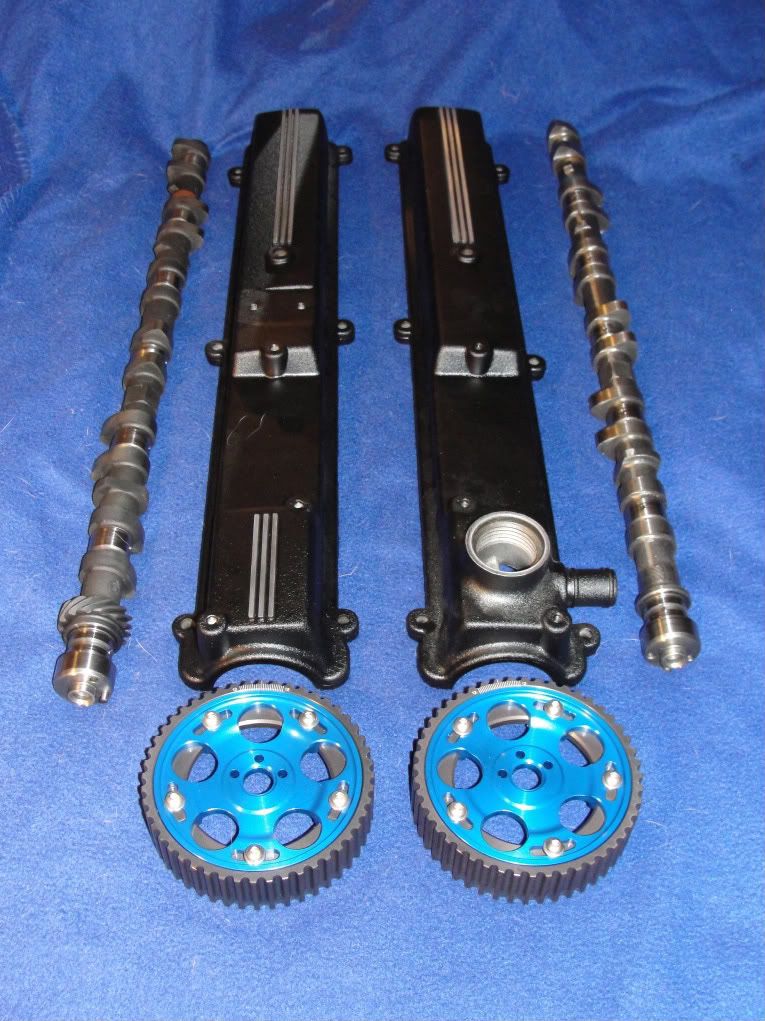

Ooooh so many parts are sitting next to me :D Cams got here today, gears and covers were yesterday!! I'm goona have a good weekend (followed by lots of valve clearance setting D: )
This will be following shortly after...

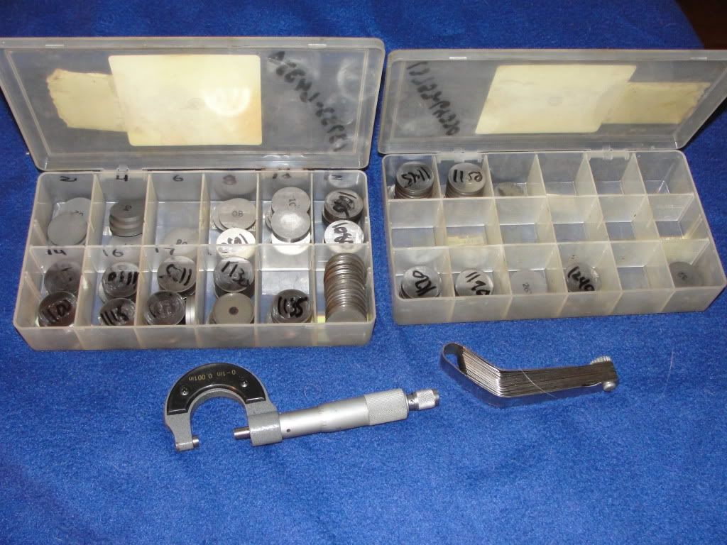

Exhaust side done. I'm a cold, sore person right now, and I have to do it again tomorrow night on the intake side! Got .010" clearance set on all 12 valves, and it took a lot of fiddling. These valves shall not make noise and they shall make powah!!!

Steve, looking good. I know valves are a pain in the ass. I well remember when you and Sean did the cams on my 2jz. Carry on!!! ::toothless::

Sorry, no can do, it's not mine. It's owned by the dealership I work for. I just borrow the box for shimming and pay for the new shims I use.
