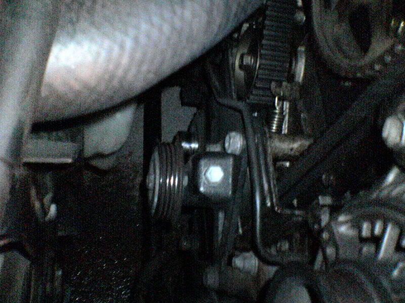

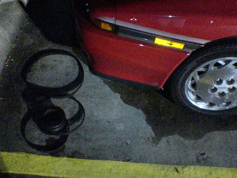

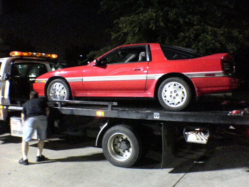

So ive been driving it around quite a bit and i decide to take it to a car meet on Saturday (this was last Saturday). I hang out with Weezl and a friend of mine with a prelude. After hangin out for a bit i see a few of my friends, one of which has a old silverado with a niice built v8. I hear that him and another truck is gonna go race. i go "eh, ill tag along and watch". Well i end up keeping up right behind em, and i find an open and manage to get past em. After that, i flipped a U turn and headed back to the meet (Weezl was still there). On the way back, i hear this "ca-clunk" sound. I go "eh probably just a rock or something". So i keep driving to the meet. While going there, i see the alternator light go on, and power steering is gone. I stop at a light and it goes away. I come to the next light i notice my temp is creeping up to the red zone, alt light comes on and no power steering, I pull out of the light and find Weezl at the tacobell just out of the light. I park, and i hear coolant coming out of the overflow tank. Turns out my Harmonic balancer fell off and the "ca-clunk" sound i heard earlier was the bolt (had to be). I was quite surprised, hopefully everything is still ok, as it never got into the RED on the temp gauge as it did when i had a BHG and it still isn't knocking.
Anyways, here are some pics of that night, decided to get it towed home. So i used one of my friends' AAA tows and got it towed home for free.
Harmonic balancer and belts, next to car and coolant on ground.
