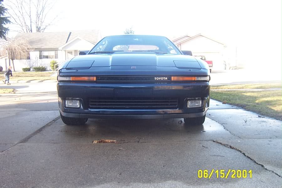

I (me) also installed one of the few bling items that I will allow on my car.
Euro turn singinals for the front.
I like the look.

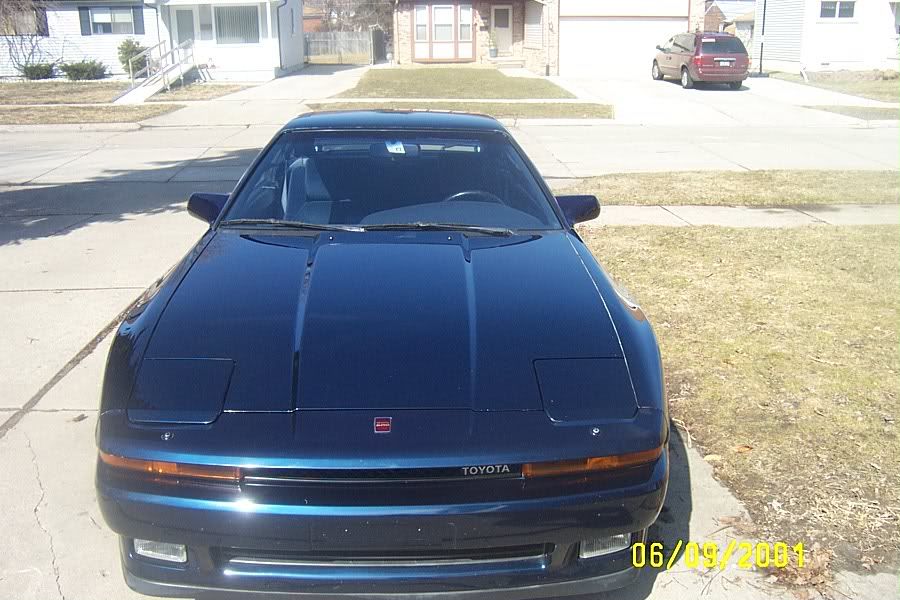

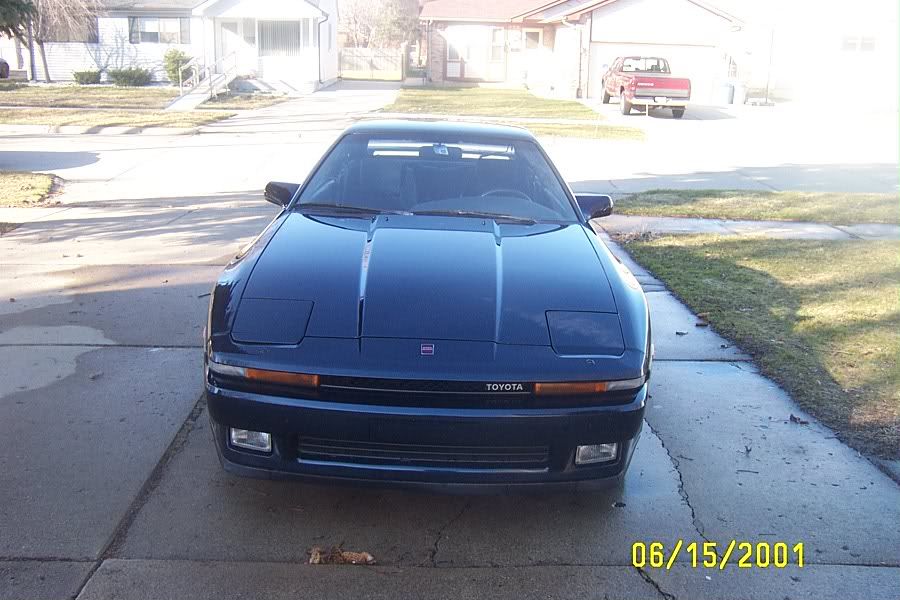

Before
After

Car is looking really good, I like the euro turns more and more everytime I see them. I think I'm going to have to pick up a set once I get the new car.

yeah i love mine. I'm lookin for a set for my friends 88 - our cars have always been twins, and thats one of the few things keeping them different. lol.

Dan: Looks great :)!
I notice your bumper is slightly higher on the right side? (So's mine I thought it had a hard hit on that corner but if it has the frame has been pulled perfect just the bumper to blinker/nose gap is off)

IJ- As far as I know the car was never in an accident. I am not sure why that side is a little off.

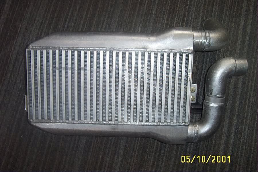

I have some other stuff ready to go on as well.
IC and complete set of hardpipes.
Maybe I'll take some pics tonight.

Dan: Yeah it's just funny it looks exactly like mine from the front (Only yours is MUCH nicer ;) ) When I was doing the IC install on mine I had a good look to see if there was any way to align it but there isn't!
Please do keep this thread going with updates and pics as things progress!

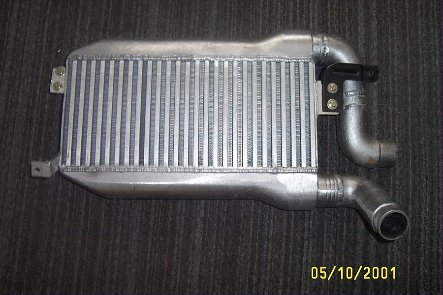

Cartech IC

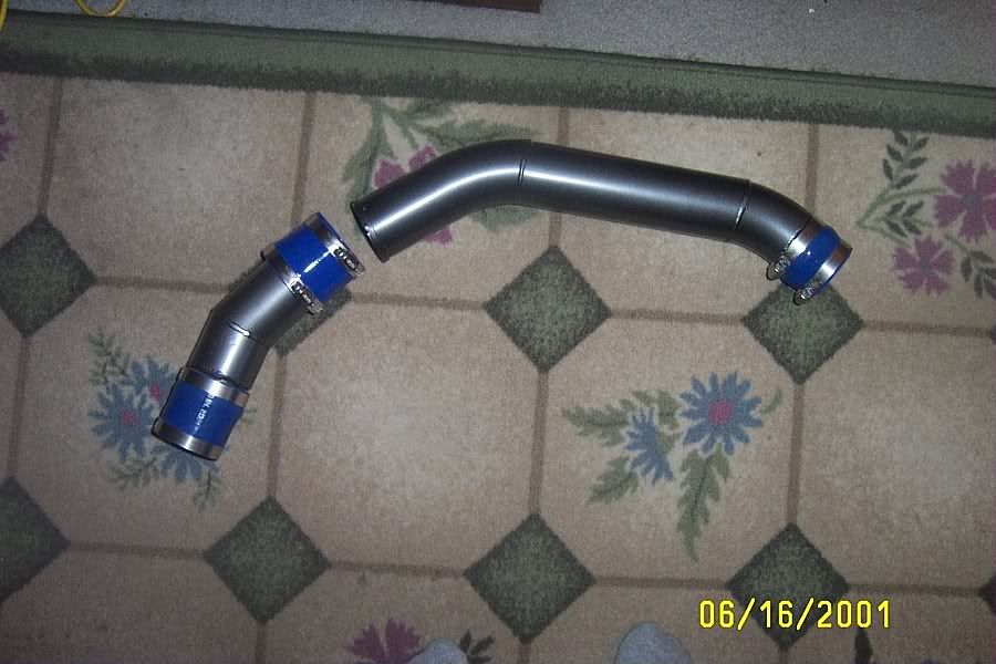

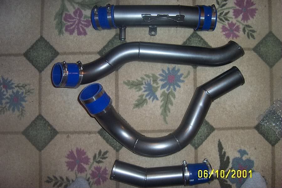

Cooleeze Pipes-These is a complete set of hard pipes from the turbo outlet to the throttle body.
And yes, I deleted the BOV flang and had him put the thing in the 3000 replacement so I can run a bypass valve.
Upper set
Lower set
