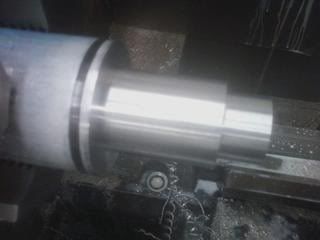

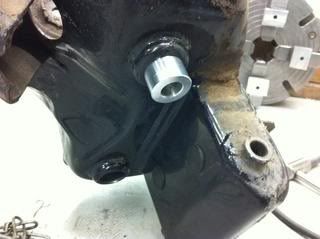

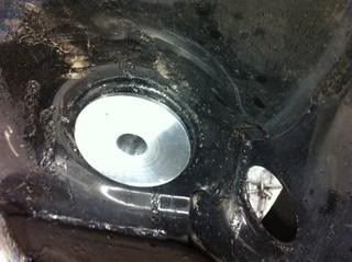

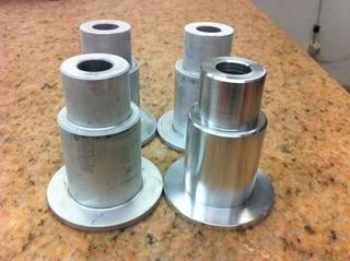

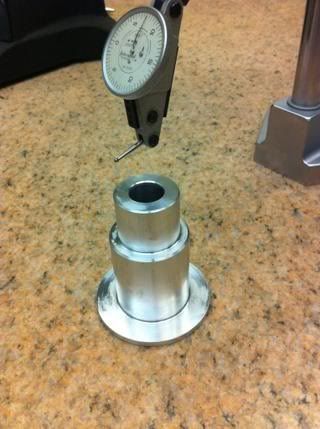

Hey guys. Just wanted to show you guys what I've been working in the last week. They are solid subframe bushings that are fully pressable, instead of spacers. I just use a .001 press fit, so all it takes is sticking it in the freezer for half an hour.
Right now I've only made the fronts, I'll have to start on the rears next week sometime.
Here are some pictures:
let me know if you guys have any questions or concerns!!
