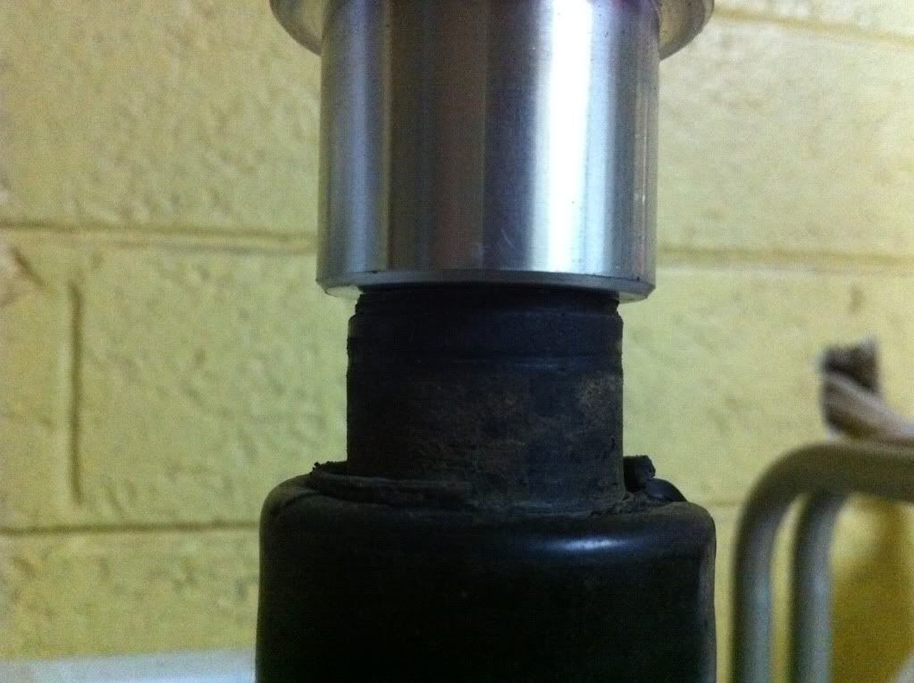

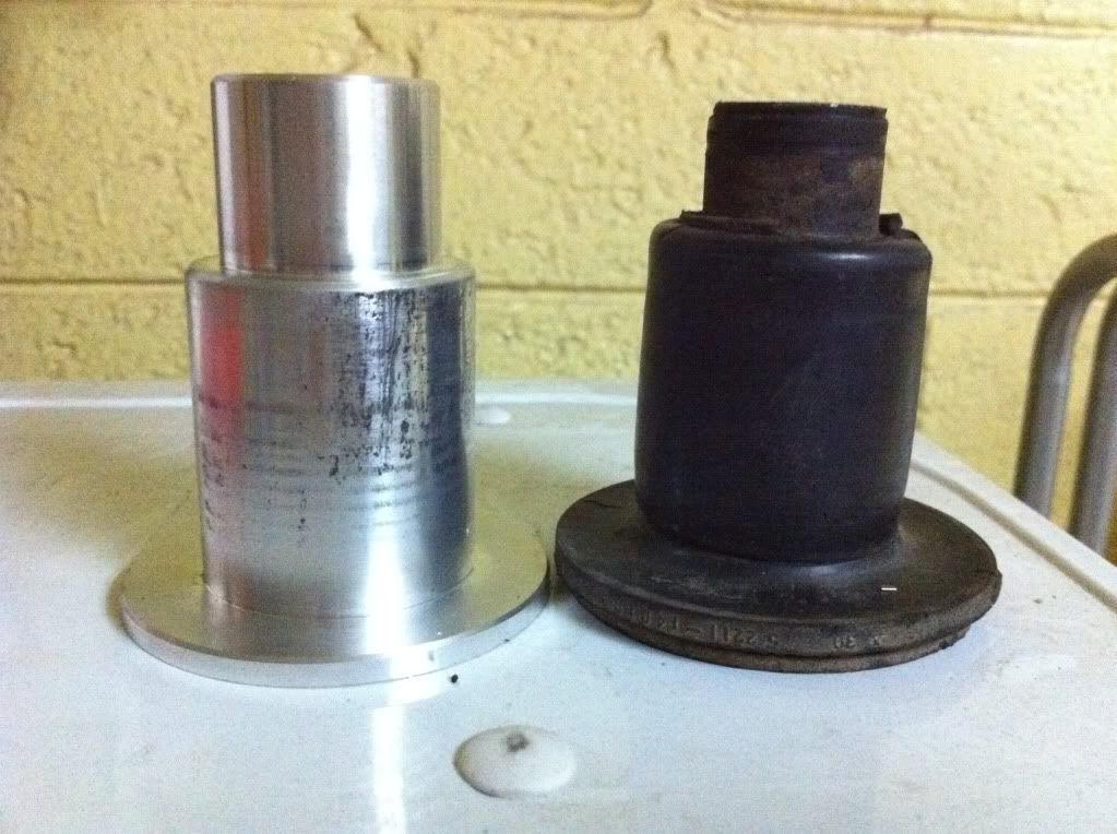

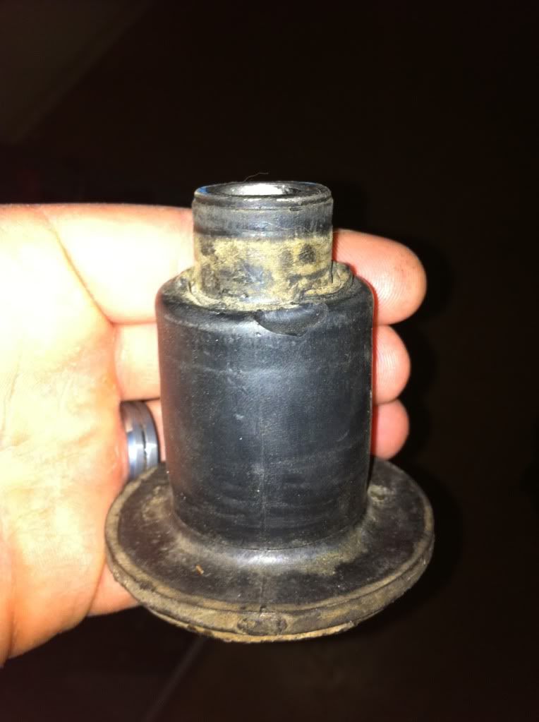

NICE!! Can you give a side by side picture? Definitely intrested in this, I would love to shore up my suspension & handling, and it cant be done with crappy bushings
ill shoot one when i get home have to press it out of the subframe but thats fine :)
