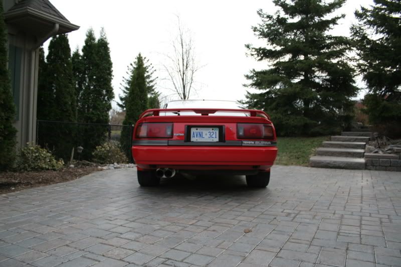

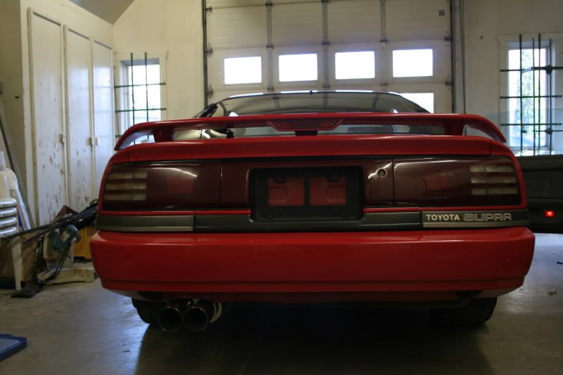

So I just installed the first part from my winter mods pile. The JDM tail lights. I just have to say, I don't know if I like them or not. I think this has a lot to do with the darker center trim. This confirms that I need to paint the trim or learn to live with it being mismatched.
I took many pictures during the install and I might do a write up on it just to clarify the modifications needed for the lock cylinder. I will check out the pictures and see if they turned out well.
This is the picture that shows the problem the best. I will take more pictures outside and from angles that make them look good.
After
Before

Hey man I think the 3 piece tails look beautiful and would look even better if you got a 3 piece spoiler but I see what you're saying about the darker piece of moulding. Have you ever thought about getting the 89+ mouldings for your car?
