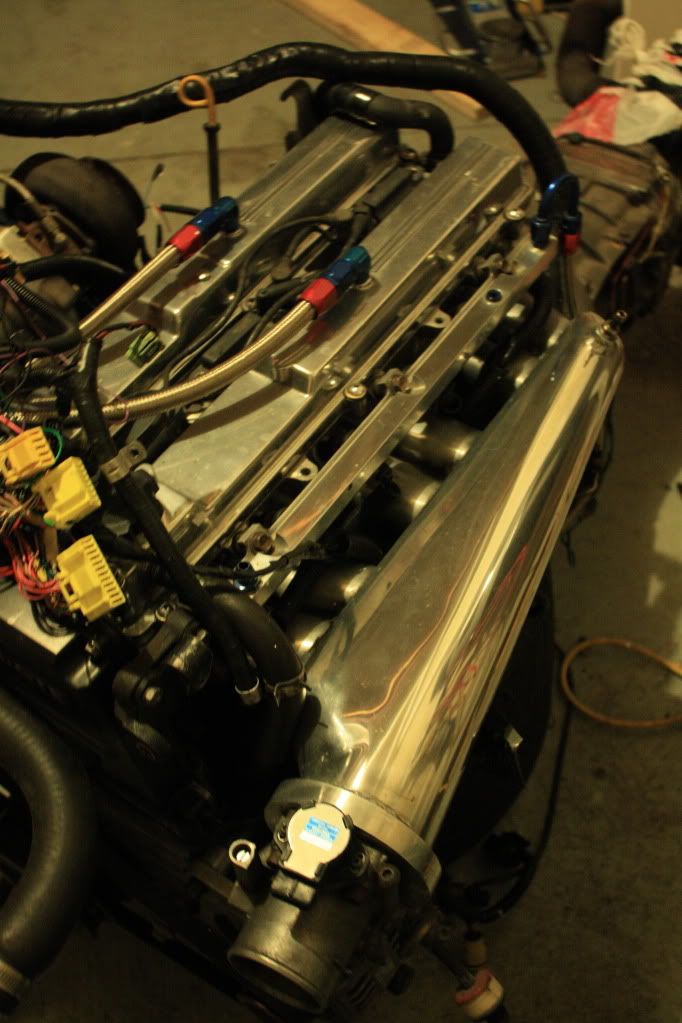

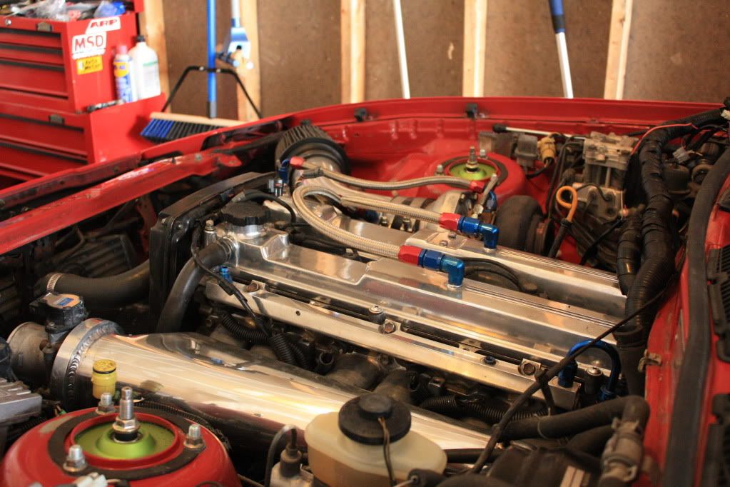

A few pictures cause I actually did some work. Spent about half an hour and buffed the intake manifold to remove most of the fine scratches. Not perfect but its the engine bay and I'm not too concerned. The cam covers will get the same treatment but later when the engine is in the bay. I don't feel like doing it now. I want the engine in so I can do more important things.

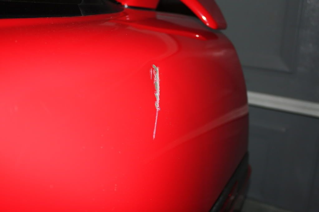

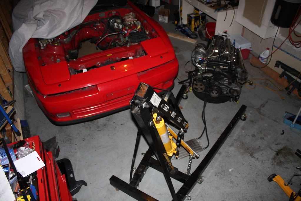

This is the big whoops I had recently and I am still pretty pissed off about it. I managed to let my engine hoist fall over into the side of the car. Fuck...
looking good aside from the last pic lol. FYL right?
Ah man. That sucks. Can't really tell from that angle, but is it deep? Sorry!

It's a pretty deep dent but it will be fixed in time. Just more motivation to get new paint everywhere.

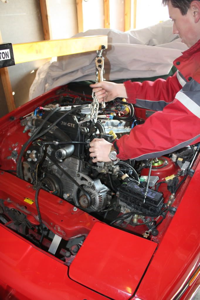

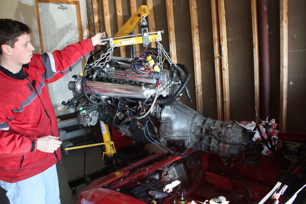

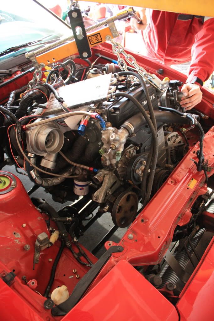

Today: Progress! My buddy Steve (Tireshredder) came by to give me a hand. We got the engine/tranny dropped in the car and bolted up. Filled the diff with oil and 2 ounces of friction modifier. Also slid in the 1 piece drive shaft ready for the diff to be bolted up. So now we finally get to see what it all looks like. I fucking love it!

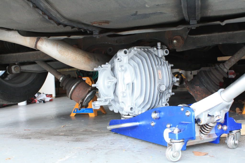

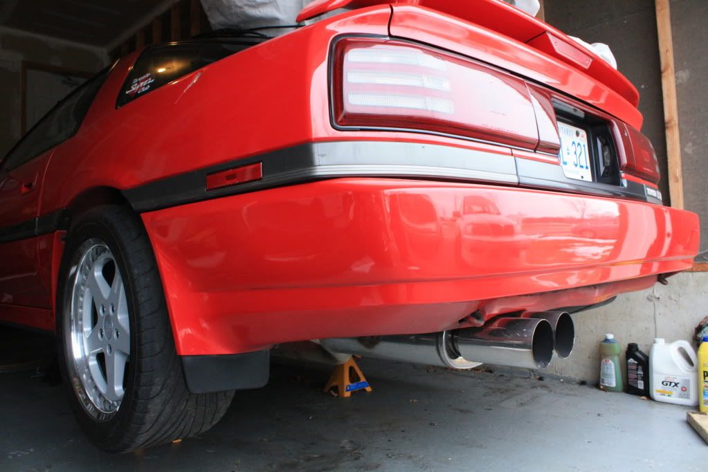

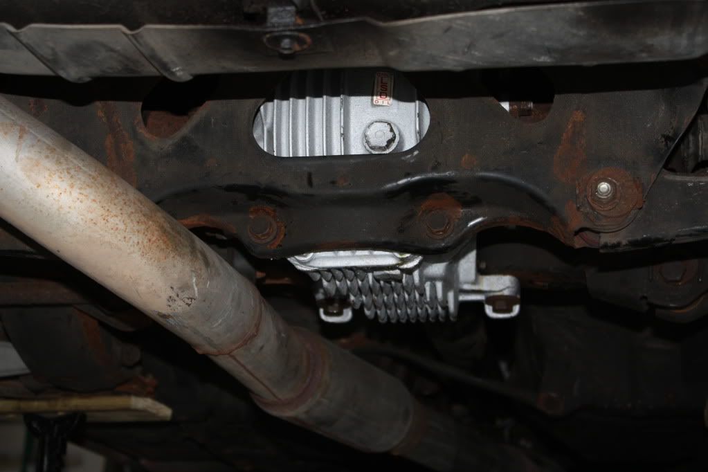

Anyways, got the diff in. Bolted up the axles and driveshaft so the rear end of the car is done. Now time to start slowly putting the engine bay together. Lots to do.

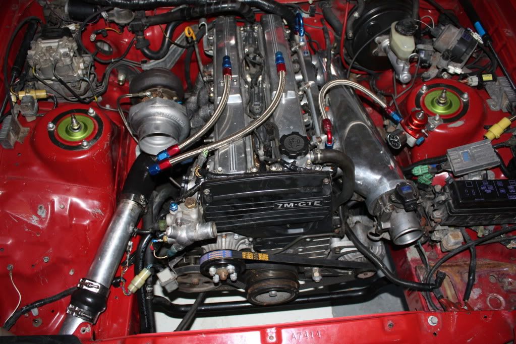

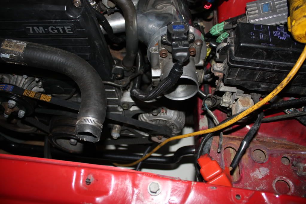

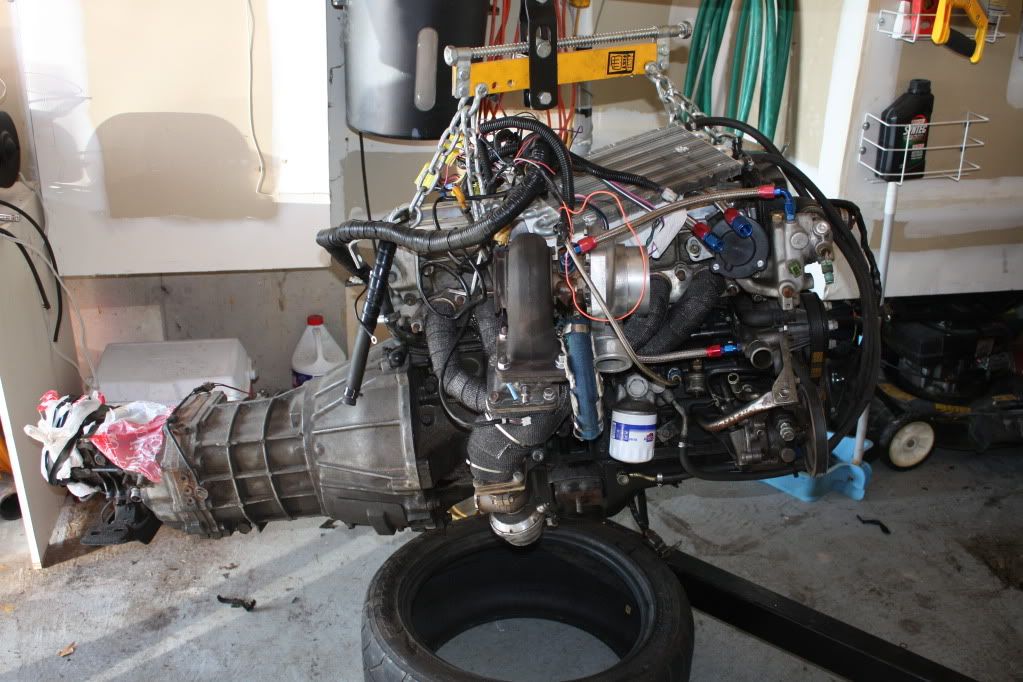

Did some more playing with wires yesterday. Got the rest of the engine connectors complete. Connected the engine harness to the chassis harness behind the battery. Adjusted the the wiring a bit so the alternator wiring would reach it in its new position. The got that belt tensioned properly. I think the next step will be hooking up all fuel lines and attaching the clutch slave and all engine grounds.
There is so many different things that need to be done its almost overwhelming. Just need to keep at it and keep getting check marks on the to do list.
Some pics cause I'm a pic whore.

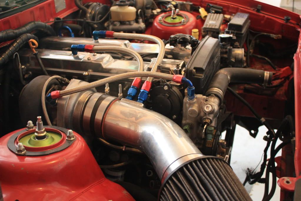

Finally got some time and warm weather. Spent a few hours each day this weekend doing things. Got the engine and trans oil changed. 0w30 Castrol for the engine and MT90 for the trans. Put the shifter back in too but I have since ordered new bushings so it will come back out. I clocked the turbo because the center section was on a pretty severe lean and I was told to have the oil feed and drains vertical. This became a huge pain because I had to shorten the drain line and now have to buy some braided stainless to extend the coolant feed and return lines. Oh well, I'm happy knowing that it is done properly.

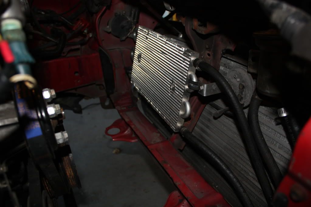

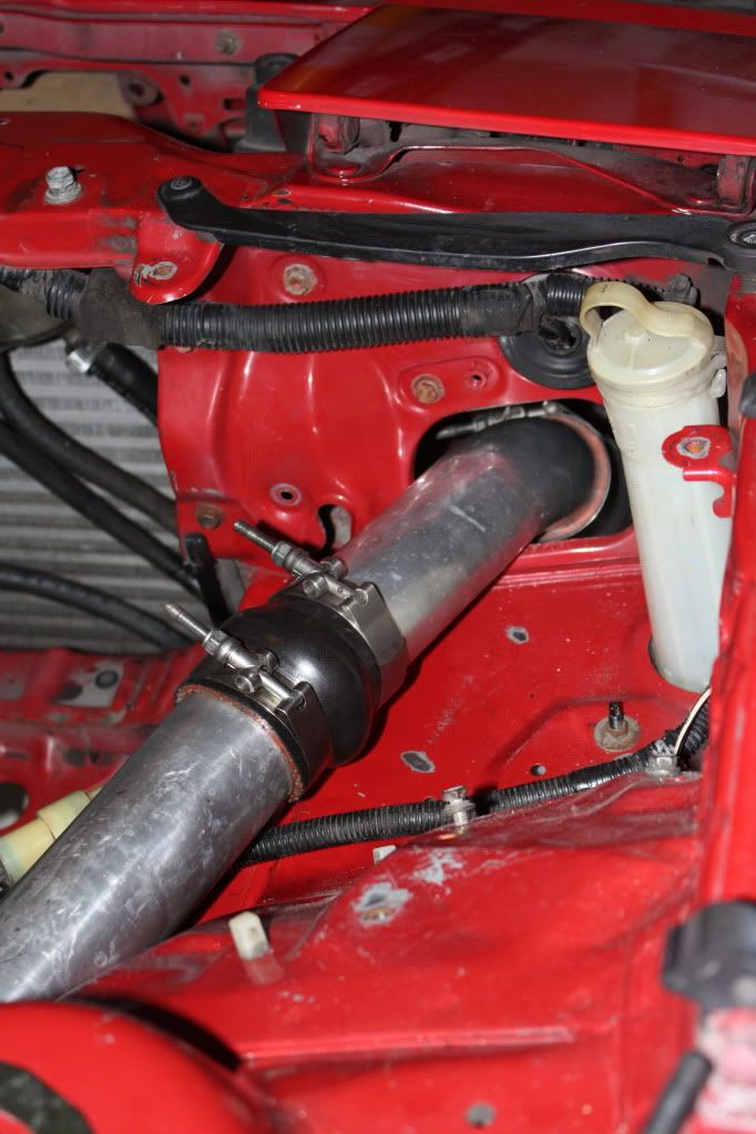

I then removed the remainder of the power steering lines and relocated the reservoir. Once happy with its new location I plumbed the lines and secured them with some cable ties. I then picked a spot for the oil cooler and made some backets to mount it. Pretty happy with how fast that came together and the end result looks pretty good. Next up was to start routing the intercooler piping. Since I have changed some things, nothing seems to want to fit. I will need to buy a few new bends and couplers to make it all flow together nicely. It seems to be very difficult to find black couplers for a reasonable price. Where does everybody go for cheap couplers?
So the current plan is to order some lines, couplers and piping so I can finish the turbo install. Then I need to get the rad fan shroud made so I can put the rad in place. Then I can finish the intercooler piping on the drivers side since I am trying to not relocated my battery. From there I can pick any project I like. I could wire up all y new gauges or I could find a new charcoal cannister and mount it. I need to wire up my new ignition coils and make brackets for them. Also need to buy a new speedometer cable and get that fitted.
So much left to do but here's some pics.

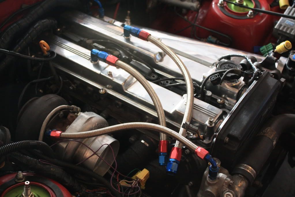

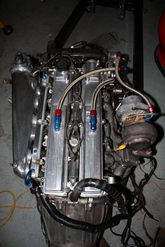

I've been thinking of how to do it. It didn't have it done before. How would you route it?
I know that I need to connect the throttle body port to the two existing lines on the cam covers. I was thinking of connecting those two lines to each other and tieing in another line from the TB. Not sure how to connect the AN line to the TB though. Or if it will look like complete ass.
63
Sorry for the delay in asnwering Jamie (took me this long to find the pic)
Here's how I did mine.
RED= Cam covers to catchcan
BLUE= CC to Turbo inlet
GREEN= CC to Intake on the plenum side of the TB
I use a real PCV Valve in the green line.
