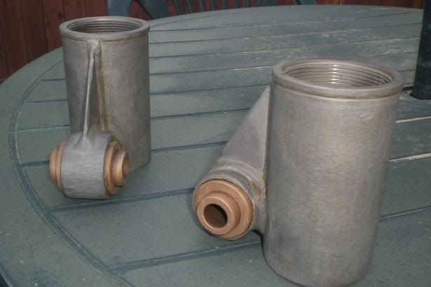

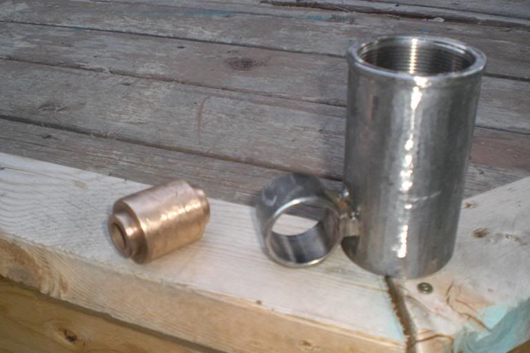

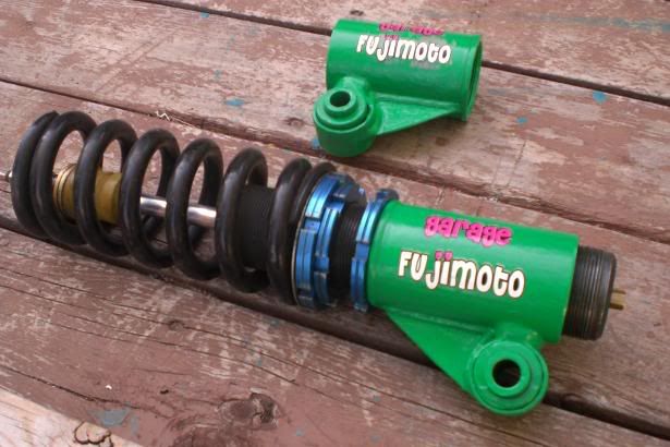

The Originals would never get short enough because when threading the main shock body towards the bottom, the shock casing bottomed out on the bottom of the bottom tube by the bottom bushing. The only way was to run a lot of slack on the spring bottom retaining rings, which in turn, bottomed out the shock stroke itself. This was only necessary because the bottom bushing was needless inches away from the bottom of the bottom shock bracket. That paragraph uses the word bottom 10 times. I prefer the word top, as in top notch awesome. See picture for clarity.
Testing
Mock-Up
Professionally Welded
Ready for Service

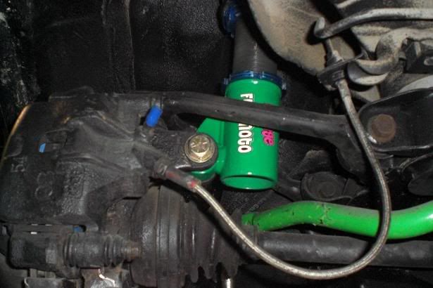

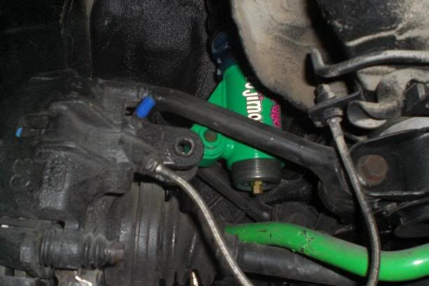

Can't bottom out now, there is no bottom :)

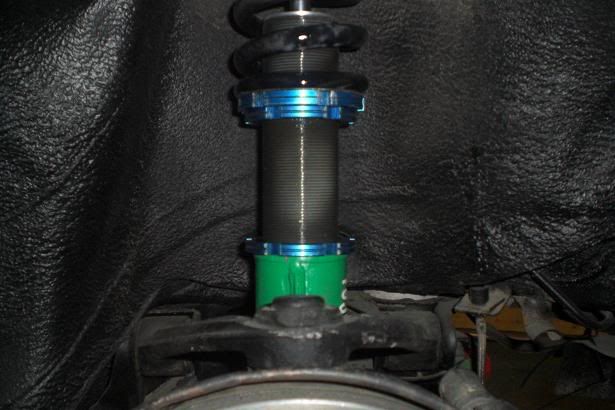

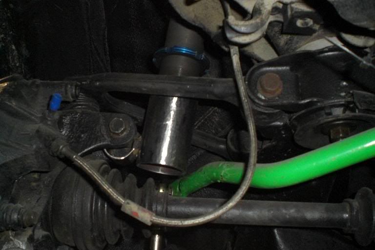

The blue rings on top and bottom were touching before. Can go way lower if desired but the frame would literally be on the earth. Still lots of room to go up.
Success!
This is how it hangs with no weight on it. Used to droop a few inches because the spring was so loose just to get the ride height to look "cool"
