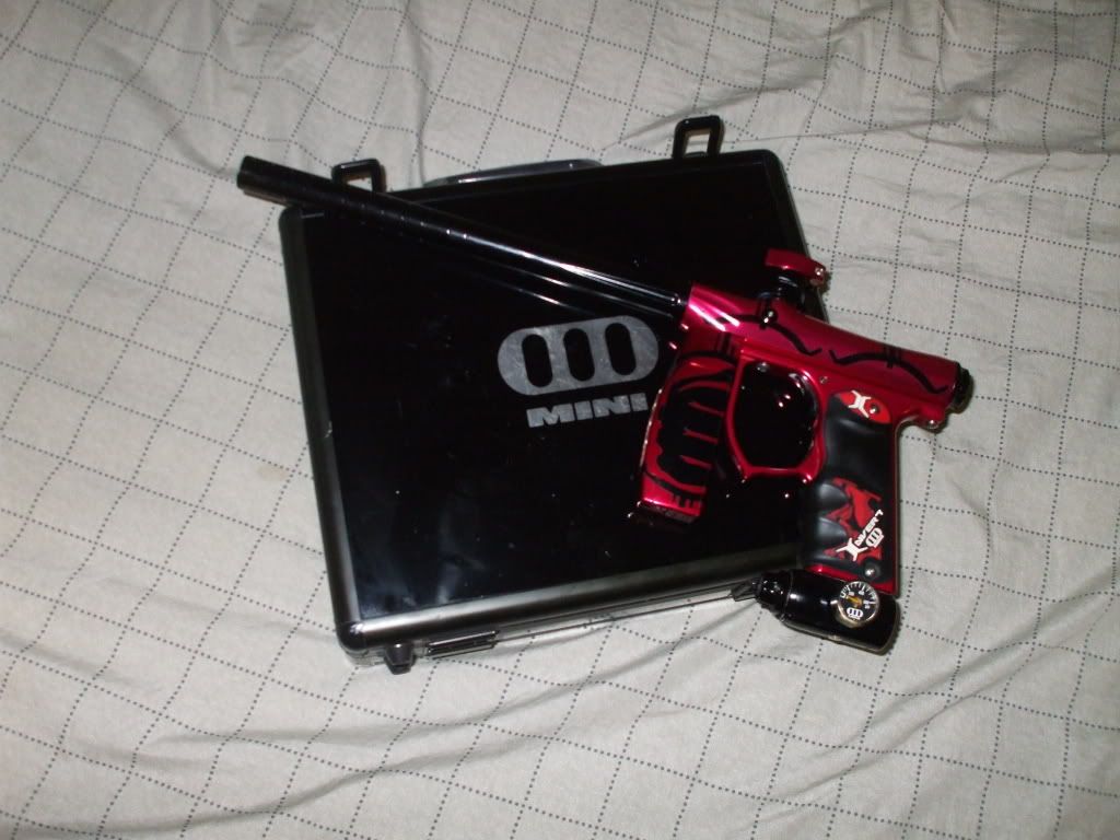

I woulda went for more of a glossy anno job...
A red anno like on my invert mini would be sweet
The reason why it isn't glossy is because you can't get a glossy finish on castings, and the reason why the tubes aren't glossy is because I bead blasted them first to give them a matte, velvet like appearance.
BTW I almost bought a mini a little while ago. I've been playing paintball for almost 15 years now.
