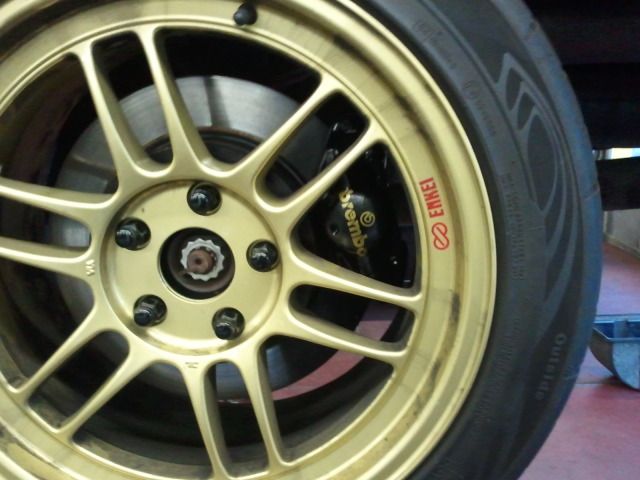

ok heres the run down on what I have. I have the azp 6 piston up front and evos in the rear. car stops great! Track test will come In 1 month as bhg and the an oil leak has kept me off the track all season. Now my car is an 88 abs car (turbo) and I have a w58 with no wheel speed sensor in trans. so my abs doesn't work ever!!! with that said I have no valves or tricks. just azp bp10 brake pads (thats what they come with) and stock evos in the rear. Stock evo brakes squeak when hot. It happens check evo M for more Info. I love my set up best 2k Iv ever spent. (or till i go to Vegas) pics below.

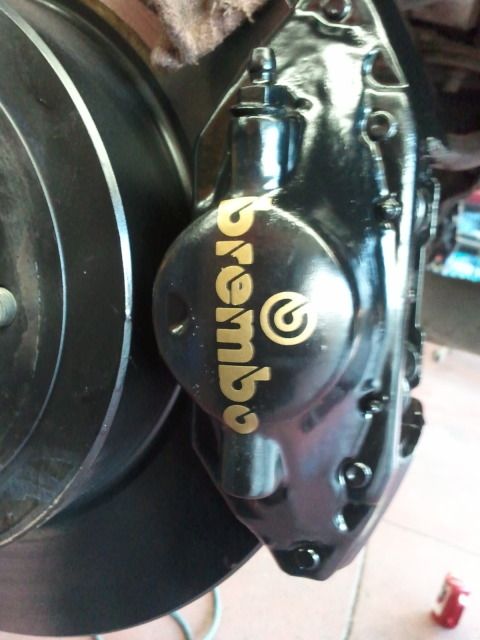

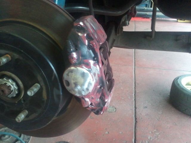

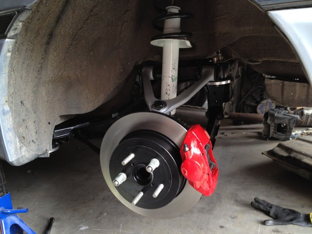

Well I got my brakes installed this weekend. The good news is when combined with my AZ Wilwoods the rears don't lock up before the fonts. The bad news is I flat spotted one of my front tires while bedding in the rears. The install was actually really easy. Everything just went together without any issues. Used my current supra Earls Stainless Steel lines. Does anybody know if the Discount Tire warranty covers flat spots? I paid the extra money for the damn protection so I would like to use it.
And now for some pictures:
Calipers painted black:
Stock Vs. STI Rotor:
Put together:
Installed:
