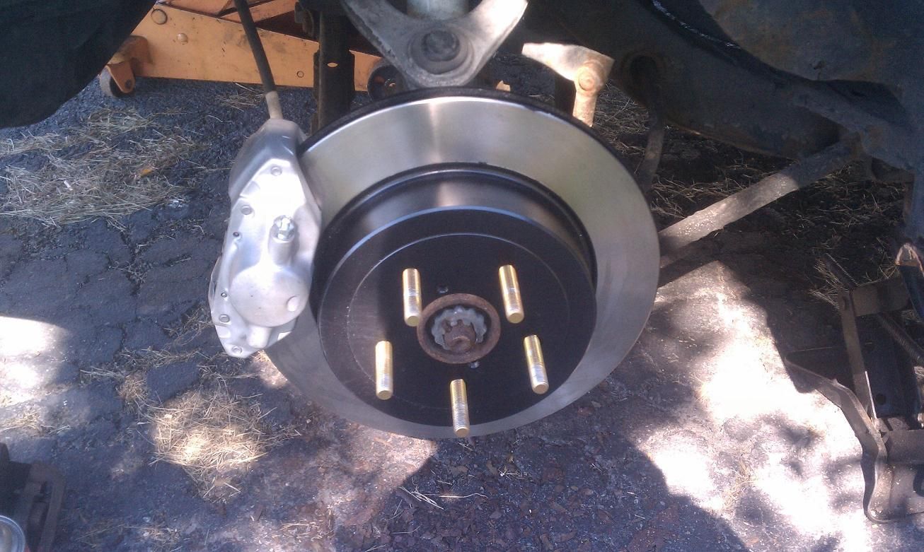

Ordered two rotors and calipers from rockauto (raybestos and centric) and had one of the rotors bored out (the other one had a drum in the box instead of a rotor ffs).
Rotor won't fit all the way ont the hub face. Do I have to remove the dust shield in its entirety or just bend the outer edges back? Looks like the very inside of the rotor (where the e-brake pads are) is hitting something.
edit: Post #118 has it, have to cut the outer lip of the center part of the dust shield. Urgh, too hot to do this today.

They are plug and play. Ebrake stuff works but its real tight, I have to loosen up the drivers side stuff. Only thing I had to do was bend back the dust shield.
