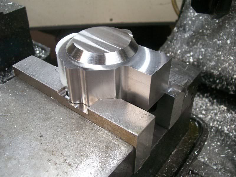

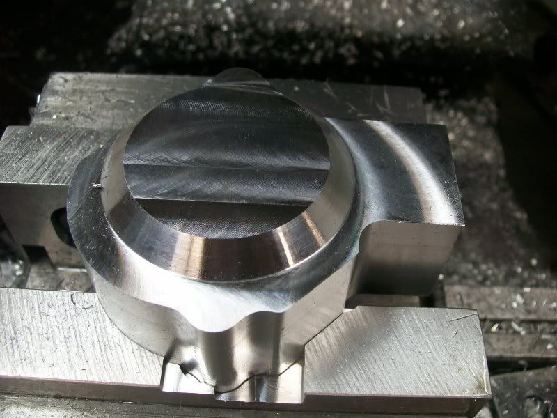

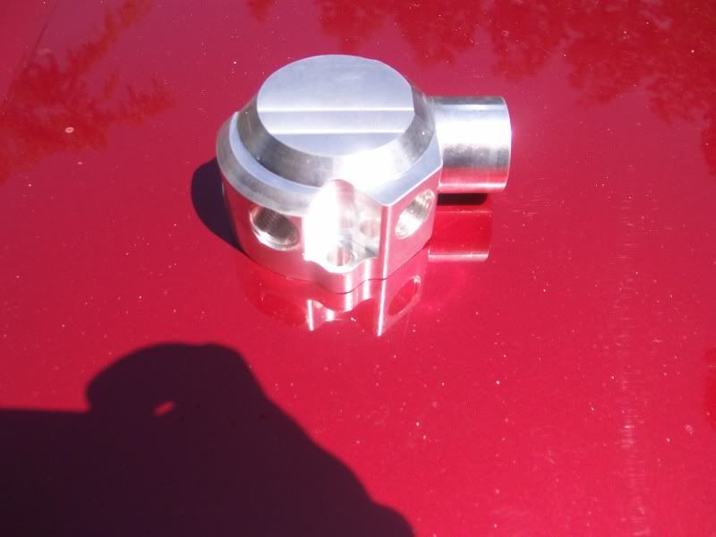

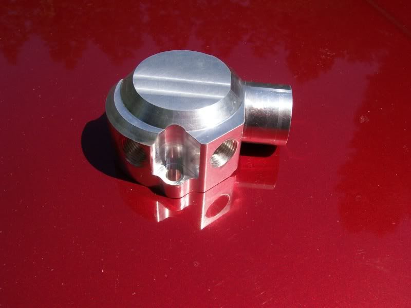

i ended up doing the prototype in a prototrak today.
it'll be done tomarrow!
4U2QUIK
1UZFE SWAP DUDE!!!

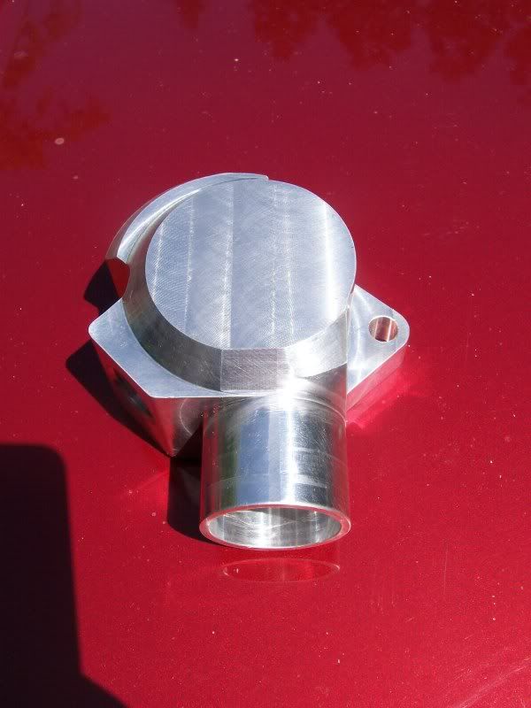

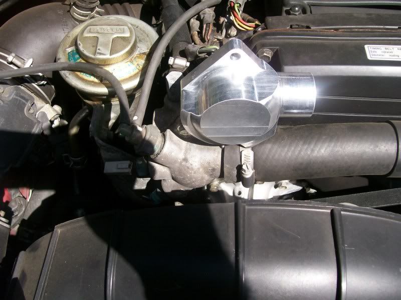

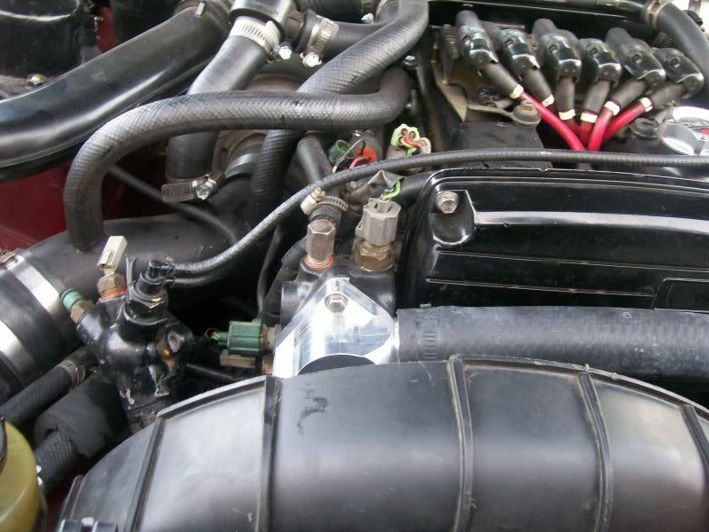

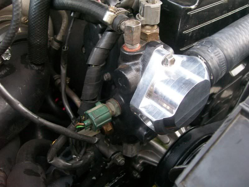

:aigo:FINALLY, IT'S DONE!:aigo:

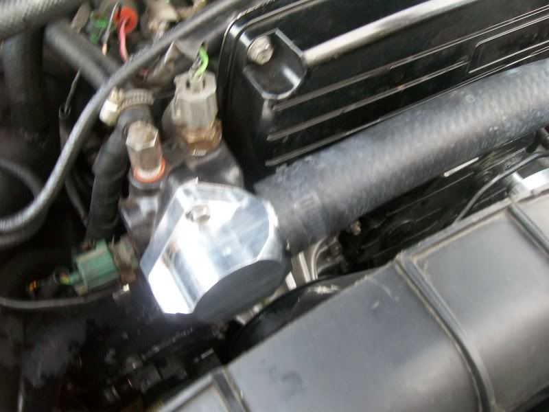

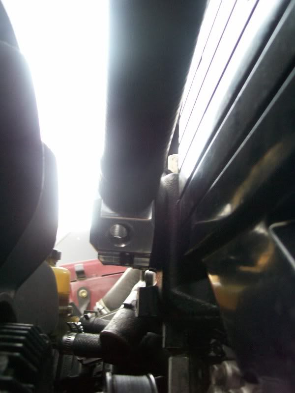

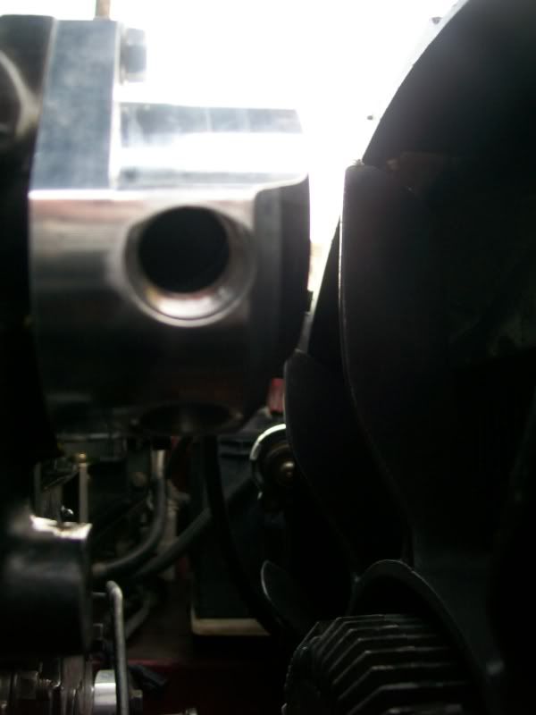

I'll be test fitting it later when my car cools down.
also, I didn't put the barb on this one because I plan on making mine a -an fitting later on.
I did the prototype on a retrofitted bridgeport style machine so the finish isn't nearly as good as it would be if I did it in the cnc's. But all of the cnc machines had jobs setup in them so I couldn't use them for this.
4U2QUIK
1UZFE SWAP DUDE!!!

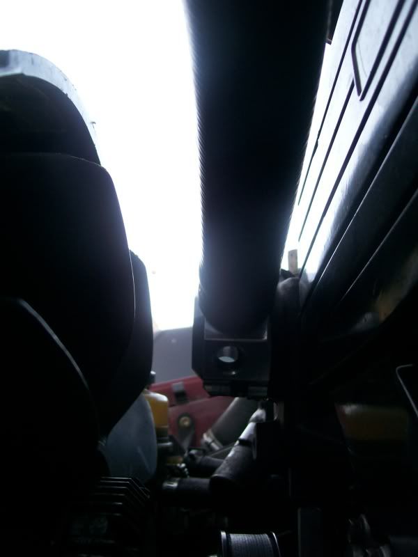

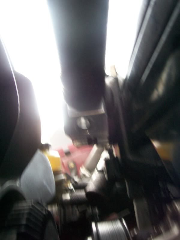

it's already 1/4 of an inch furthur out than the stock outlet. I'm hoping this will be enough to clear the timing cover for removal. Plus if I moved it up it would cause some blending issues that would require more machining time to clean up. The way it is, it's a very simplw part to machine. Also, I left .1 extra material on the top for some engraving experimenting.
